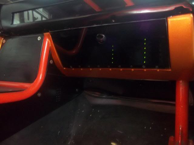

i just figured out a slick way to do LED lighting for the drawers when they are open at night.... obviously the big uppers will light it up, but i like the idea of not having to have those on while finding stuff in there at night...

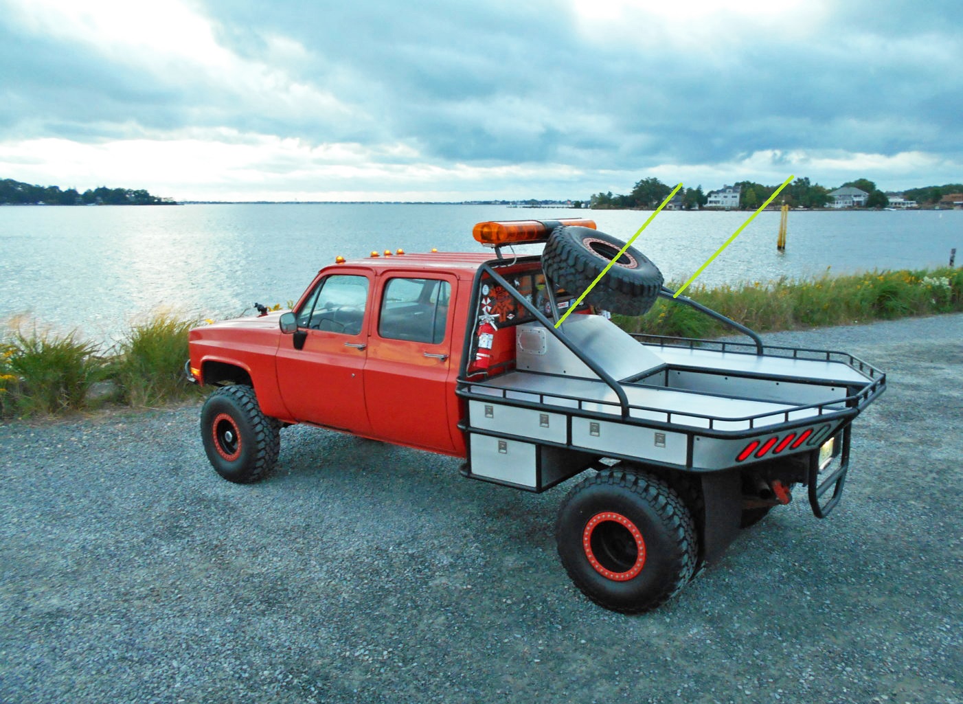

I'm thinking about setting up a couple flag mounts on the tubebed for certain occasions... angled back, like this....
full
does anyone know a good tube clamp style one? quality, or I don't want it.. otherwise, I'm thinking I might add a short, maybe 3", 4" tube, welded into the V of that joint... that way it wouldn't be overly noticeable when not using them... than some sort of setscrew setup...
anyone have a material suggestion for the actual flag pole material? maybe some 1" alum tube of some thickness?
thinking a regular flag and maybe a red GMC one on the other side...

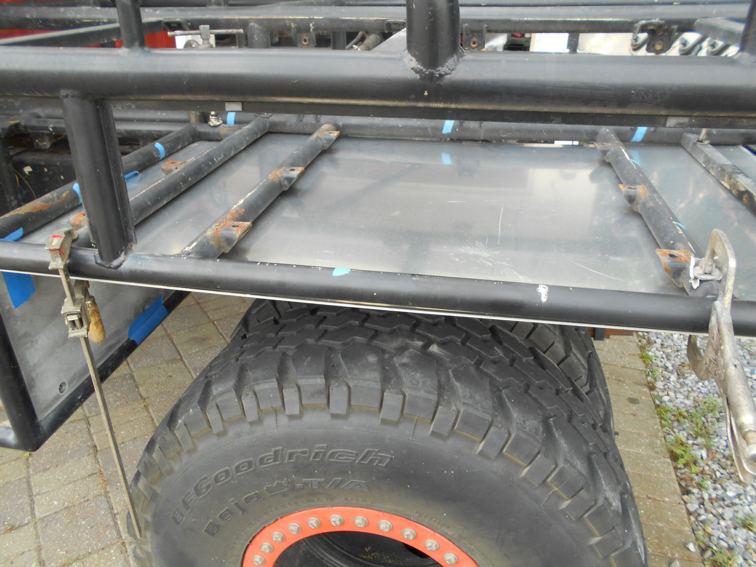

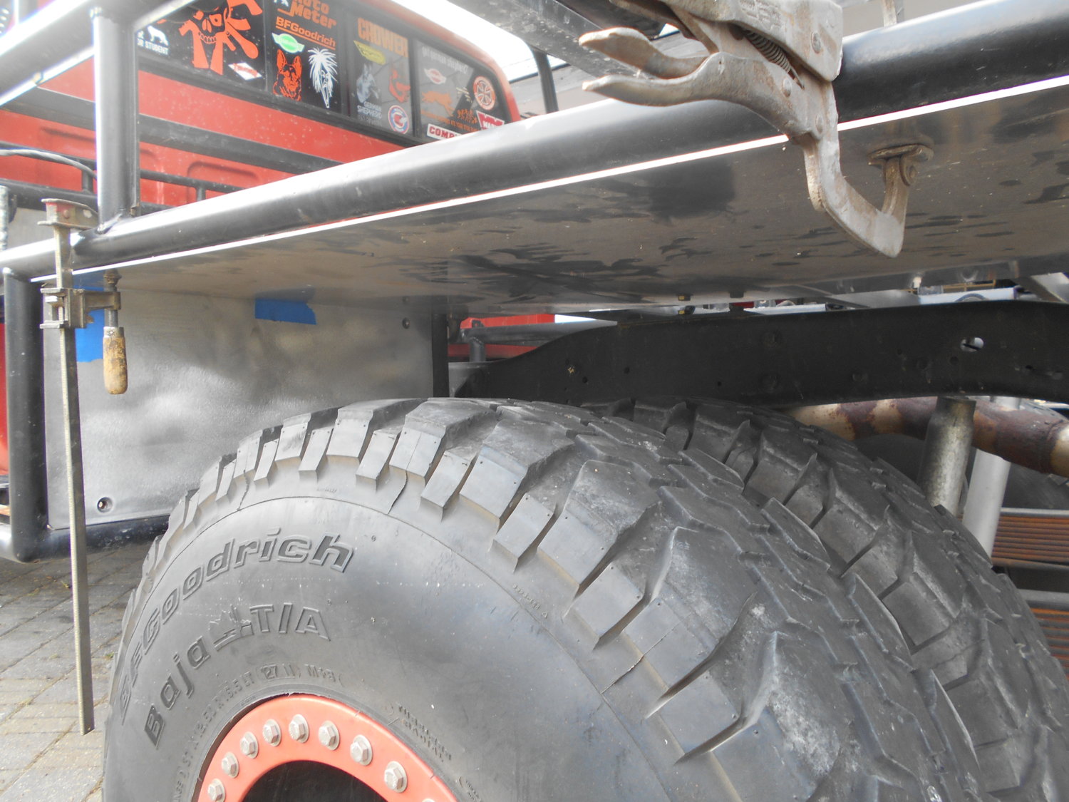

#2 - I've got a pretty cool plan for bellys.. there will actually be 4 in the end... 2 main rectangles over the tires, behind the boxes.. than small triangular pieces behind the mudflap back to the lights... I was originally thinking I may do it as one giant panel with a new mudflap attachment added to it.... but I like the idea of a quickly removed panel in the back for wiring... tho the lights all do come out easily from outside the rig too...
I've started toiling away some weeknight hr's trying to get to the alum wetsand marathon nightmare done... the weekend fab work is getting me :saweet: :saweet: :saweet: :saweet: :saweet: enough, to get the panels done...... prolly another 20 hr's of sanding, than Sharkhiding will prolly be 20 hr's over the course of a week or so... than overcoating the tube is a weekend.. and reinstalling panels is a weekend.. I'm hoping I've got the CC's down enough by aug that i can live with myself dumping $1500 to 2 g's I figure, on the tank, pump, yada....... I desperately want to get that stock tank out and get to that ps box fab.. not to mention going 18 gal to like 65 gals..
i'm taking all day sat/sun to work on the rig, hopefully the first belly pan fab will done.... i really have massive labor to throw at the rig over the summer.. i REALLY want to have the entire ds belly setup done... ya know, proof of concept, and all... ;)
and maybe even getting to the back one on the ps too... if i'm trying to get an overcoat of black on it, i want to get as many panel tabs in as i can... that also includes to 2 addtional per side i wanted to do on the taillinght panels on original install.. stiffen that sh*t up a bit for them dar prius'ass..... :pimp:
