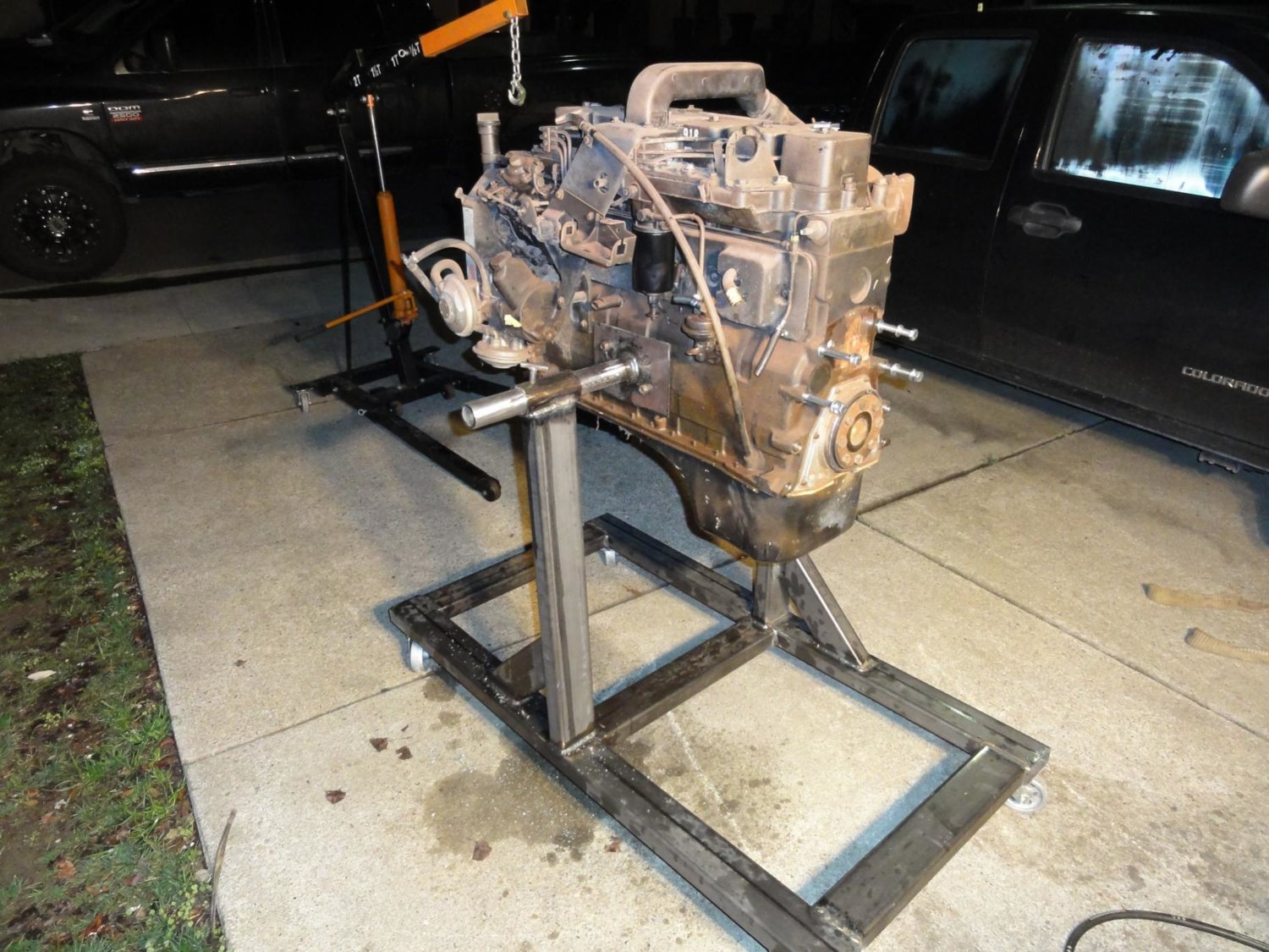

steels in the LAB™.......... I'm doing basically the same as the one i pictured..... to the mounts... want the back open for mocking up the bellhousing, flywheel, etc...
and being this thing is gonna be kicking around the shop for a yr or 2, it's going on a stand... :whistle: decided Gregs killa casters are just too tall for this project, decided to save them for redoing the K5 cart... bought shorter ones...
only sucky part is I don't have any 1.75" DOM left kicking around for the pivots, so I ordered a 3' hunk from Kert....
I'm going with just a pin locking setup...
oh, and I wasn't even gonna make it spin.. was gonna do the block mounts from square tube, like my fab table legs.... but I didn't have any of that stuff left.. so i said screw it, make it spin... and it'll just be drilled and pinned for 2 position... I'll have to use the hoist obviously to roll it over.. but I'll only be doing that for the oil pan... i would have been willing to do that upside down easy enough (i do it in the boats all the time), but said screw it, the tube in tube setup works so nice, and it'll be nice to do the pan with gravity on my side for a change.. ;)
all told, I'll have about $150 in materials in it and a days work... gonna go down and cut up the 2 x 4 x 3/16 for the lower frame now... try to get ahead a little bit....
