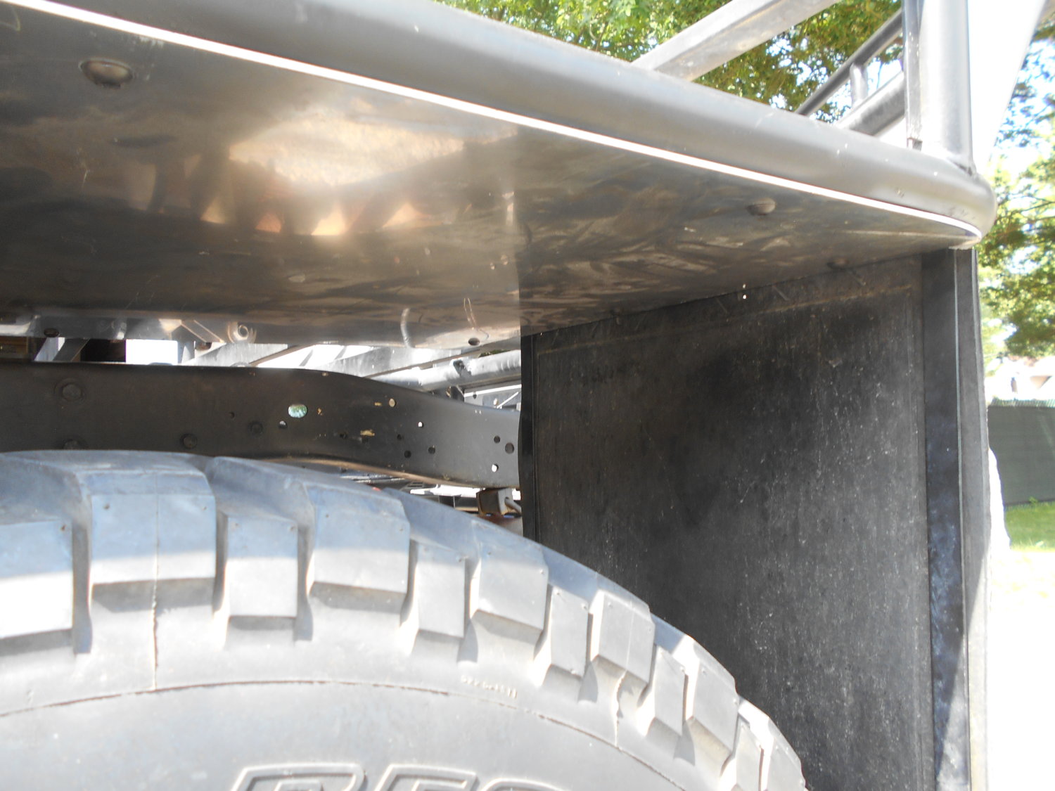

working on the mounts over the next couple days.. got mom help tue/wed to do... decided to do the "ceiling" like the bellypan... 1/8" flush mount with the black button heads.. the button heads will help with wire retention, moreso than 1/4 with countersinks...

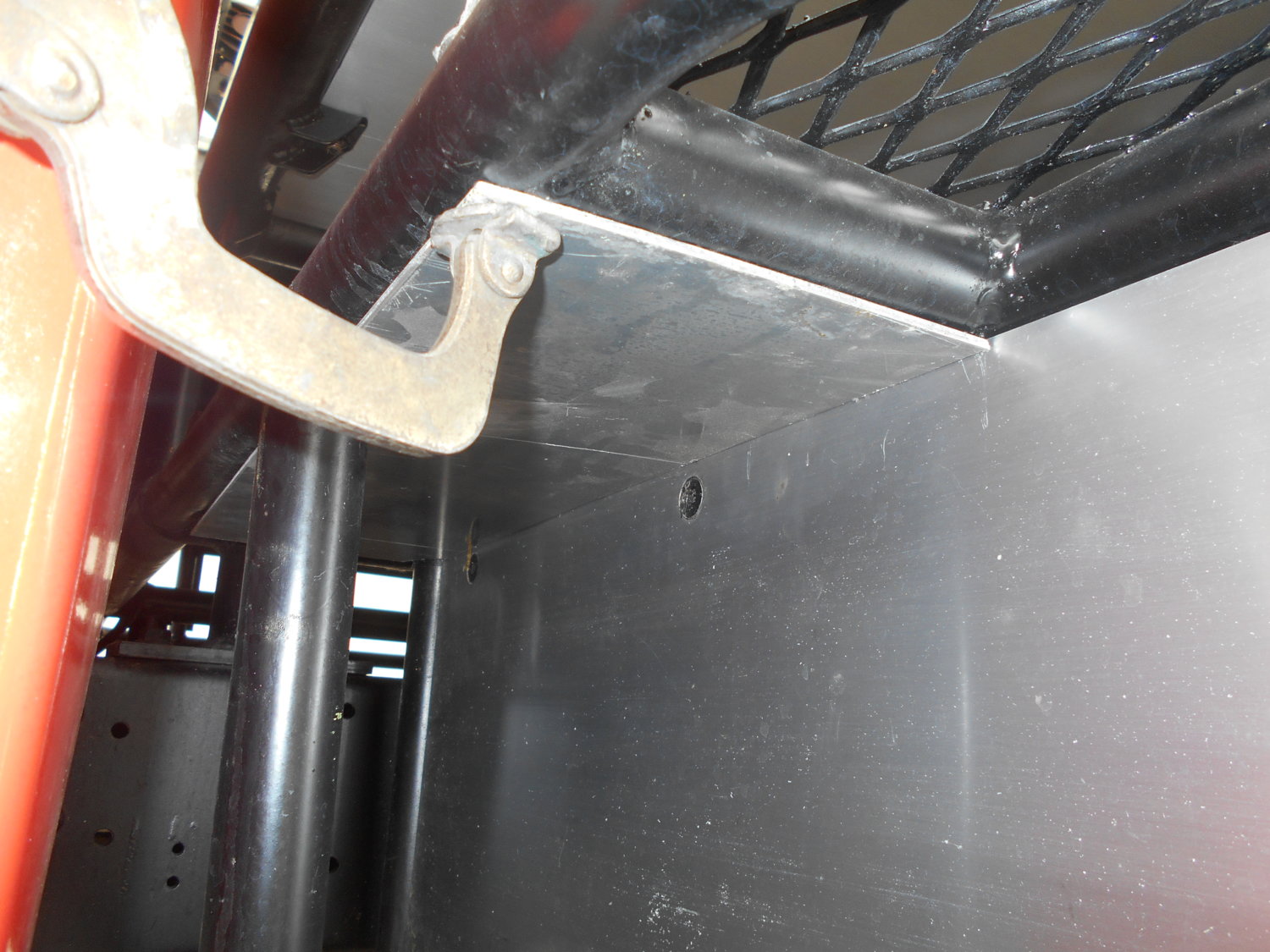

now comes the not so sexay, unseen stuff of 2 more ceiling panels... but they need to be done, and now's the time to do em before the weather gets toooo stoooopid...

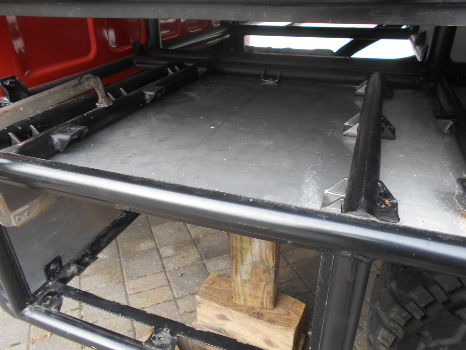

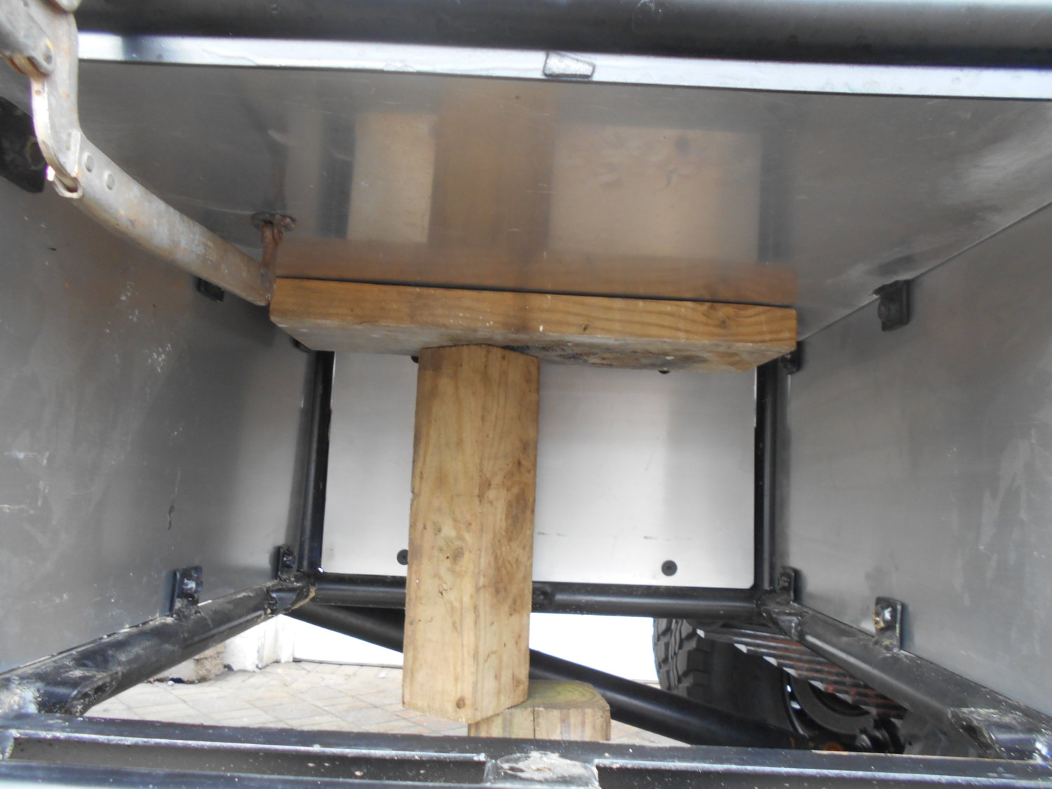

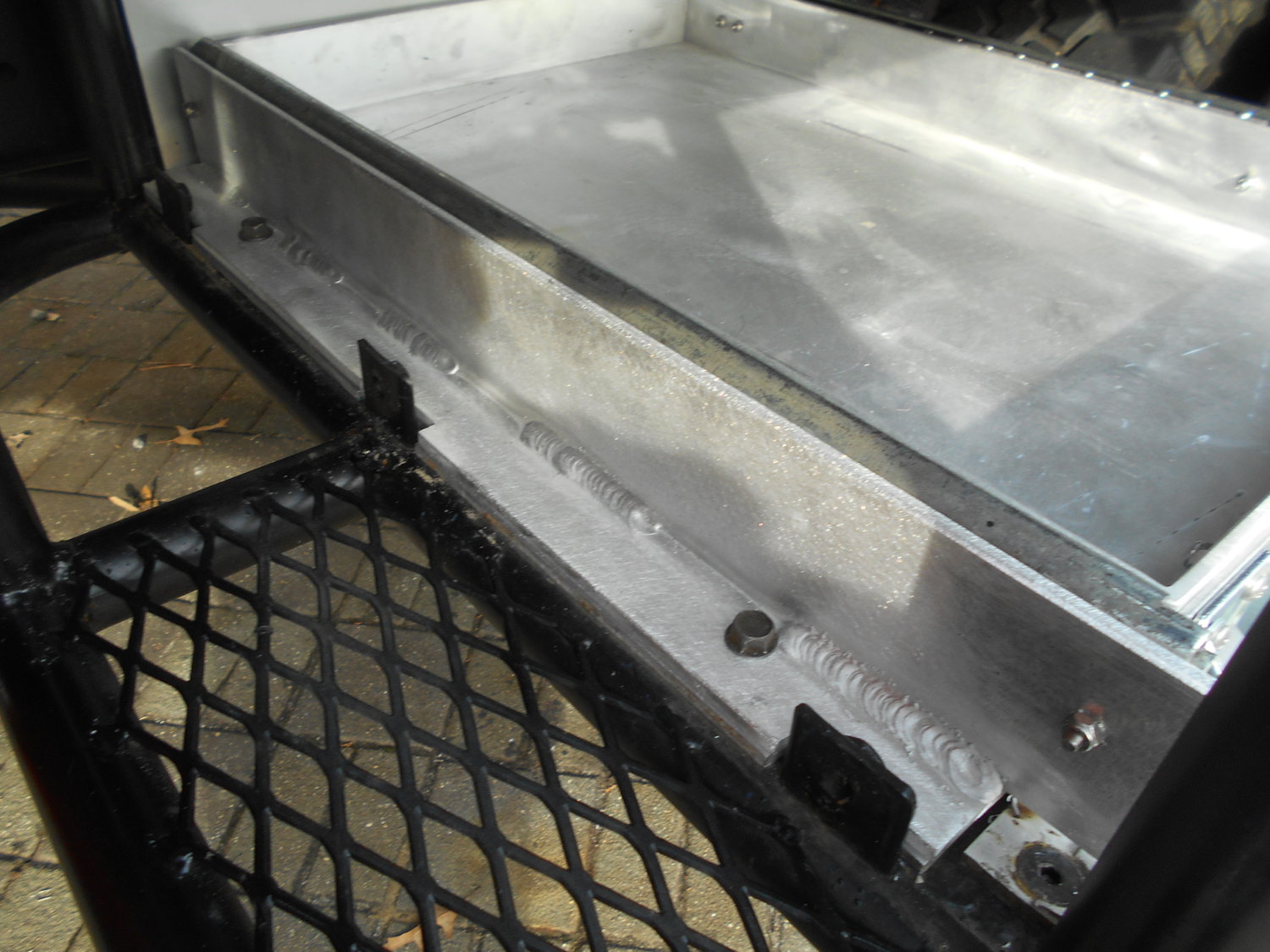

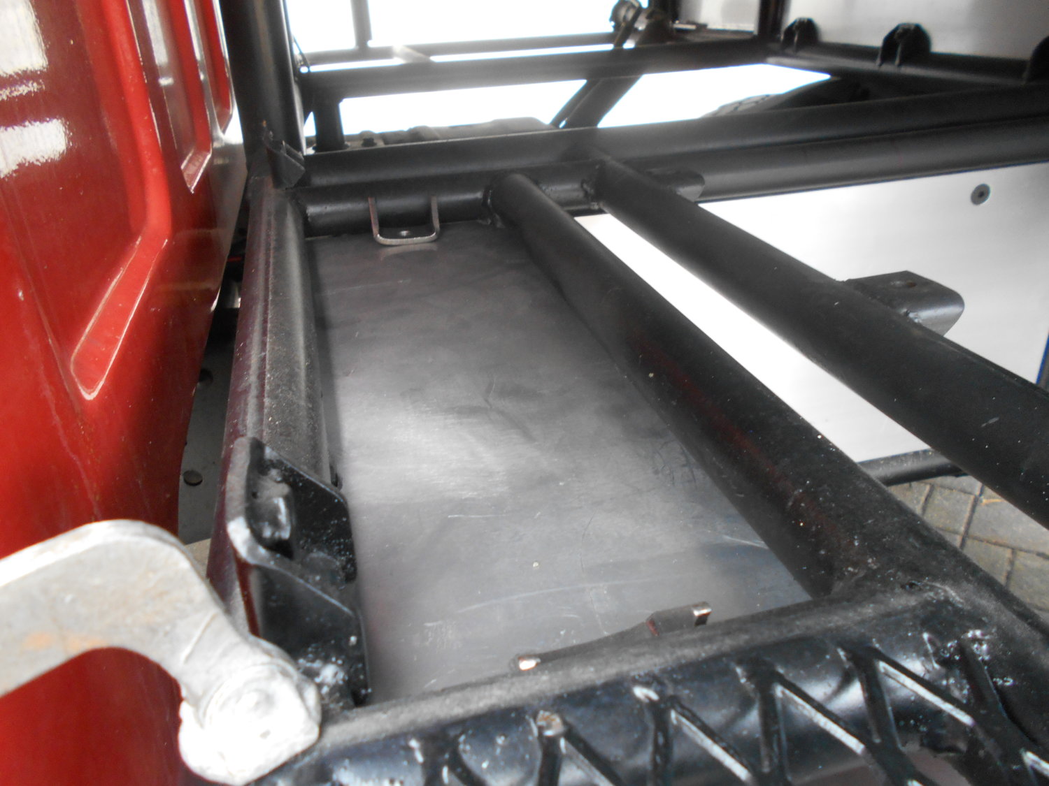

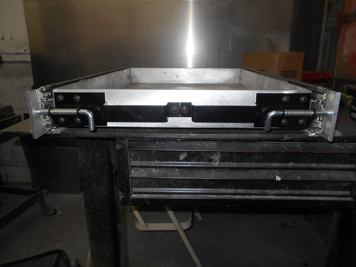

here's how the brackets worked out...
full
you cannot install the whole tray with the box assembled thru the door... I have to have one bracket, and that sidewall off for R/R of the unit... but I think it was as simple and efficient a project as I could do...
full

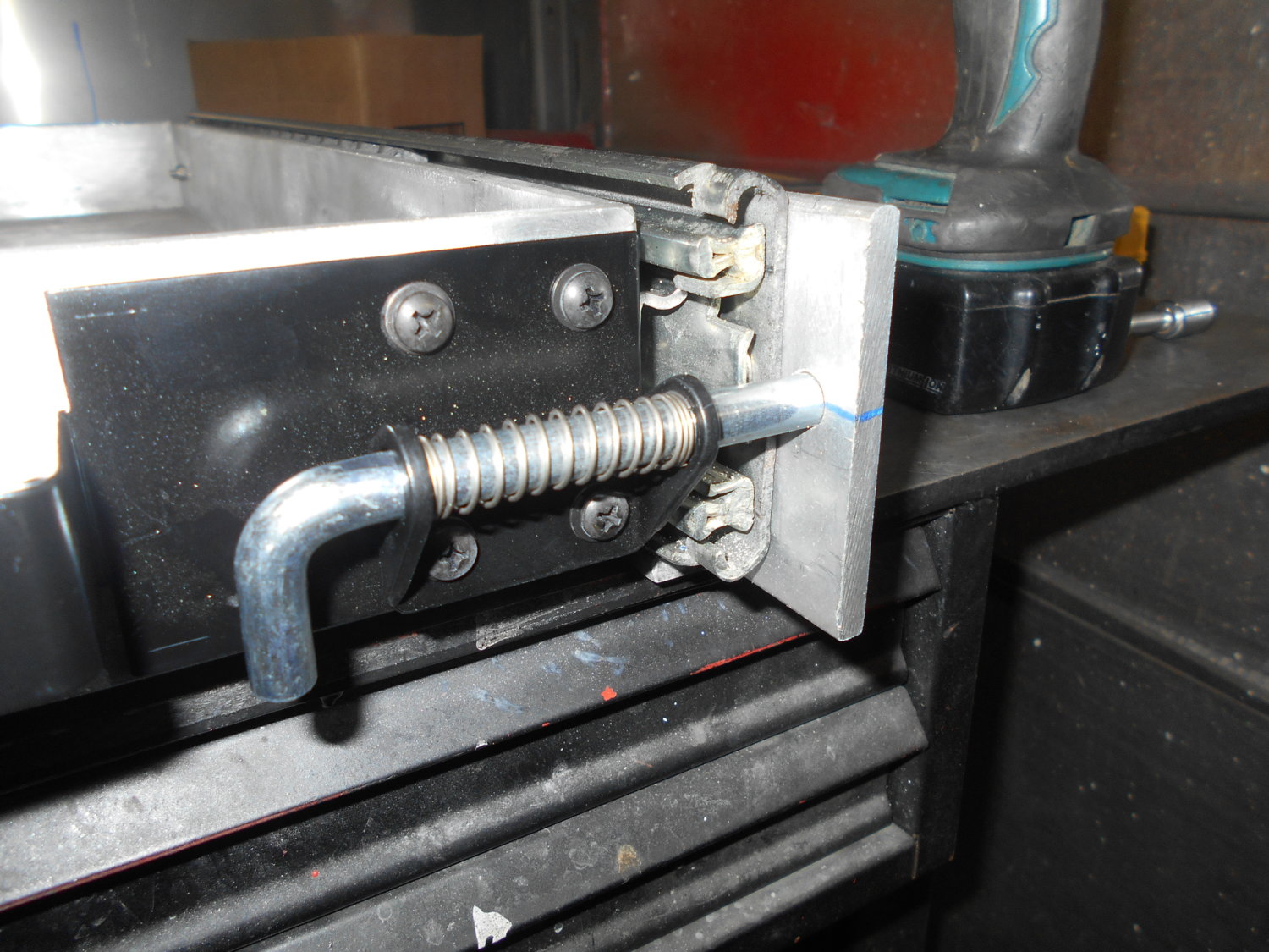

still need to drill the other 2 mounting holes for the drawer on the side..

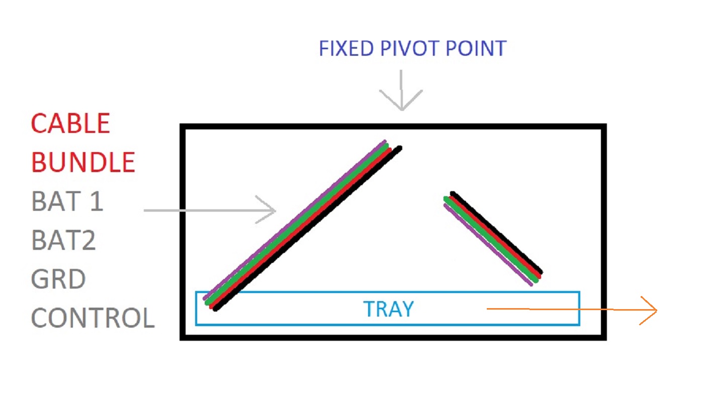

You just going to run some flexible welding cable from the batteries to the box or wherever so that it can move with the batteries going in and out?
I'll end up running tinned marine stuff.... better wire bundle, just a bit thicker jacket... still working out all my cable fastening hardware and such for the ceiling and tray... need to get into the marina this week and figure out what this is all gonna cost...
