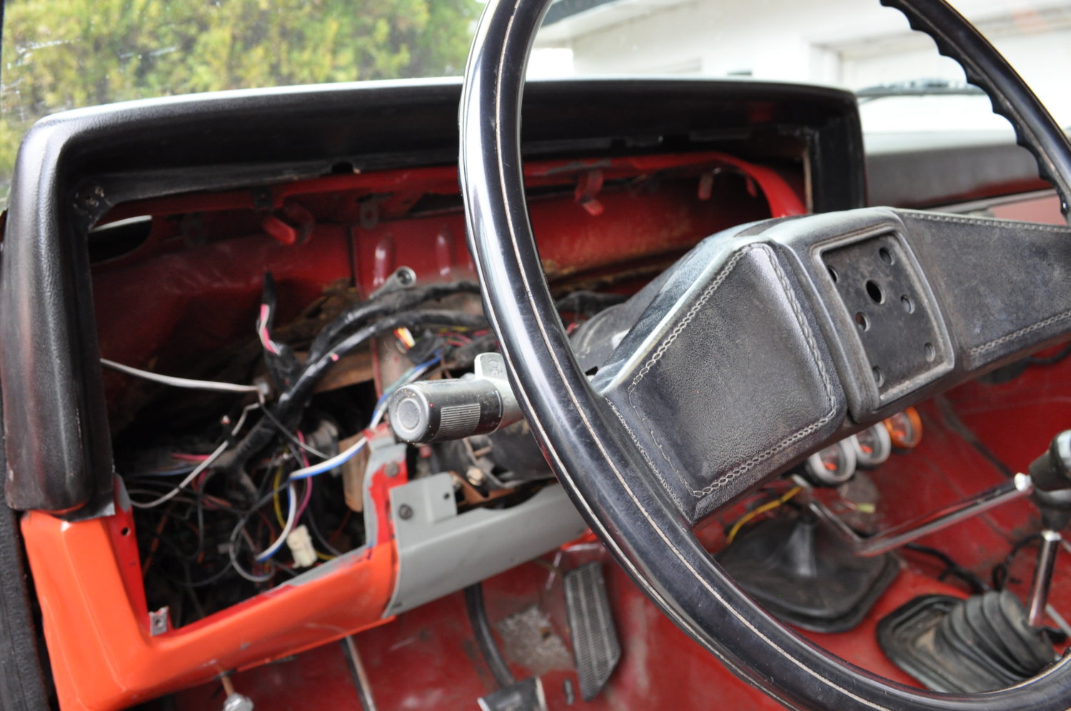

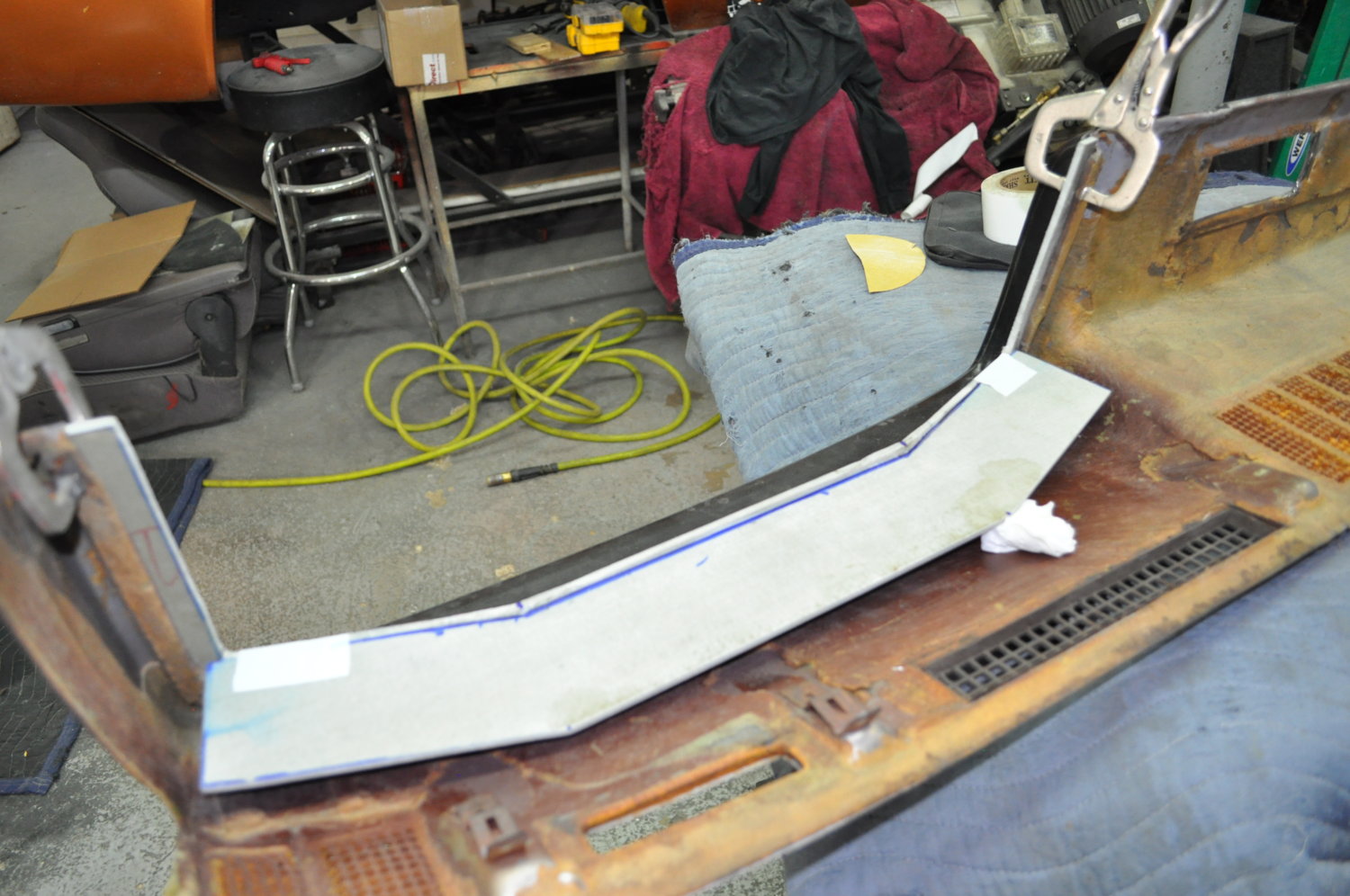

so, I'm bouncing around on a few different projects right now.. the bezel, the switch panel to the right, welding the dash up, etc...
as for the bezel.. correction, it'll be 15 pieces... ;)

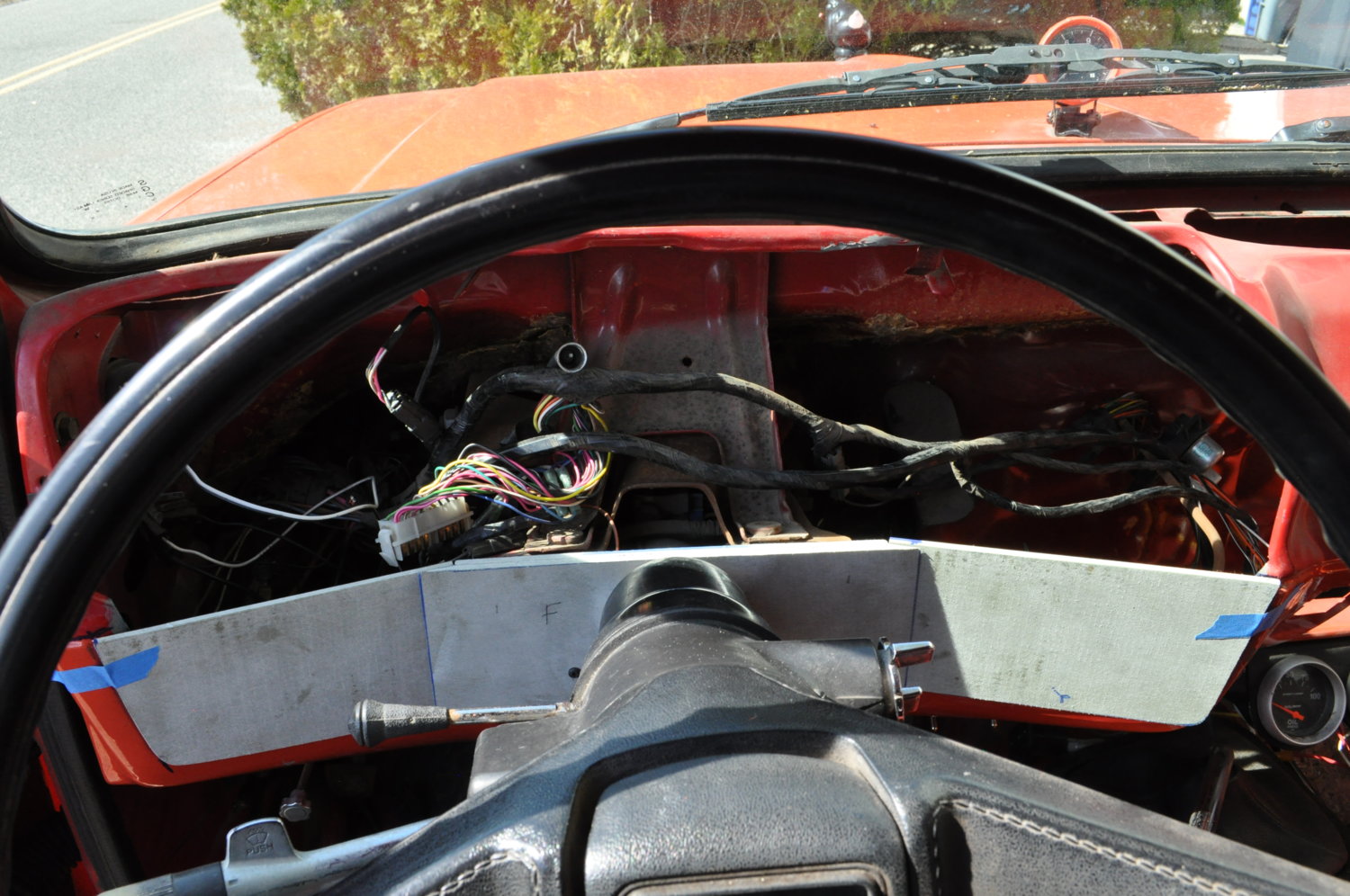

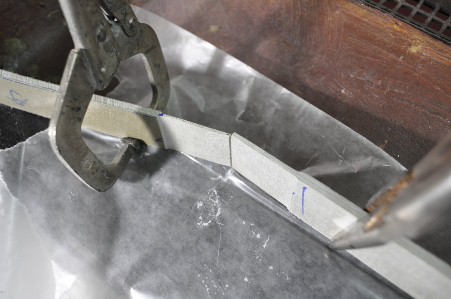

there were a few things in the original bezel that I wasn't particularly happy with, mainly in mounting, and some angles..
while the 4 corner holes really can't be changed and are vital, I changed the 2 mounting locations by the column.. i also doubled up the center section and recessed for the column screws in the back one for a much more stable platform... this will all get lammed together first with thickened resin.. than it will be ground and tabbed on both sides...

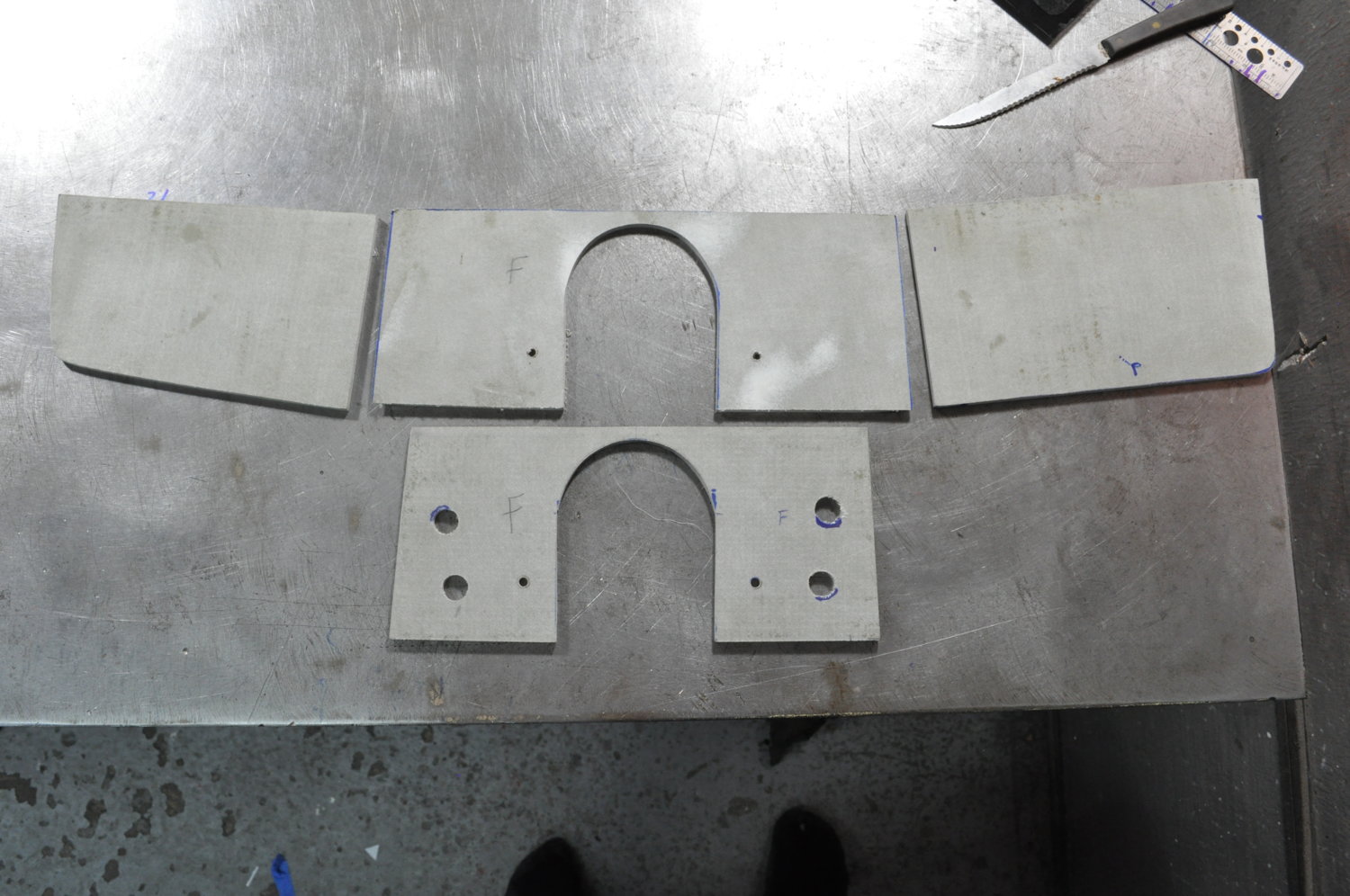

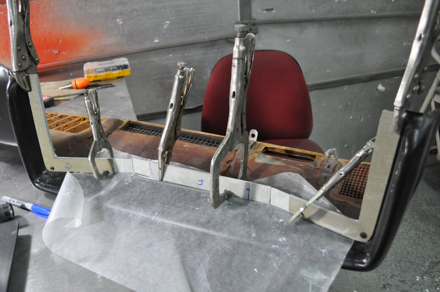

basically I'll be building the dash in 2 pieces.. that lower section, than the top...
here's the first 3 pieces for the top 1/2...
full
full
tomorrow I do the first glass work...

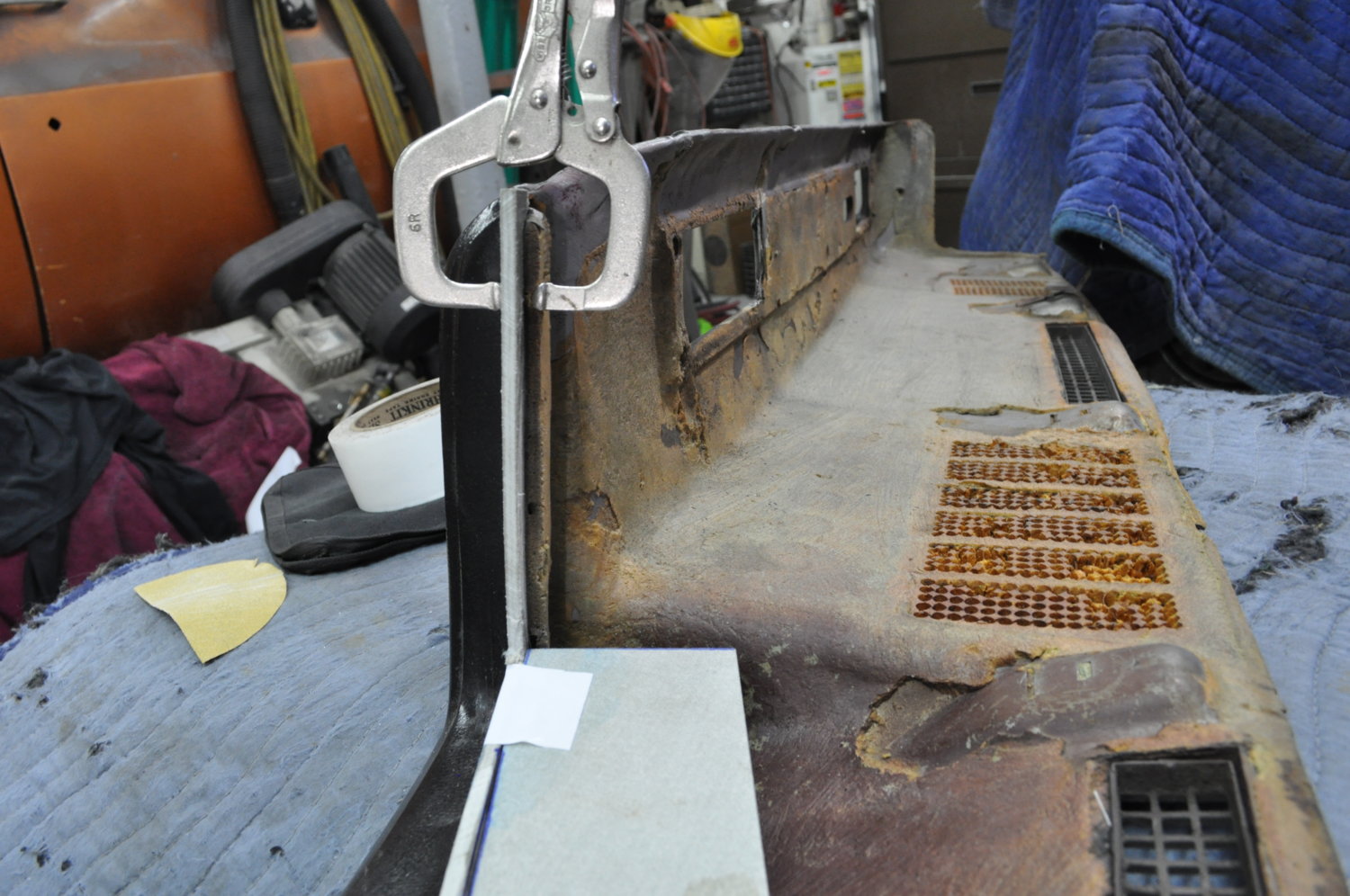

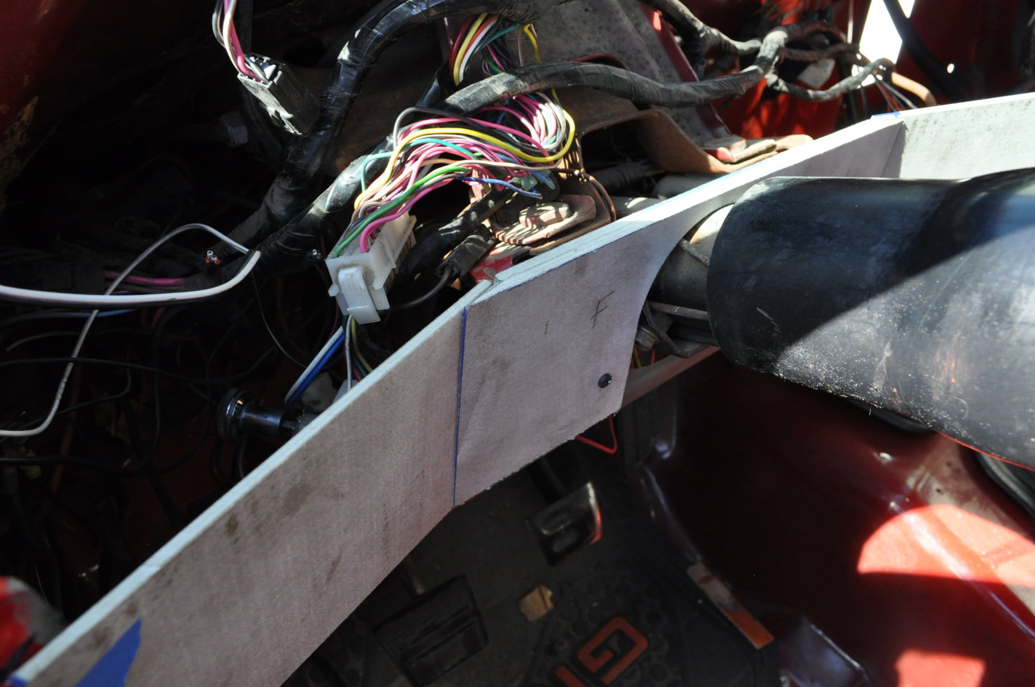

I'm hoping to have a bit more room around the gauges this time... sh*t's tight tho with the 2 5/8"........ but it will have a bit more angle correction.. deeper.. it will be more perpindicular to the column...
full
here's the next piece of the puzzle.......
full

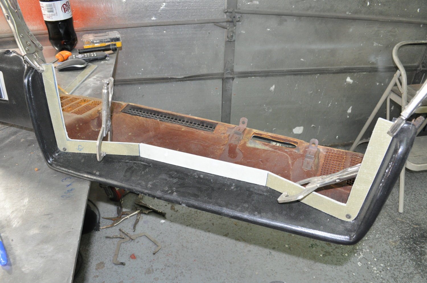

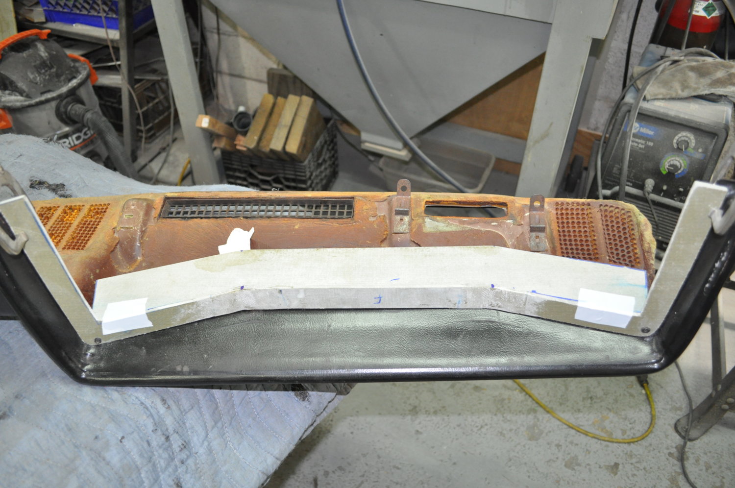

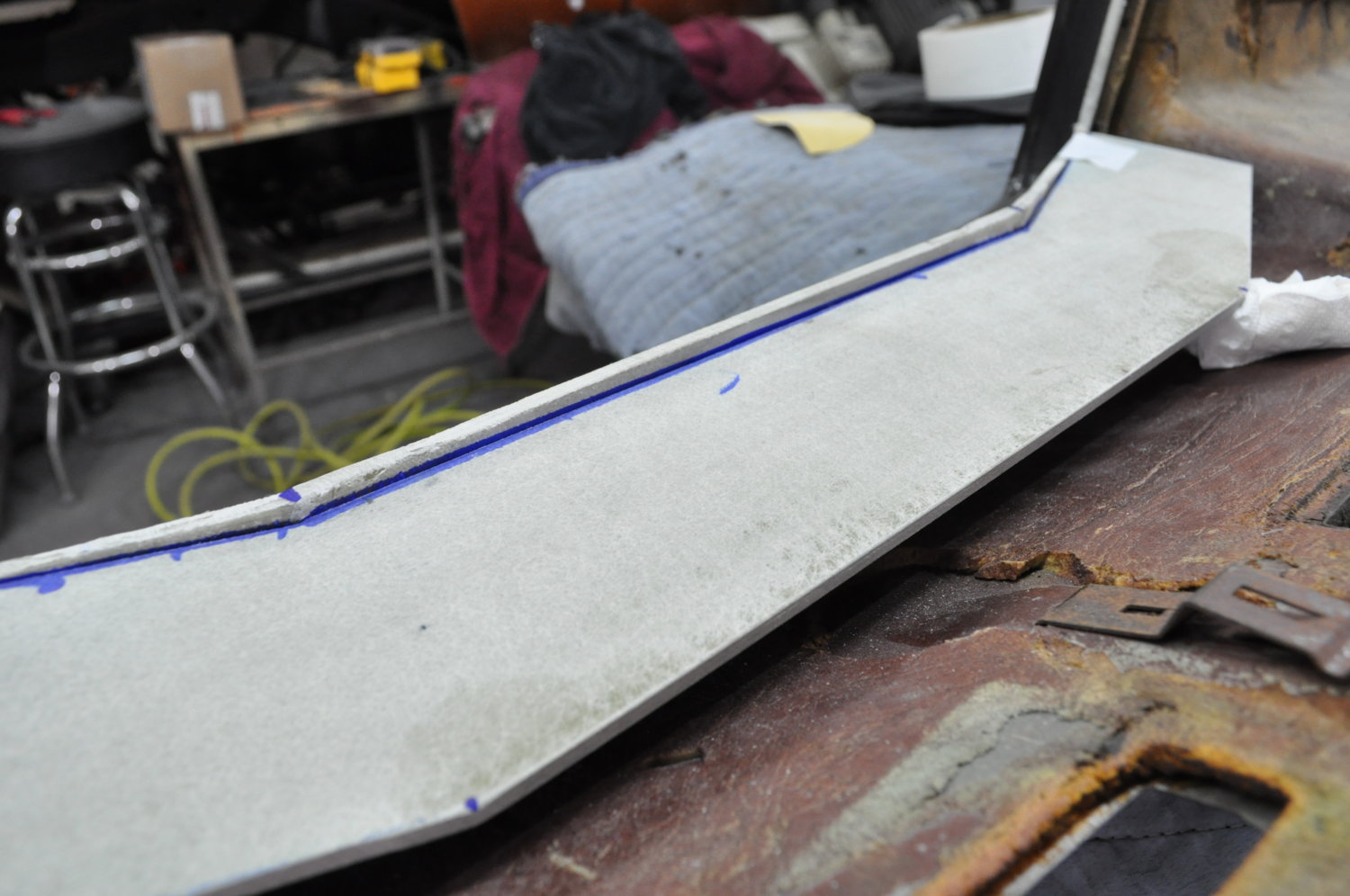

next will be the 2 end triangle pieces....
full

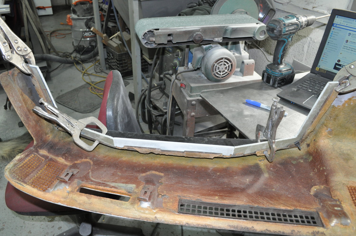

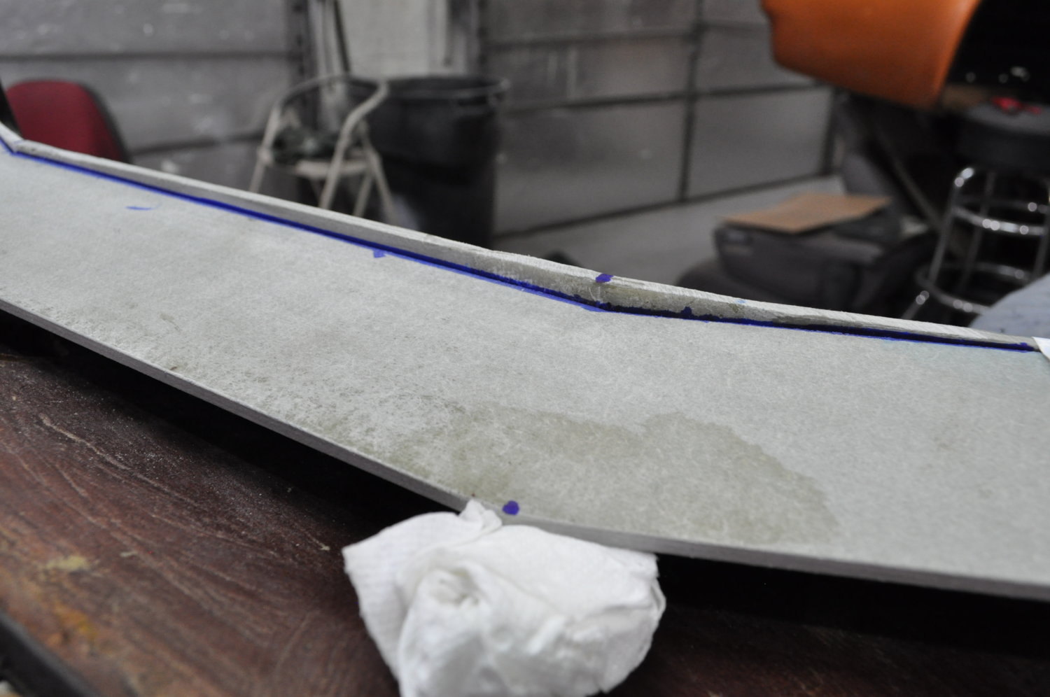

setting that 90* corner angle with the high tech paper towel adjustment method.... ;)
full
you can see it's sharpied at the point I need to trim the front facia down to....
full
full
the corners are literally right next to the screw clips...

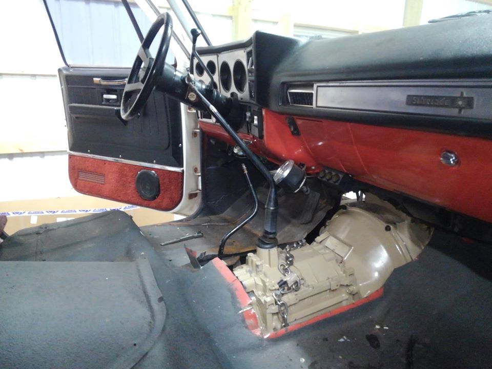

for people who have the 5.9 swap, does the NV4500 shifter get moved back at all from the 465? where it comes thru the floor? :ears:
full
