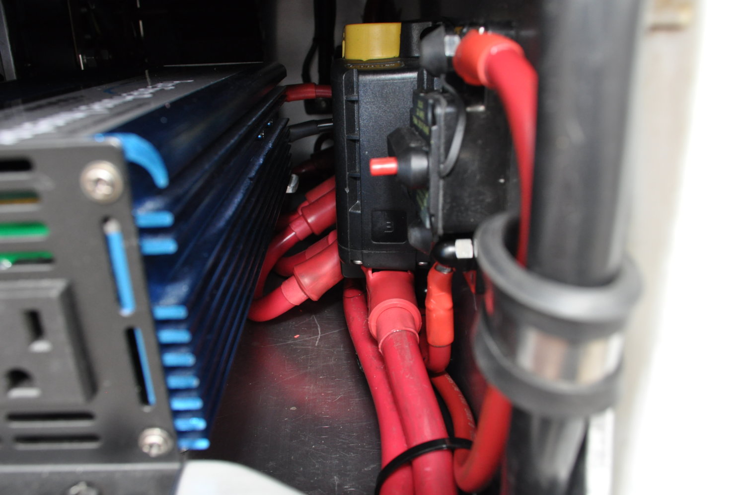

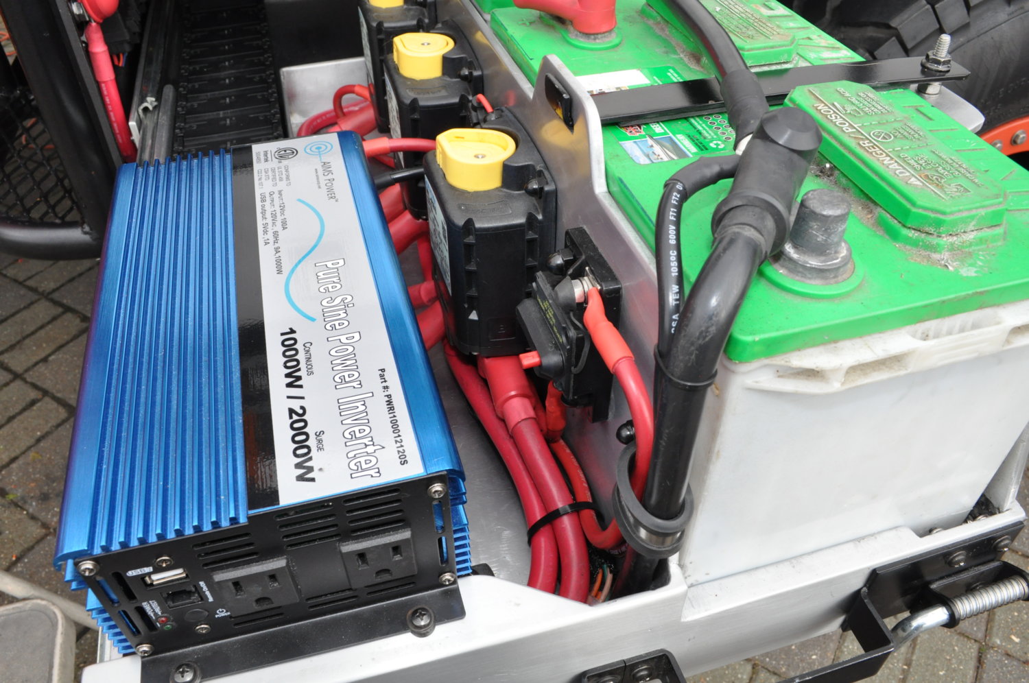

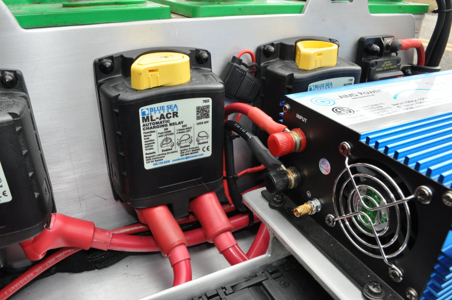

did the trigger bundle today before it rained... just need to do the inverter wires to button up the tray... started running the 2 harness's to the front...

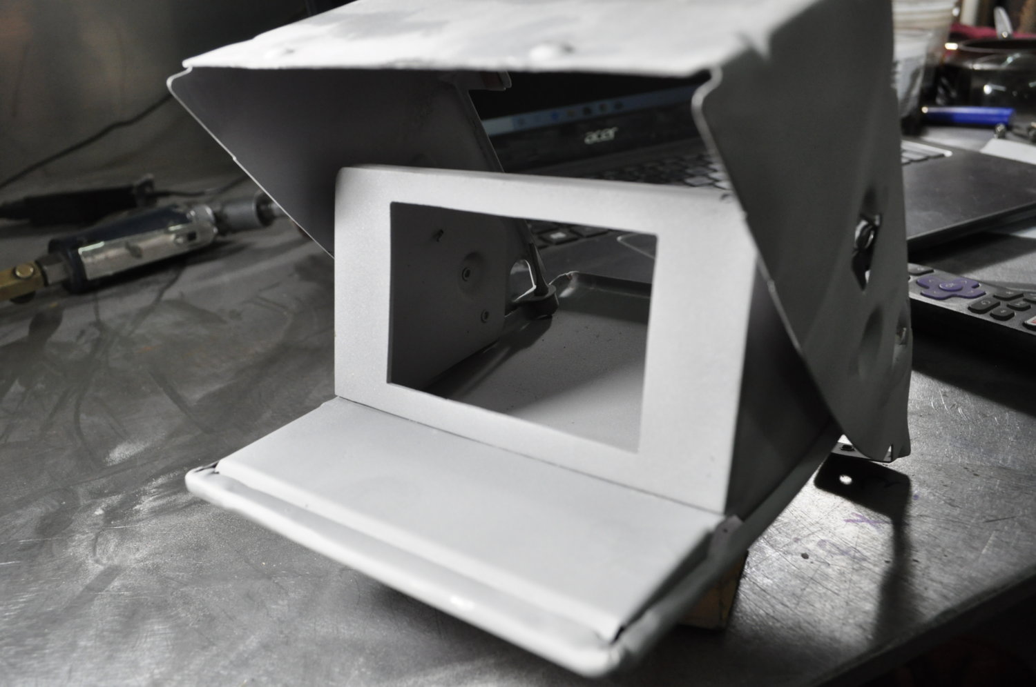

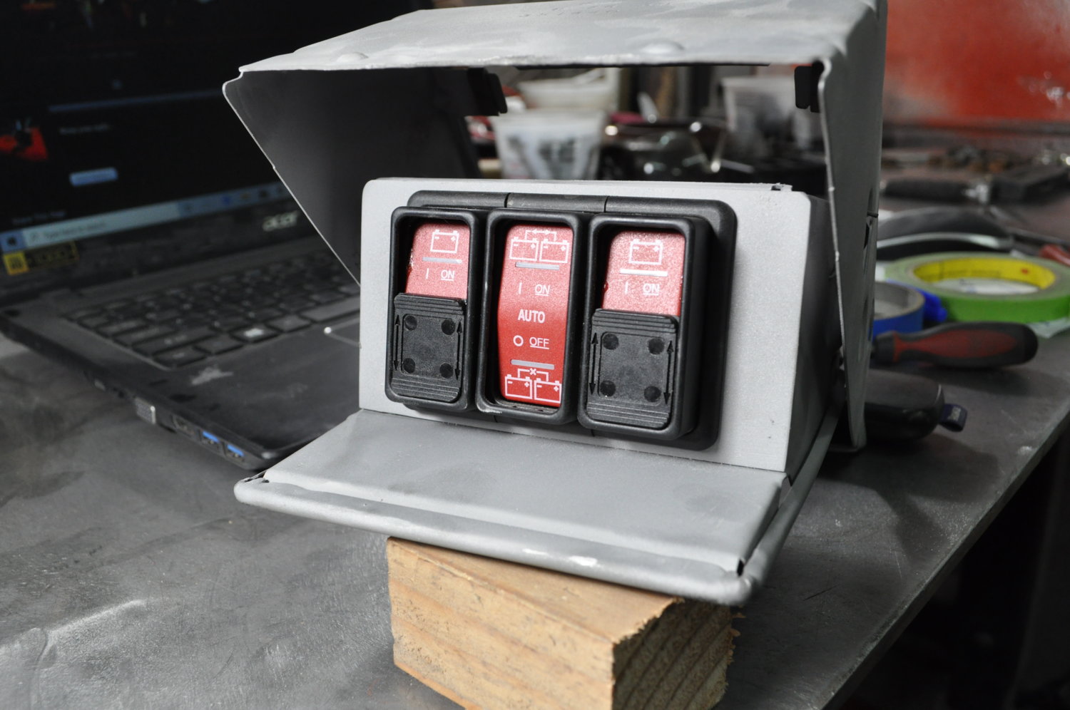

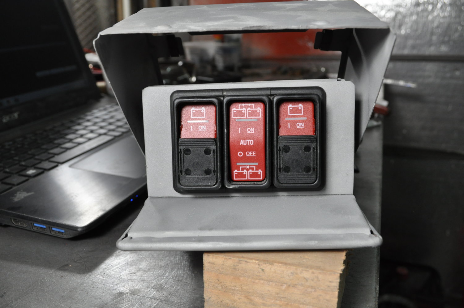

I'm currently building a custom 3 switch setup in the ashtray for the bat/ACR Conturas.. just to have em outta sight..

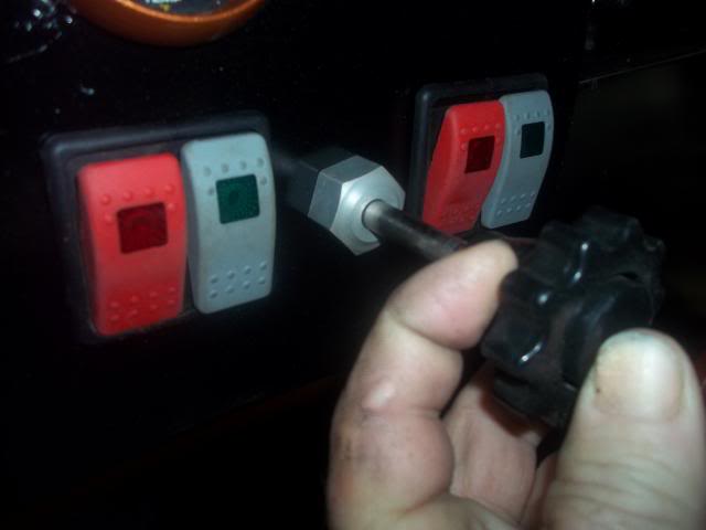

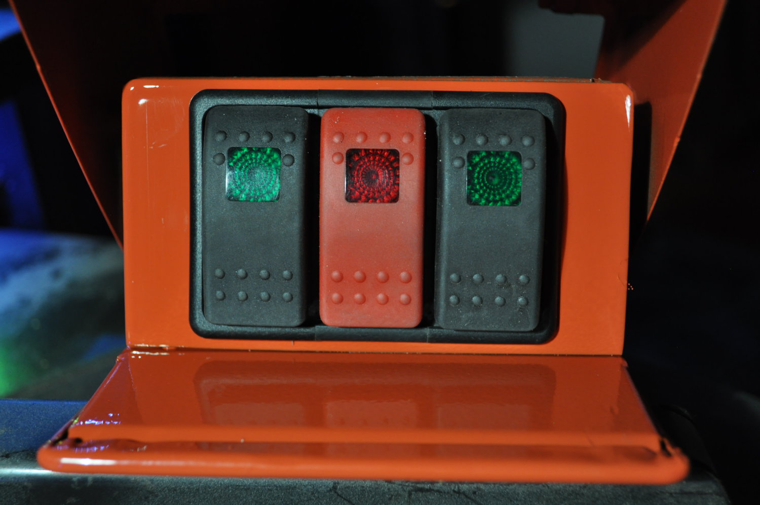

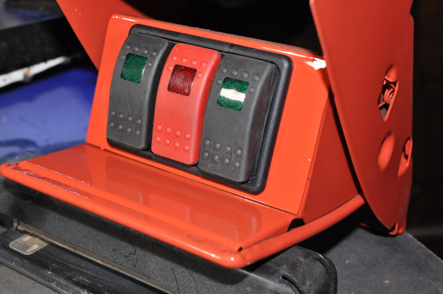

turns out I did have the correct switches after all.. I was surprised.. here's the finished product.....
full
full
just to verbalize what the switching is...
the center ACR is center is auto mode.. bottom is off.. top is parallel..
the 2 outers are the bat switches.. they are: center is static... up is momentary for on.. the light comes on... down is momentary for off...

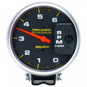

Do they make those in a range closer to what you’ll spin with the 12v?
lol, I'm lucky they have 6 g's.. every other AM tach is 9, 10 0r 12... my old one is a 10... that's it for a dizzle... AND i have to customize the install.. it's only available in pedestal.. if i remove it, it will lay like the in-dash ones according to AM tech.. prob is there is no mounting studs.. but i have a plan...
this is also, an "eventual" one.. i have to get one cuz the bezel is cut for one.. i also have 2 other 2 5/8's to fill at some point on the right side.. EGT and Boost.. eventually.. i'd prolly get the tach first for a couple reasons.. 1 it's the giant hole in the dash.. and 2, i'd like to get the pick-up worked out early on.. the downside being it's $400 compared to a hundy a piece for the small ones...

I used the Stewart Warner, if I had to do it again I would get it with hour meter, orange needle would be neat to.
that looks good.. yeah, I'd love like a 4g one.. but I'm stuck with the Pro Comps.... once I finish up my bolts, my evening project will then be prepping my gauges for Ryo red rings.. long ways away, but MAW have them ready to go if I've got the time...
That's one thing I don't get with many of the aftermarket gauge companies, even today they still ignore the demand for lower RPM tachs from the diesel crowd. Half the gauge is useless on the typical 8-12k models.
yup, I don't know what they spin at the track, but... I'm actually grateful that the sweep covers a fair bit to get up to 25 hunge on that one... the 10g tach, it would move like an inch.. :haha:

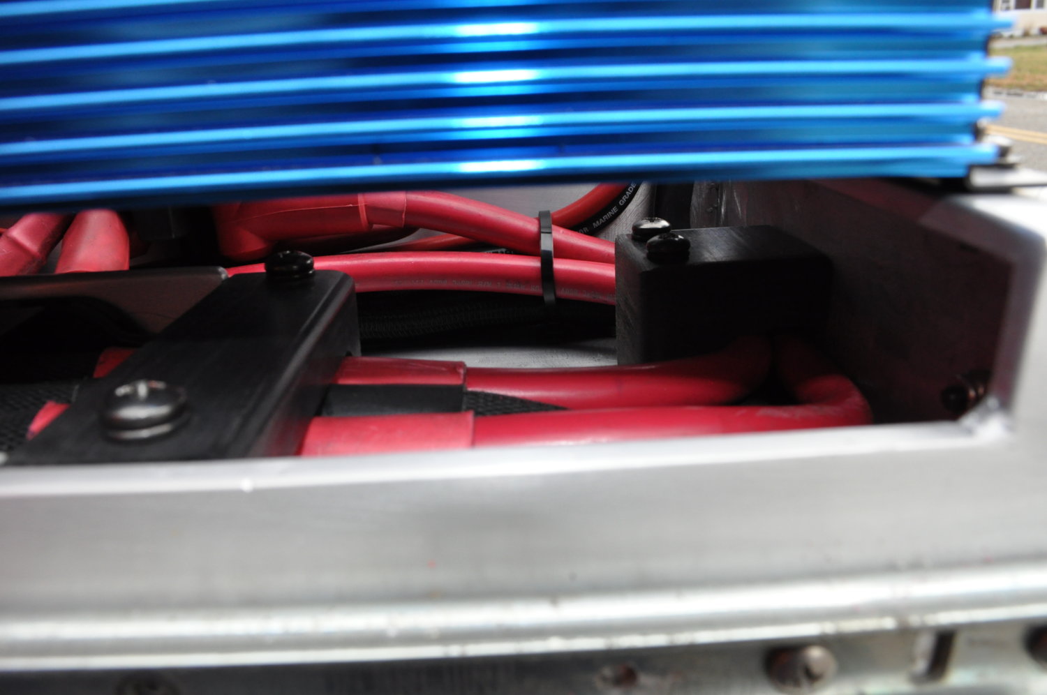

oh, 2 things that I would do differently, one I'll change eventually, the other no.....
i should have bumped the switches up an inch or so on the divider wall to give a bit more room for the wiring... just tight putting it all together..
the other is that somehow in my tray/track mockup, my landing points are a bit off .. it doesn't quite come all the way out, like 3/4" of an inch short.. you notice it when the tray stops, it wants to keep going a bit on the opposite side... it's not a huge deal, more annoying that it makes it tough to put the back pos on than anything... I will eventually fix it by putting another link in it.. plenty of room for it and just need to cheat the cables a bit on the ceiling clamp.. it's just I have to buy a foot of it at $35, so i'm in no rush....
other than that, I think it came out pretty sick..... :saweet:
