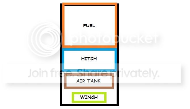

cool.... my tank should be about 50, 55 gallons according to the math I just did..... :pimp:
900 is a bit more than i was looking to spend.. maybe I can get em to just send me a template for now to check the plate..... :whistle: :haha:
Keep your eye out for a used one, just start with the gooseneck plate, then find the drop in fifth wheel.
under the deck, right between the rail's pretty much... than it'll have a lower bumper section with a regular receiver...
oh, and the tank isn't a big box, 2/3's of it is tapered down towards the hitch... I'm working on some idea's to incorporate it all together.. flatbed mounting. the hitch plate.. tube... fuel tank... yada.... just gotta plan it all out...
