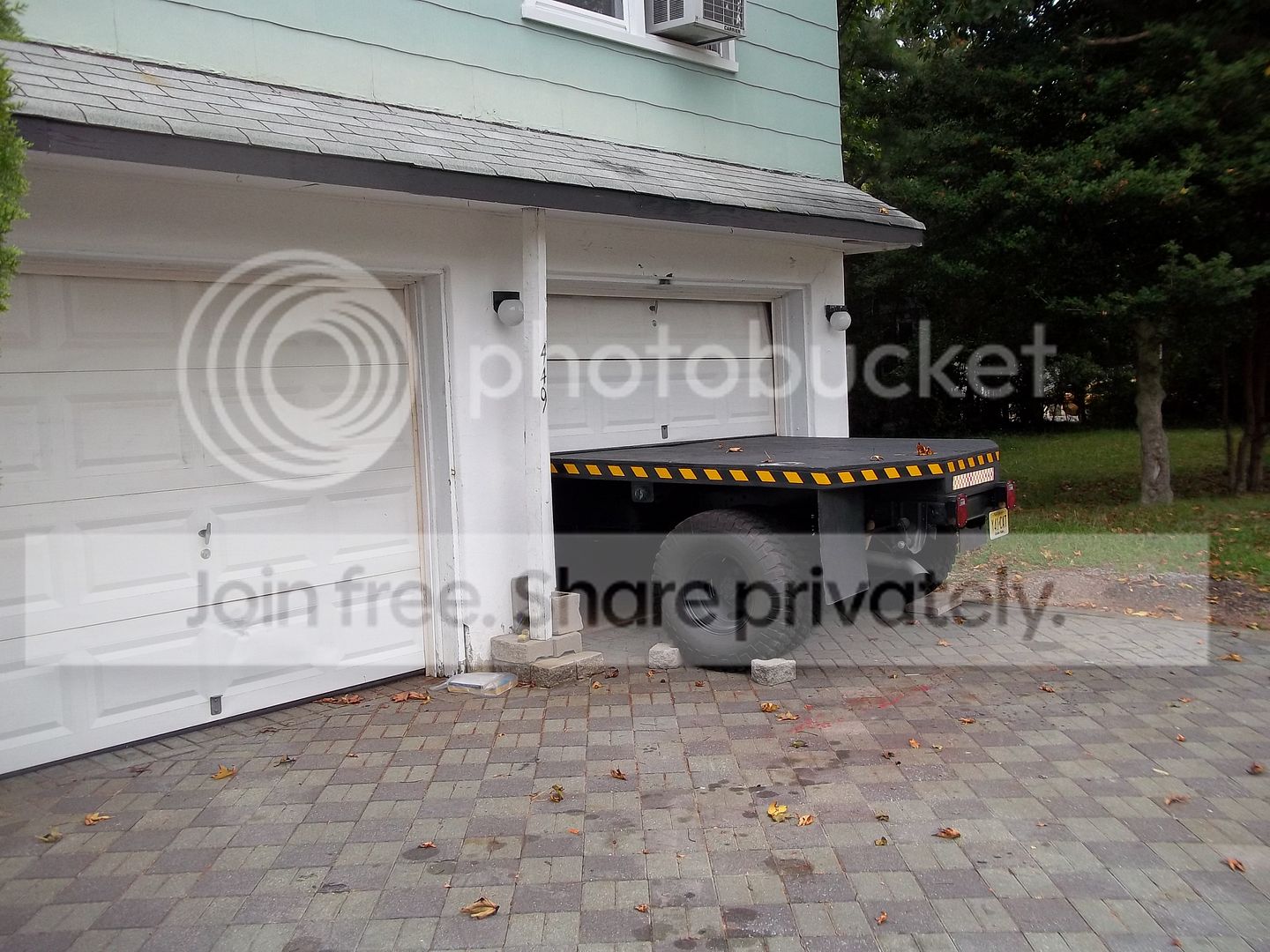

trying to see if i can actually cram Mutt in.... the tape measure says, maybe... :haha:
All but that 1/4" you forgot.:whistle::doah: Besides goes in lowered comes out lifted? Roll it out on the rotors....:haha:
Drooling at your pile. Jelous of your time to work on it. Someday may just need to send you a plane ticket. Cheif should he may save a couple of $$.
eh, technically, it would fit from door to opposed wall, no room to work at all tho... so I'm gonna just pull it 1/2 way in or so, close the door down to the flatbed for a couple days... the front is the bigger deal, I should be able to do the back in a day easy after the front is done.. but the fronts gonna take a couple days probably, I'd like to have that "in" the garage...
you did just remind me of the door tho, and i had forgotten that... :doah: :haha: the cab definitely wouldn't fit back out... actually i do have some 8 lug steelie rims that i can use for that, beats using the floor jack...

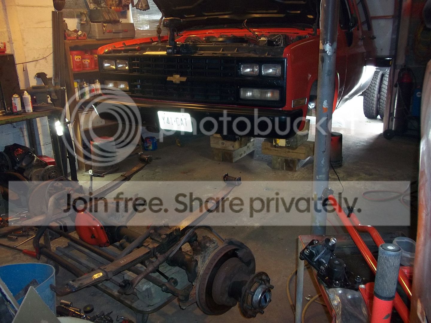

so, that's this weekends plan, clean, scrub, reorganize the dungeon.. this is gonna be my prefall cleanout so I'm all ready for some tube fab work over the next months... gonna pull a good amount of stuff out, powerwash, etc... the biggest ordeal is gonna be moving the K5... not an easy task on saw horses.... :doah: :haha:

nah, no need for boards, tho they have been used occasinally over the yrs for axles, fridges, etc :haha: between the cherry picker and floorjack, no big.. it'll just be an all day affair, especially trying to run a powerwasher in there.... gotta see how much stuff I can get out of there, and there is a lot of "stuff" :doah:

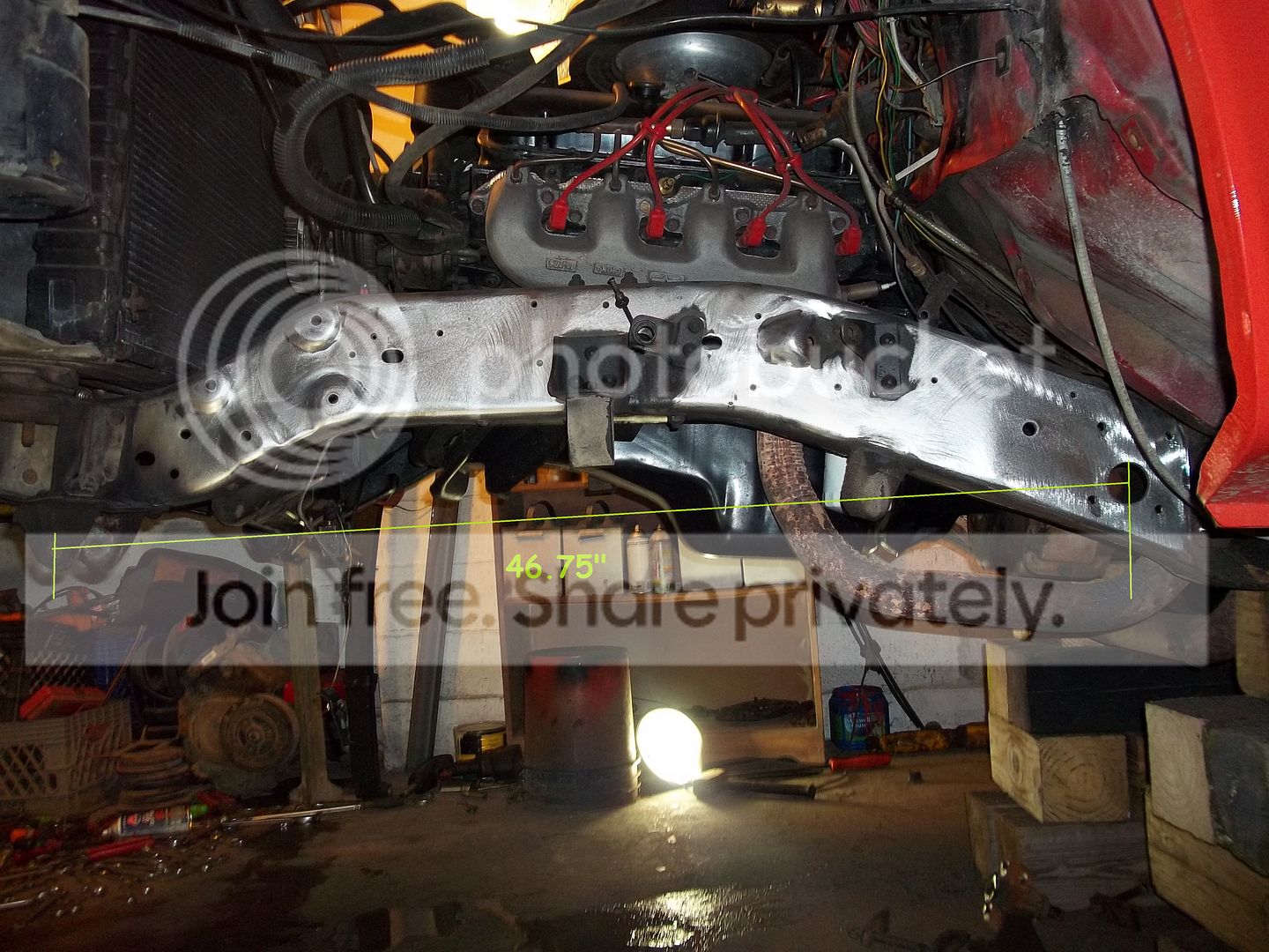

Mutt, under the knife... :popcorn:
Mutt's butt...

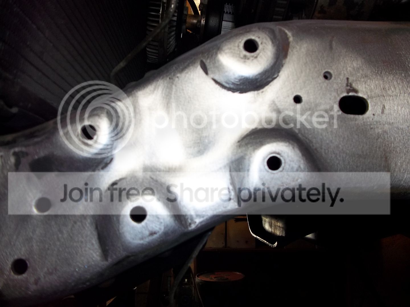

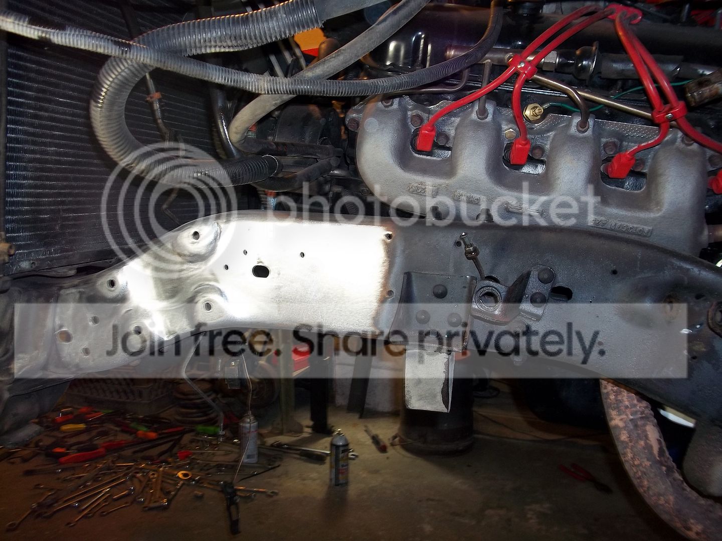

ladies and gentlemen, here we have the ever ellusive and rare, crack-free GM frame! :haha:
it's still getting the weld-in and bolt-in tomorrow tho... ;)

By any chance can you grab that measurement off mutt for the shackle?
on the k5 it was from the middle of the bolt hole back to the middle of the back bushing hole in the frame is 46 5/8". From where the springs bolts in the front to the center of the frame bushing
Other then that I can't wait to see Mutt's new look.
Thanks.
Thanks.
maybe just a tad shy of 46.75" so, just about the same.. this may be a more accurate measure, pluds it's stock, whereas the K5 is the B-52 setup...
That is perfect.:bow: I couldn't have asked for anything better.
