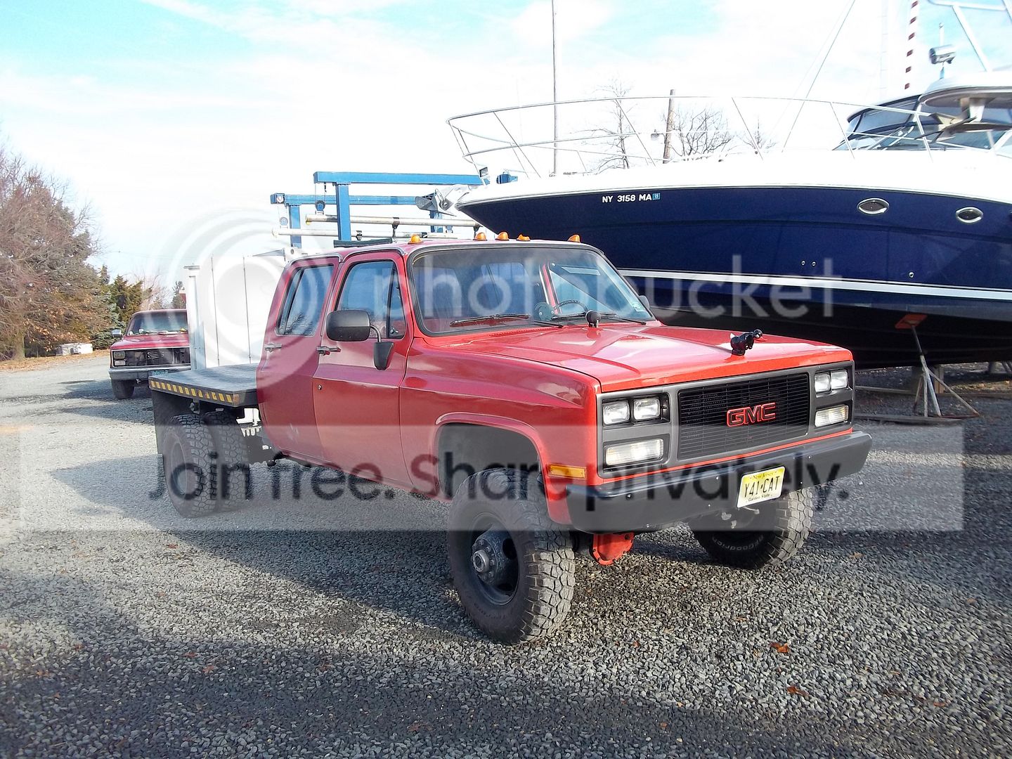

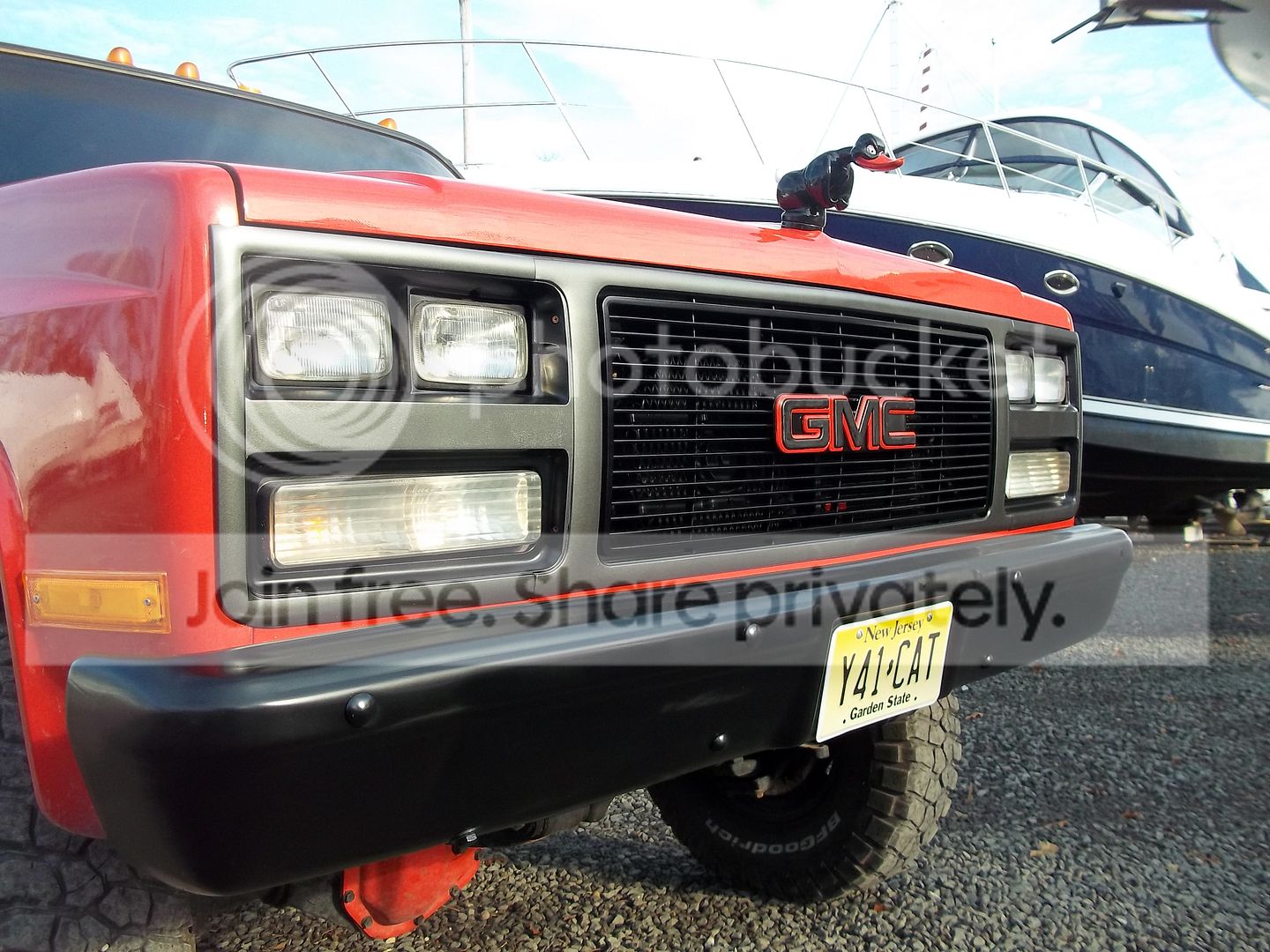

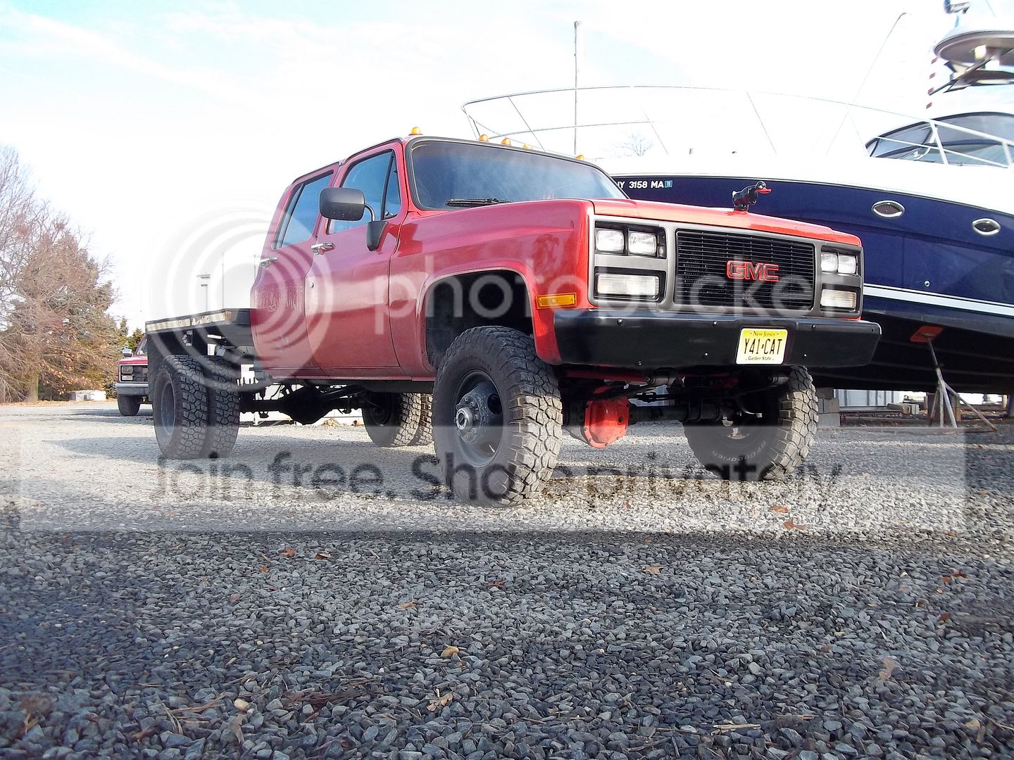

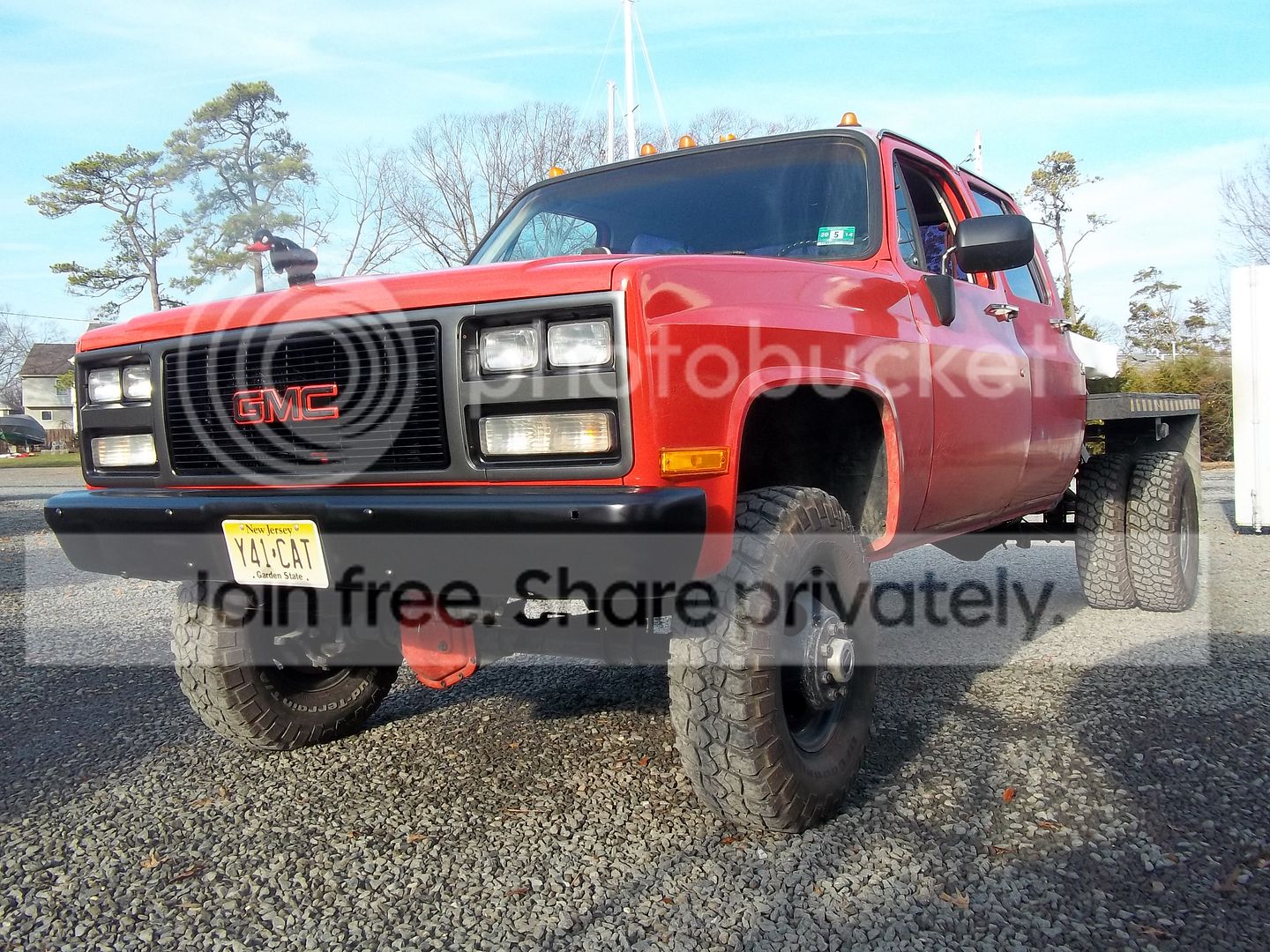

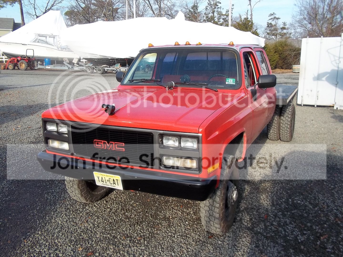

not bad for like 7, 8 months.... :haha:
thanks, she's getting there.. :D the tube bed's gonna be the centerpiece of the rig hopefully...
