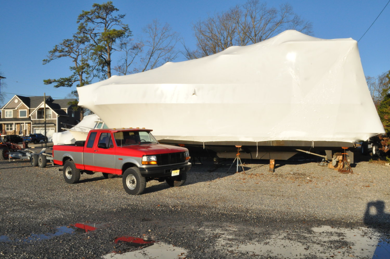

Looks good out in the sun.

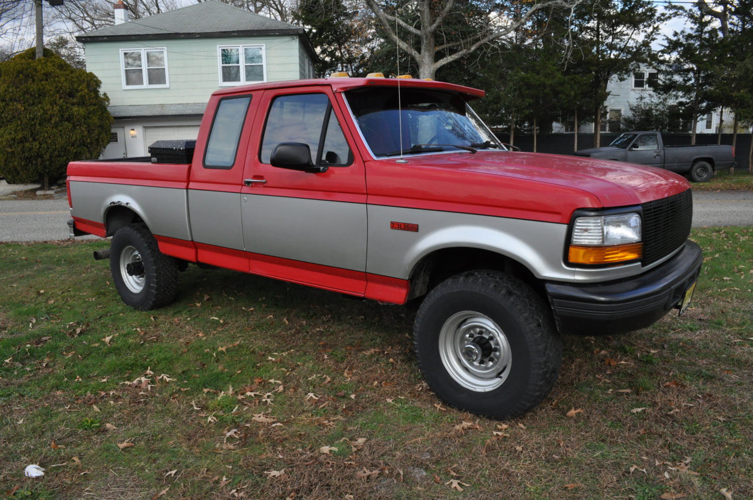

the argents funky... it actually has a bunch of metallic to it, but often comes across very grayish.... next time I spray it, I'm gonna change up my cap and technique a bit.. lighten it up some... get a bit more "glitter" to it...
i REALLY dig the scheme tho.. VERY pleased with how it looks overall... pics don't do the rig justice, it looks pretty badarse sitting in the marina...... it shows me enough to know I'm on the right track.... it sounds good in your brain, but until you actually see it, ya never know...
that, pinstriped, moldings, custom qrter stickers, reshoot the tool box.. with a SAS, stouter stance and beef up the steelies with the 35 yoko's, and I think it'll be a pretty worthy daily rig...

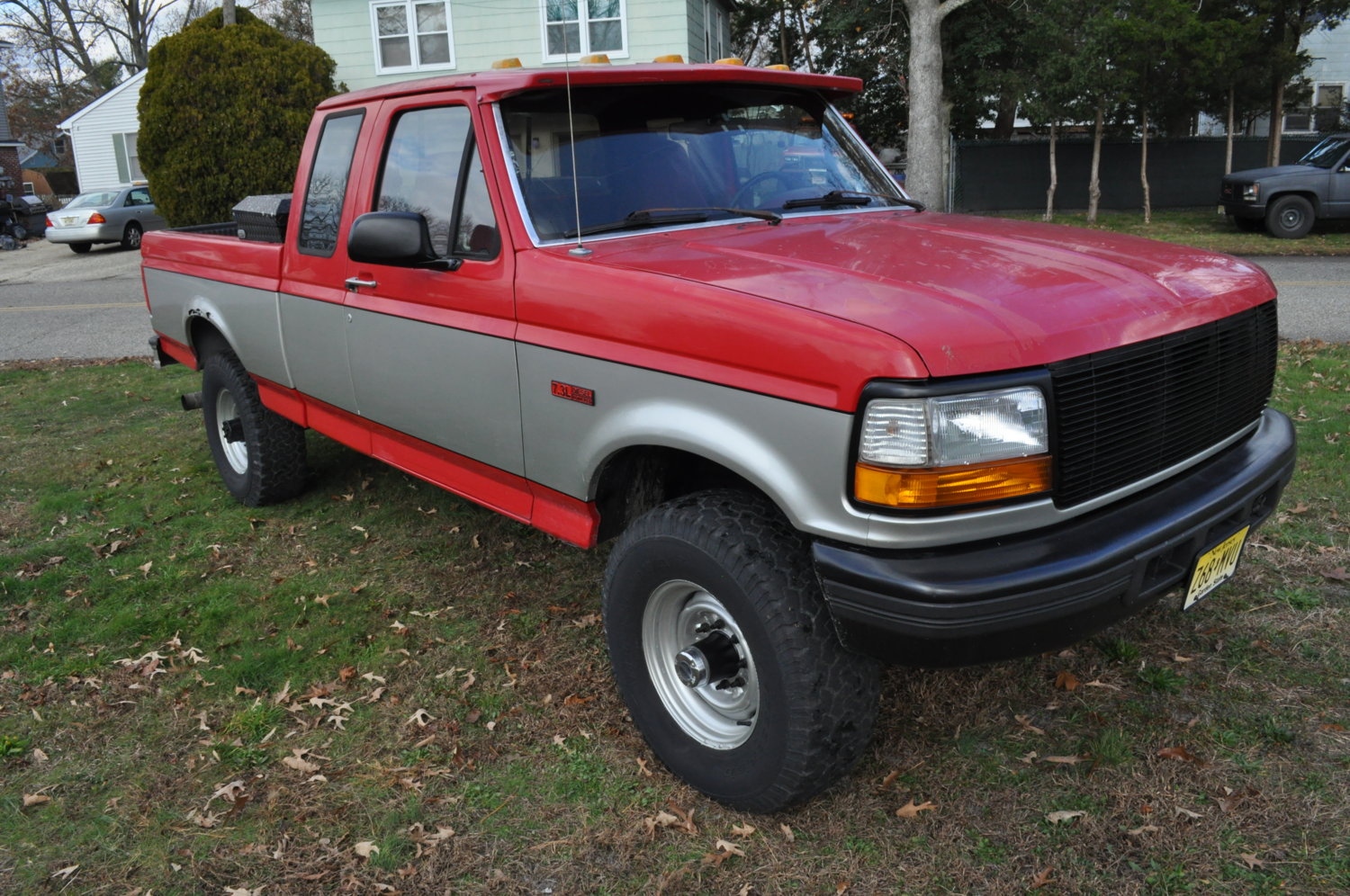

added a satin black pinstripe to break up the color changes.....

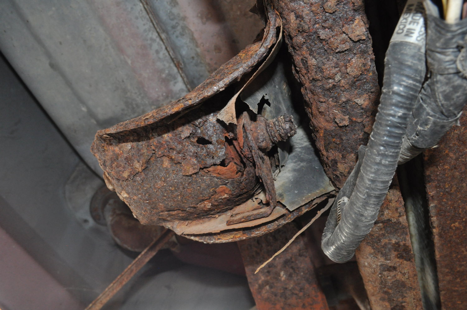

boy, this rig needs a suspension thrown at it REAL bad.... :yikes: ds rear hanger is TOASTY... could fail...

changed out a ton of them hangers over the years . nasty paint job let moisture sit under the paint and rot them out .
melt the heads off with the hot wrench and pop the rest with a center punch bit in air hammer and use a sheet of tin between frame and tank .
then heat the snot out of the nut and bolt but not to the point of trashing the rubber bushing . pop nut off and spin bolt a LOT if you can get it to move to help bust out the rust . then air hammer it out and install new .
some hanger kits are all inclusive . hanger / bolts / eye bolt and nut / even a bushing just in case .
