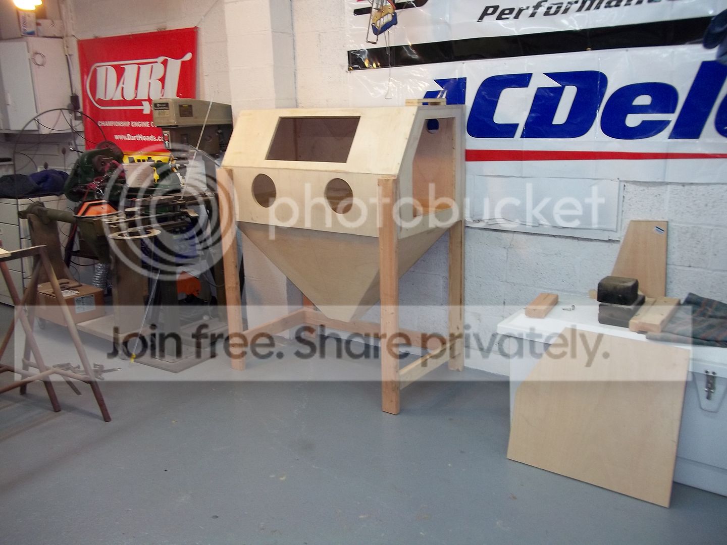

nah, the 60 and stand are temporarily sitting in front of the lathe, you can see it in the top pic... not sure where it's gonna go for now till I can actually start working on it.. but that's a ways off... I'm just trying to avoid bringing it upstairs to the "parts warehouse".. I can carry the empty housing upstairs, but I'd rather not...
I'm hoping this will be the last major rearrange for awhile... I'd like to actually finalize locations, and get the dirty room partition back up...

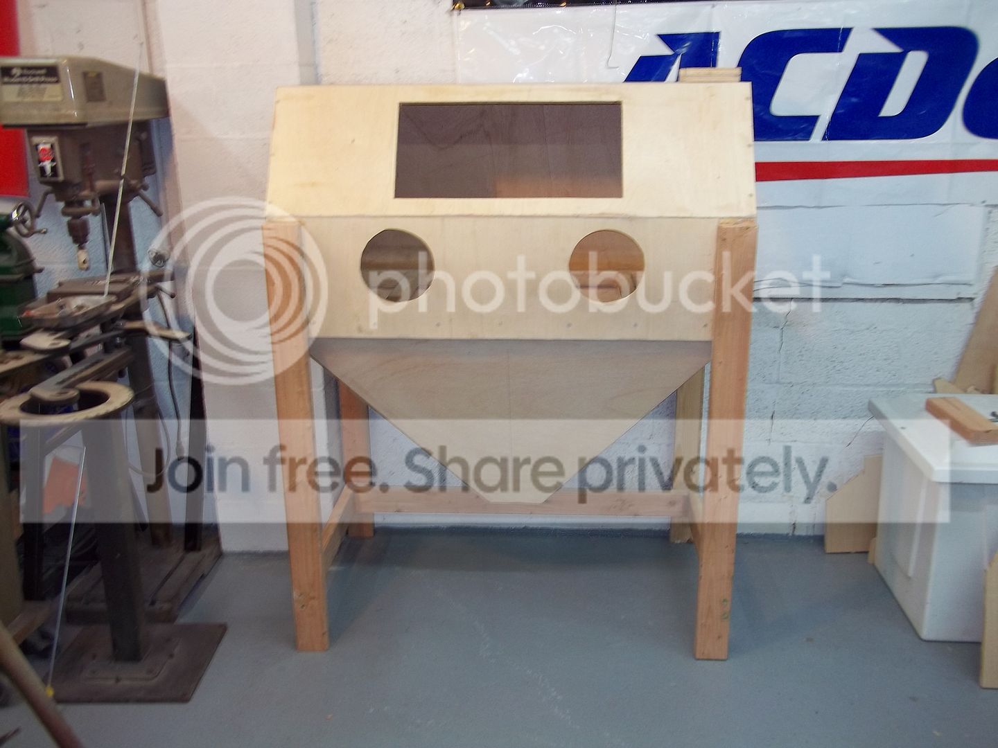

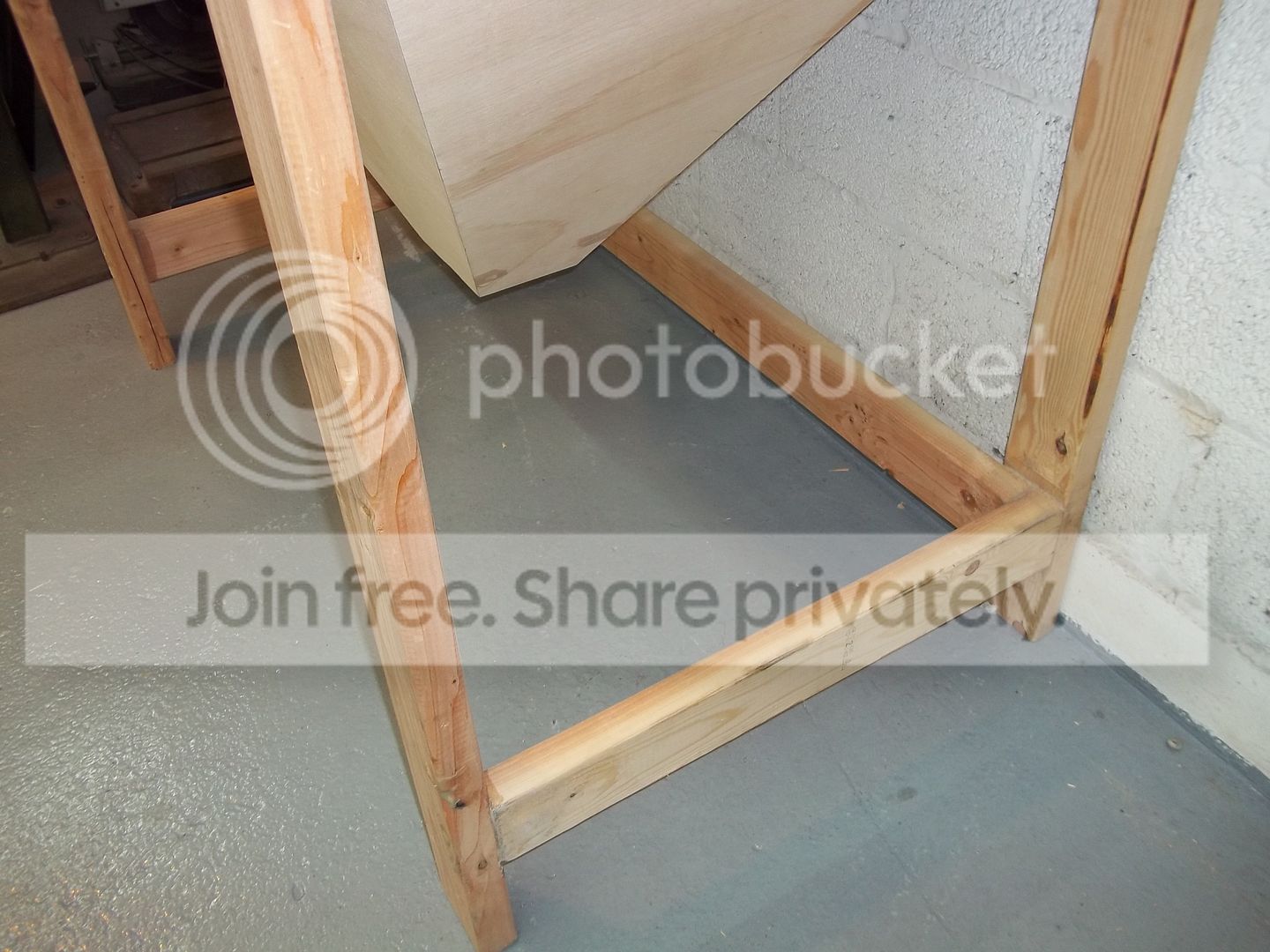

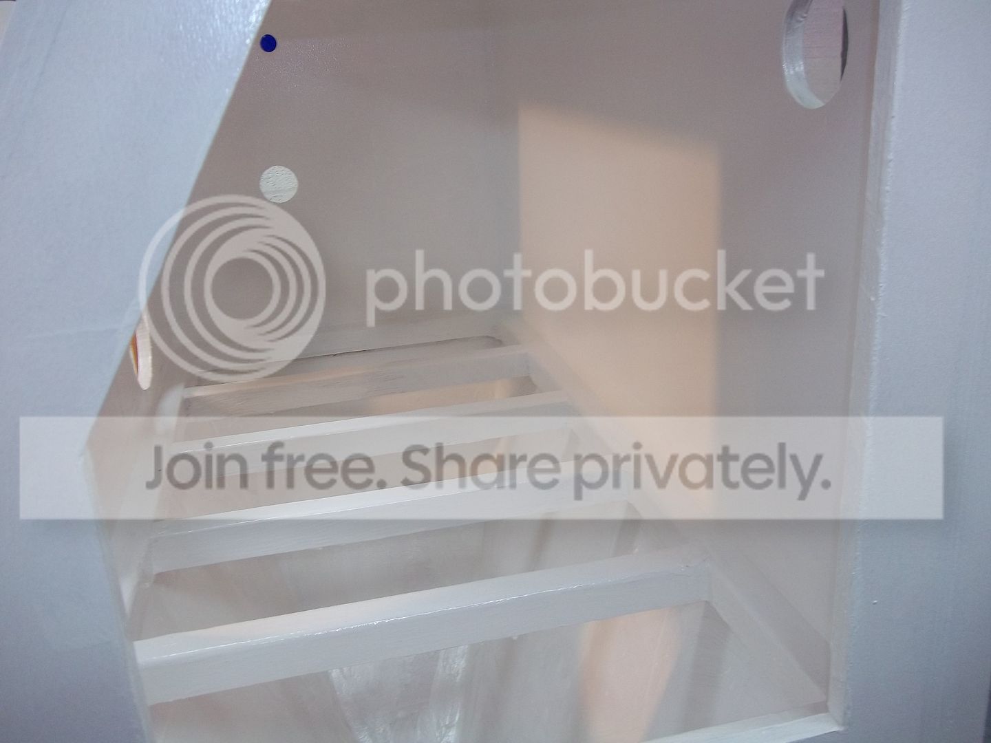

This is pretty cool. I've done a fair amount of blasting with our cabinet here at work and I'd never believe you could get away with a cabinet holding up that is made of wood but I suppose it makes sense if it is being used for just occasional hobby type use as you've said.
I wondered too about the wooden supports where the media will hit directly, but I guess you could even put some metal plating over it or something if you were finding it wears to quickly to your liking.

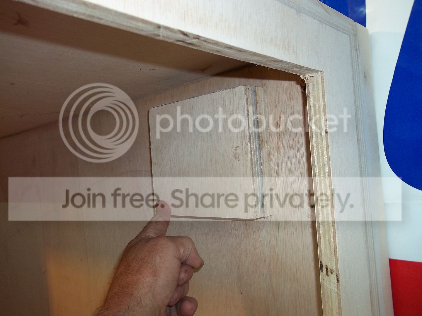

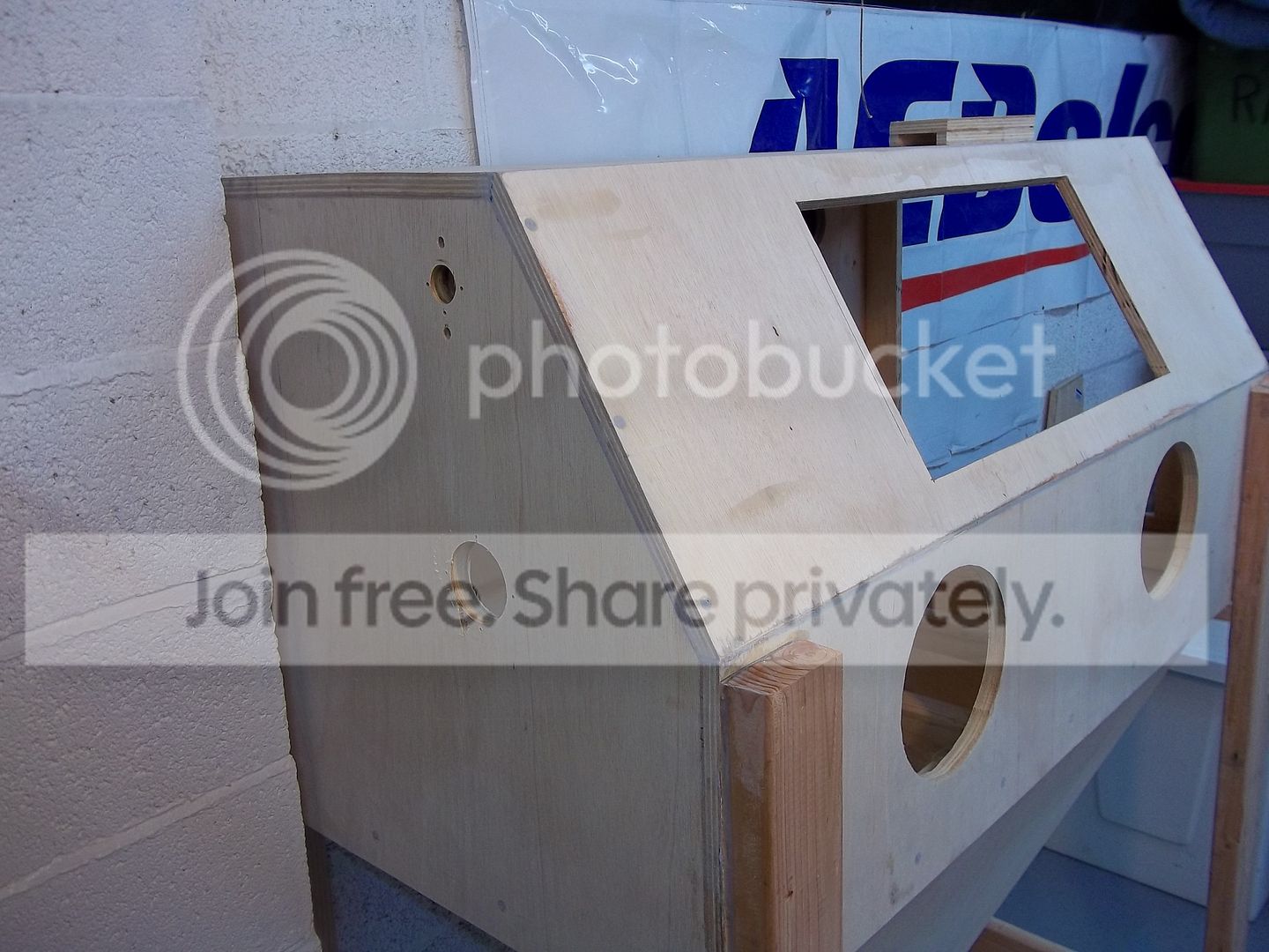

that one hole down at the other end is for this box/light setup... if I want more, I can add the fixture only to the right, down at the door-end of the cab...

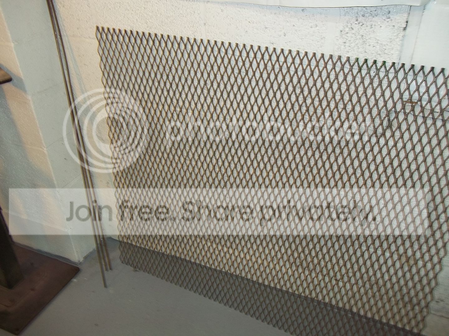

every blast cab I've seen just has a hunk of the expanded in there with all the sharp edges.. never really an issue... I just like that "finished" appearance the rod makes around the expanded... little more trouble-free handling too....

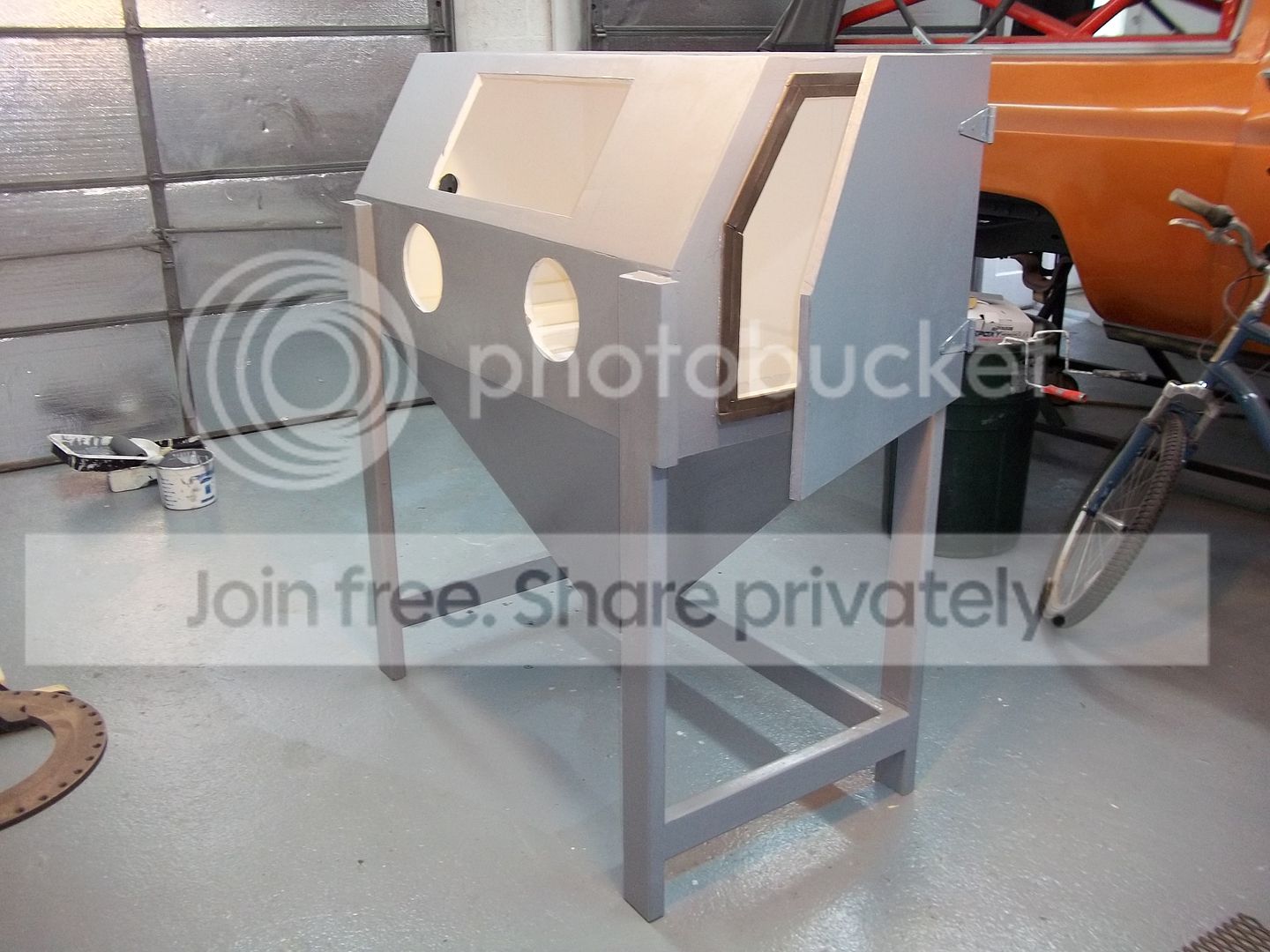

gonna start on the framed screen tomorrow night... having trouble finding my Rusto floor paint locally, everyone's out of it... gonna coat the exterior than touch up the garage floor with the leftovers...

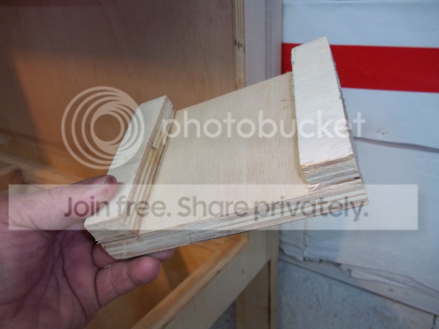

I wanted something that would get progressively tighter.... there are some marine transom door latches that would have worked nice, but I didn't have any kicking around at work... so I'm using a household window lock that I picked up at homo depot, seems to work great......
hopefully I'll have it together and running by the end of the weekend...
great....the blast cab at work has a simple clamping latch, that as you close it, it draws the door down tight onto the seal....those simple progressive window latches should do the task just fine!
