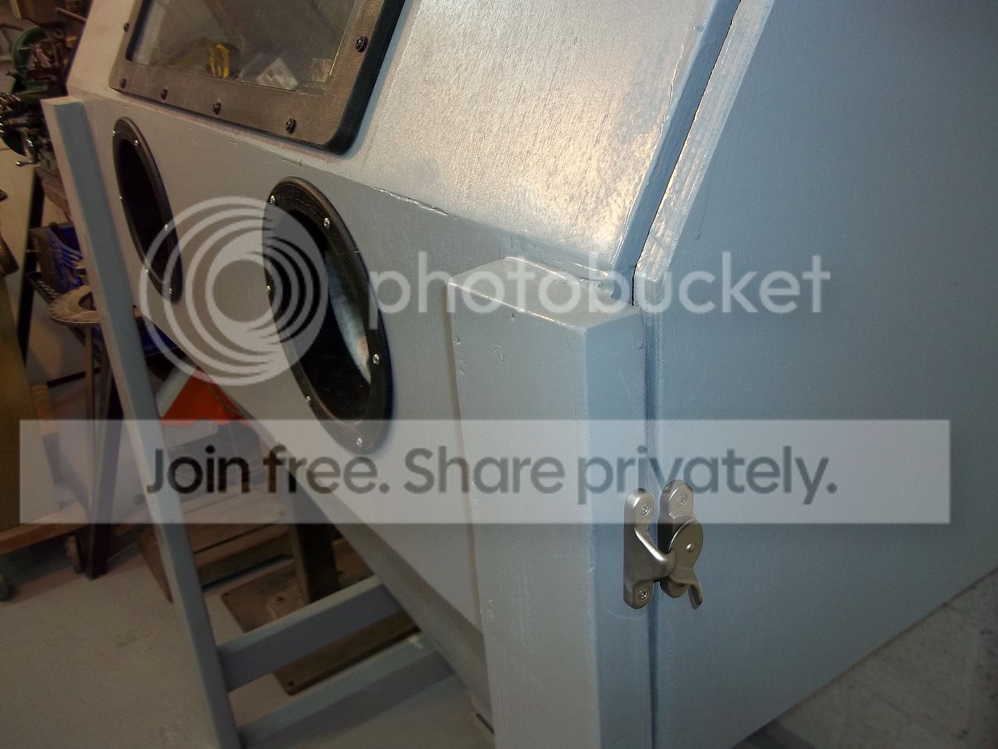

yeah, I know the latches most of the pro ones run, and it just seemed overkill, and that this would work fine.. we'll see...

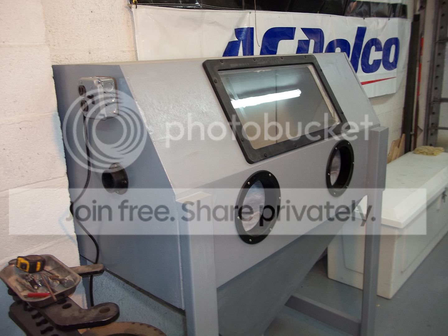

it's close now... just gotta install the gun and foot pedal, a lightbulb and the media now...

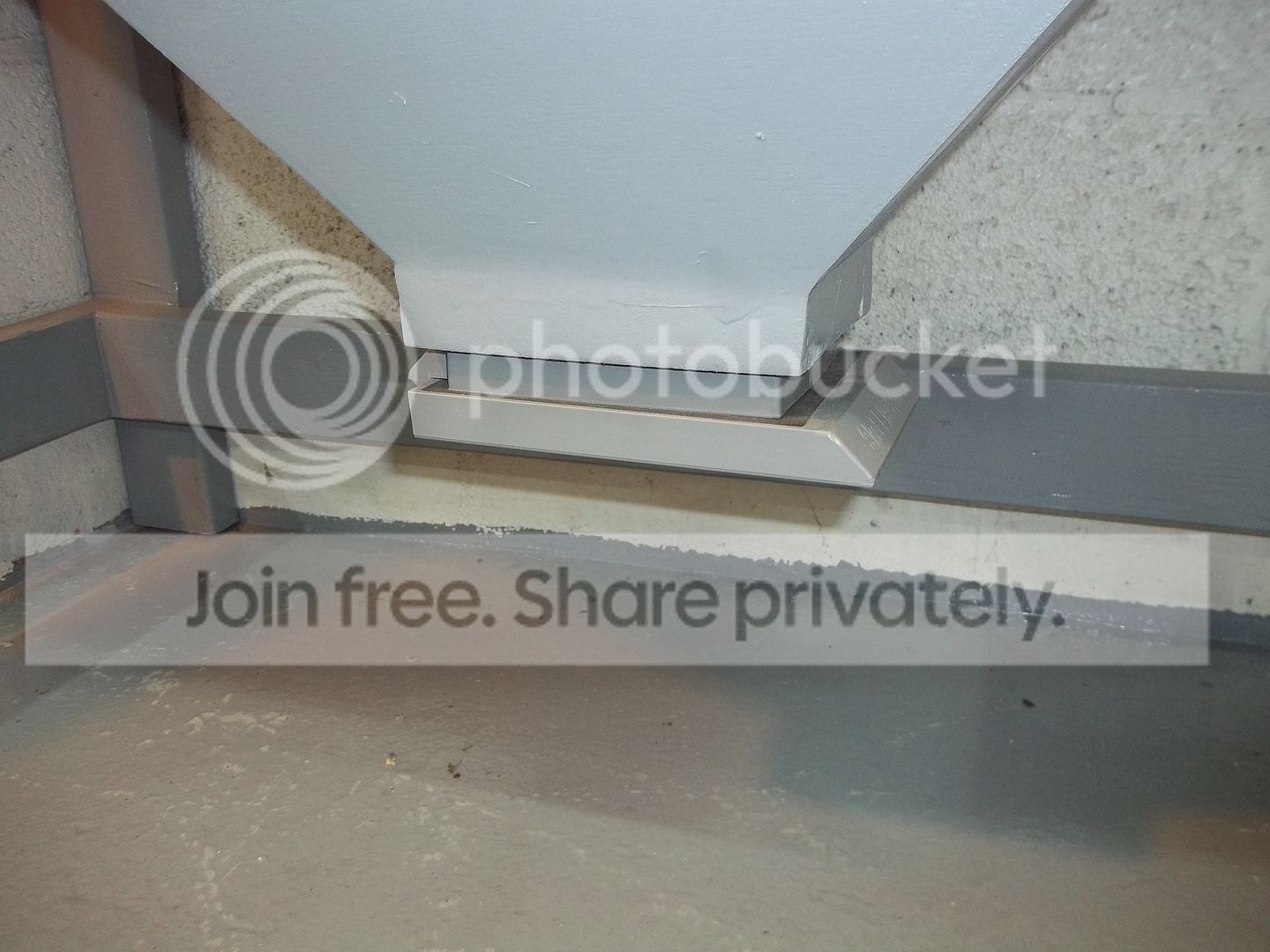

the springloaded trapdoor for changing out the media...
the latch setup...

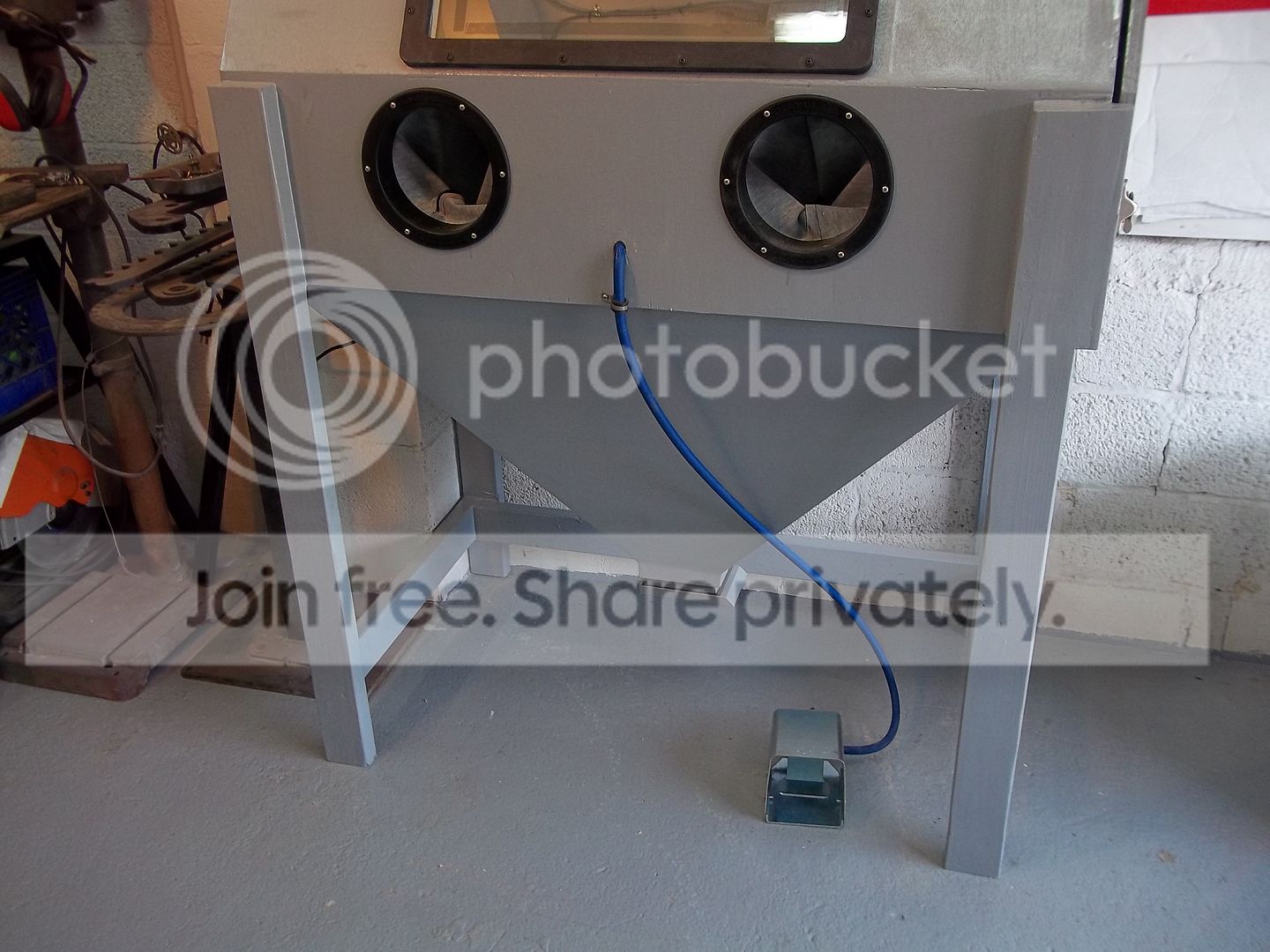

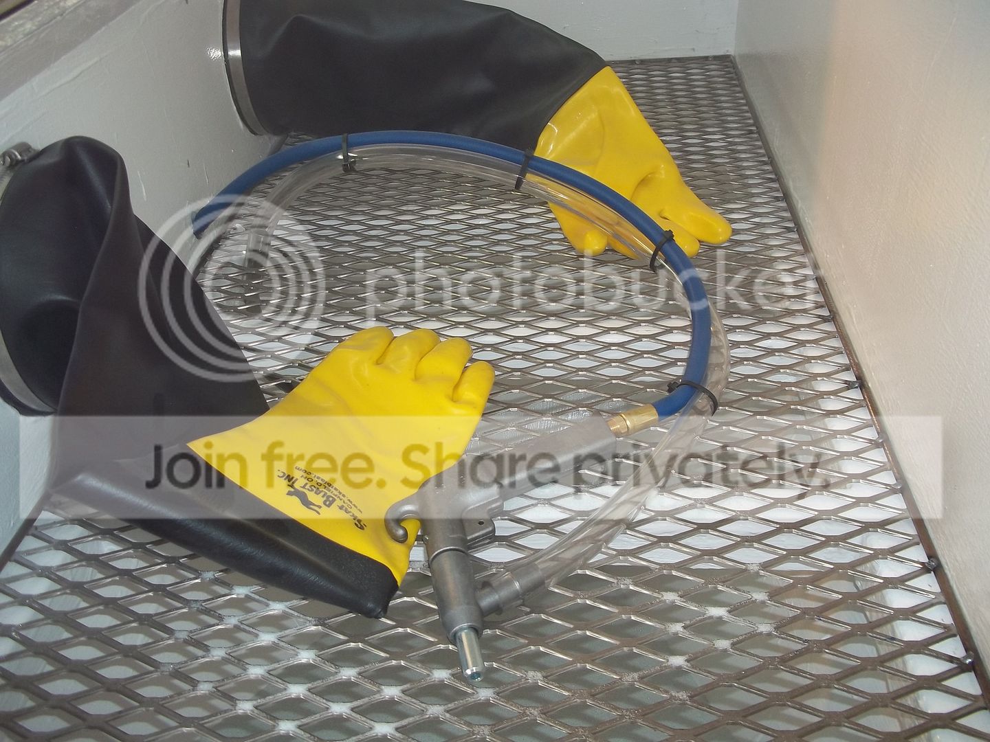

here you can see the dual pickup tube that feeds the gun coming up thru the screen.... the gun siphon hose attaches to that tube.. than the air supply comes from a hose off the foot pedal...
foot pedal/gun and media installed.... ready to blast... gonna wait till tomorrow to try it out so some caulk areas can fully dry....

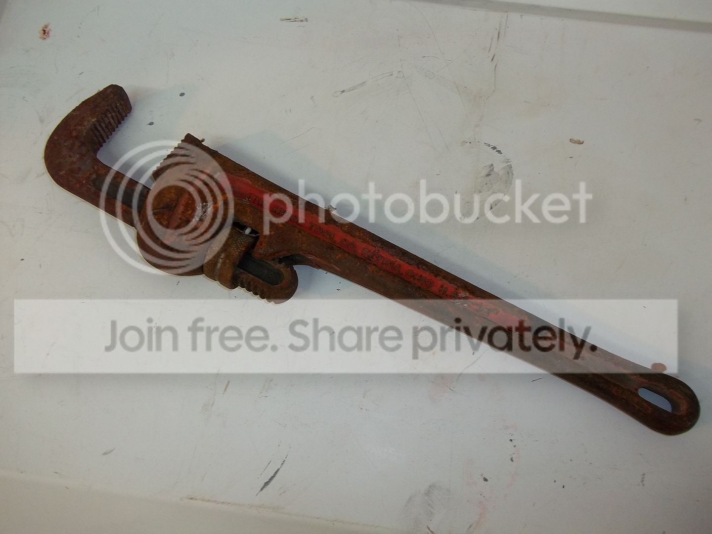

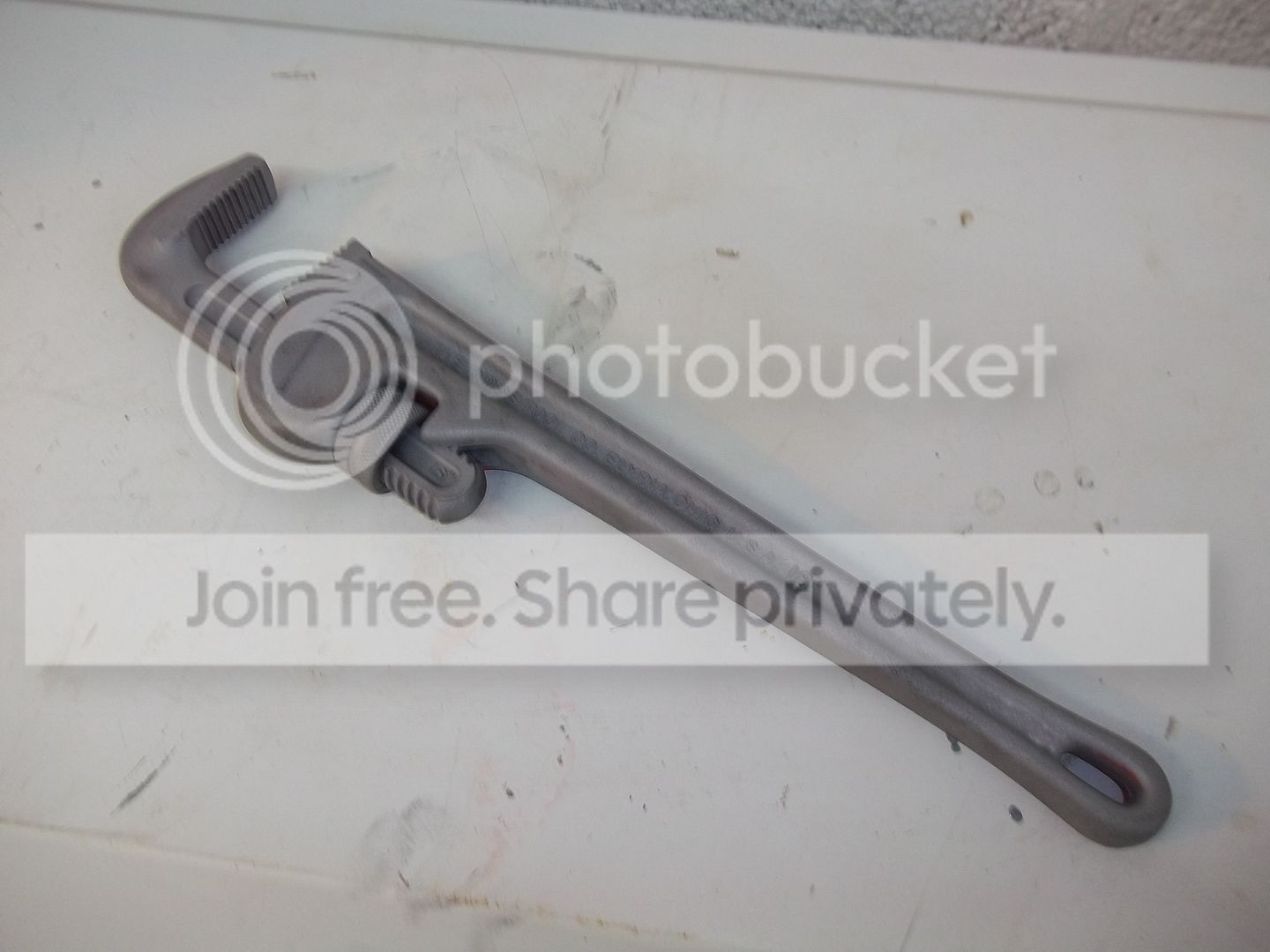

so... while doing yardwork and cleaning up truck parts behind the house yesterday, I found an old pipe wrench buried in the dirt by my gas meter that one of the workers must have left there years ago...
about a minute in the cab

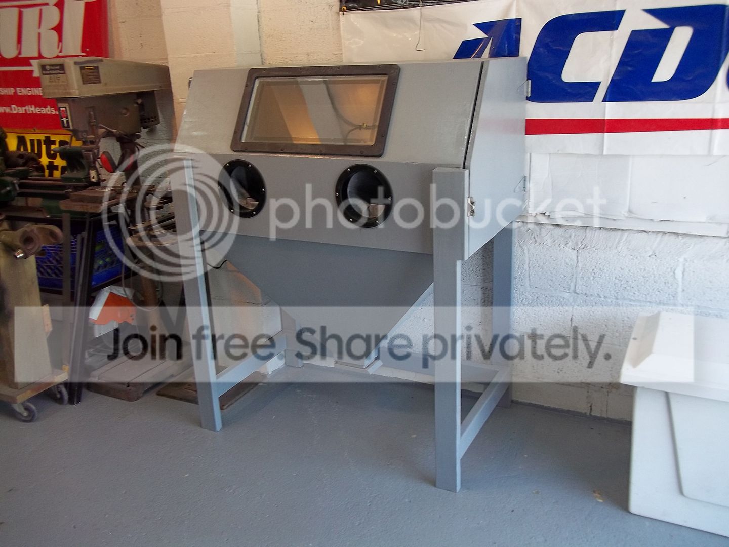

it kills it..... blasts amazing... :woot:

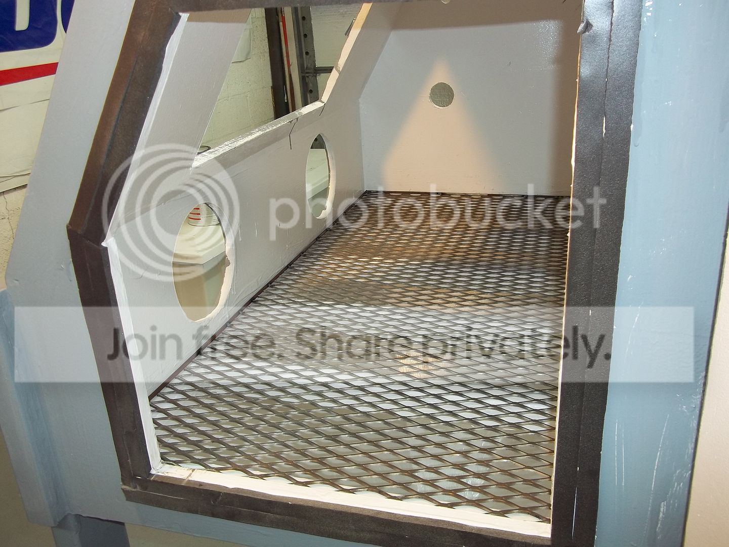

light is decent, can see good, but I may add a bulb to the other end just to even things out, and eliminate potential shadows....

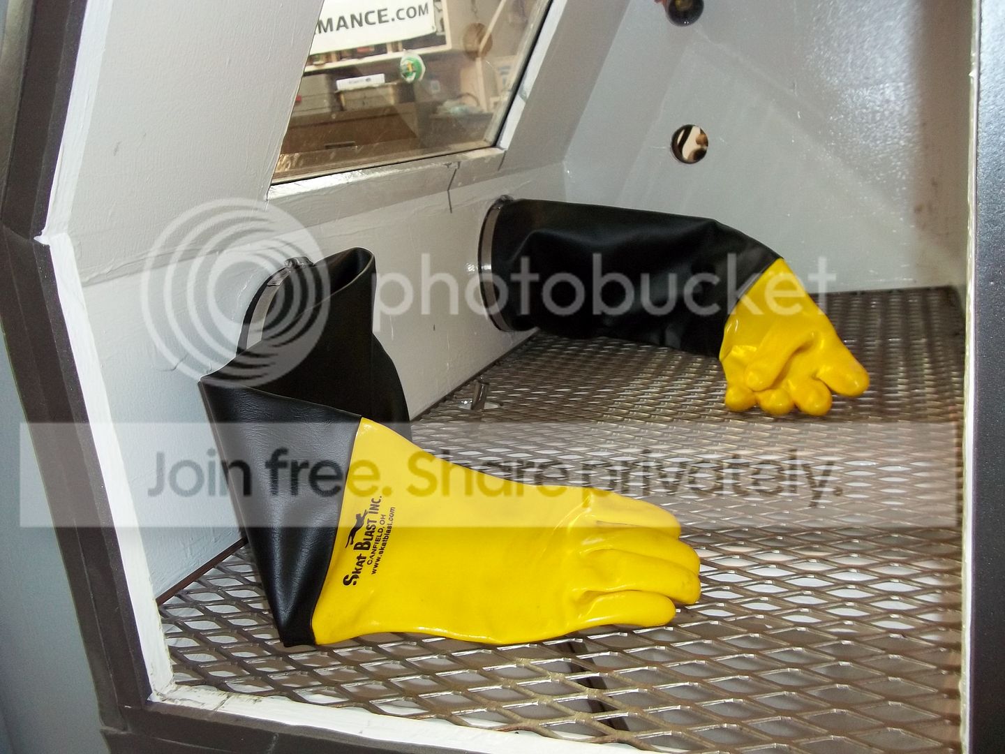

one issue I noticed was that I need to enlarge my intake some.. or my shop vac seriously rocks... cuz when ya turn it on, it practically sucks the gloves off the flanges inside the unit.... :eek1: the minute you turn the vac on, they get all kinds of erect and what not.... :haha:
I'll have to up the intake hole a couple inches to even the pressure in the cab out a bit.. :popcorn:

so.. all in, on this project, you could do it for $400... it was 5 to me with the fancy ply, and their media.... but if you bought normal 3/4 exterior grade ply and used a local media, you could do it for 4.. $350 kit shipped, and $50 for the ply...

should have built this 20 yr's ago.. one of the best $500 I've ever spent...

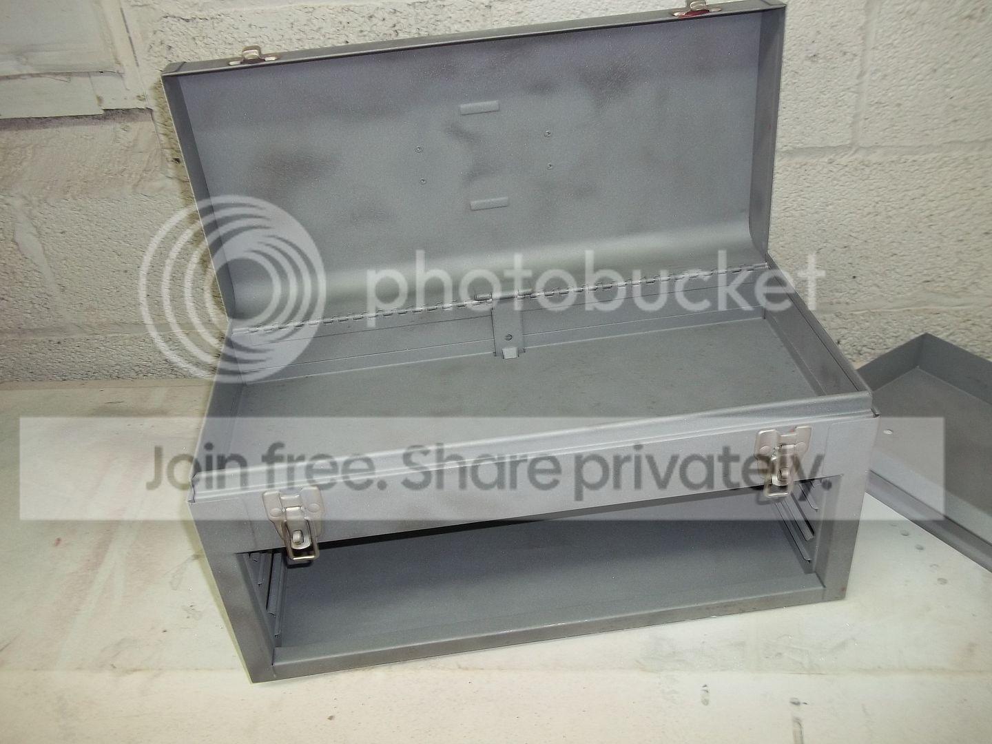

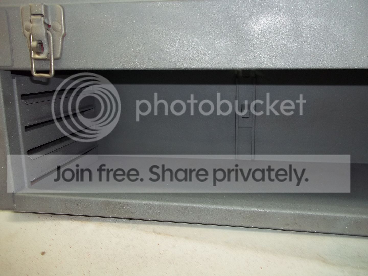

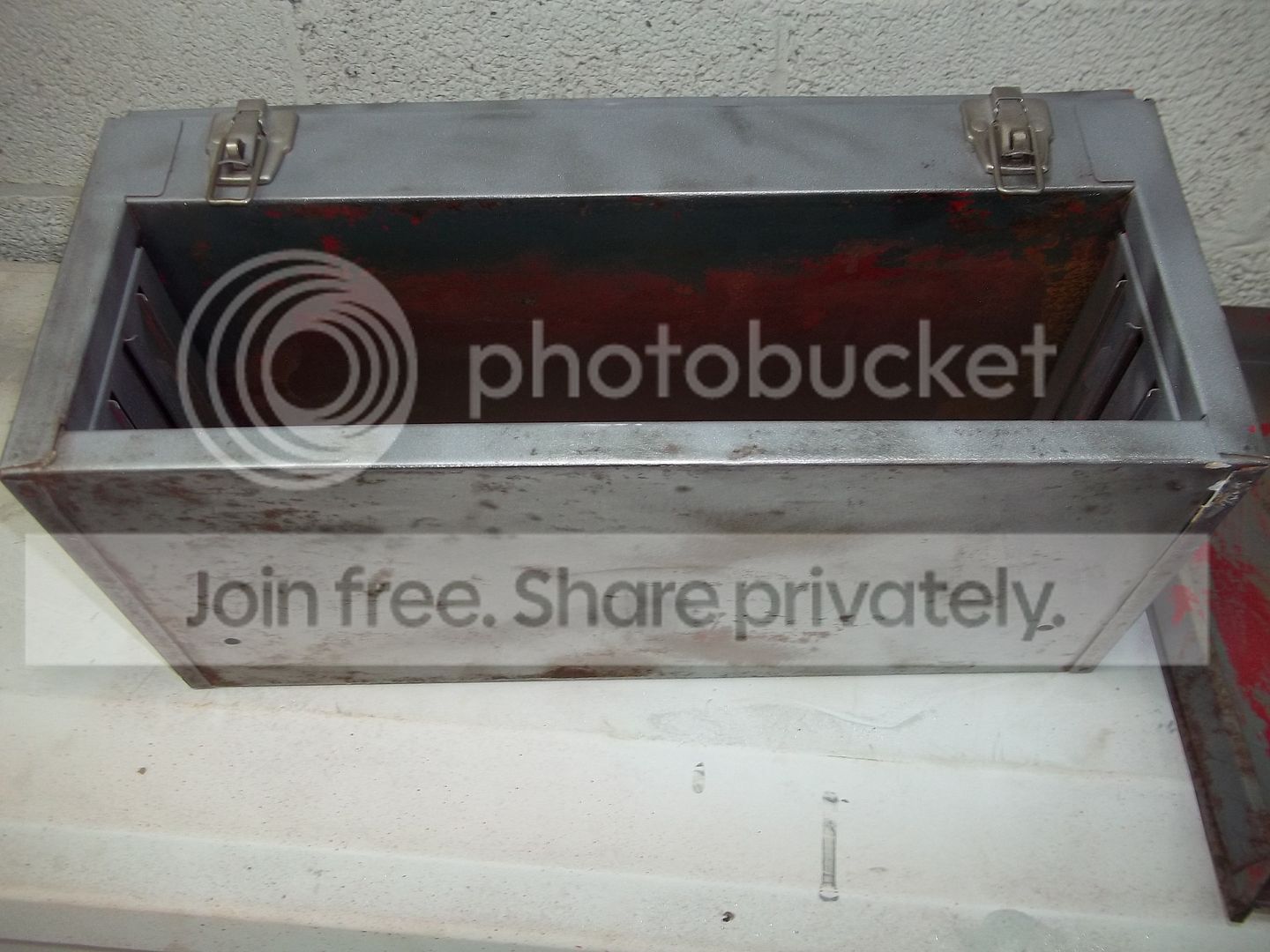

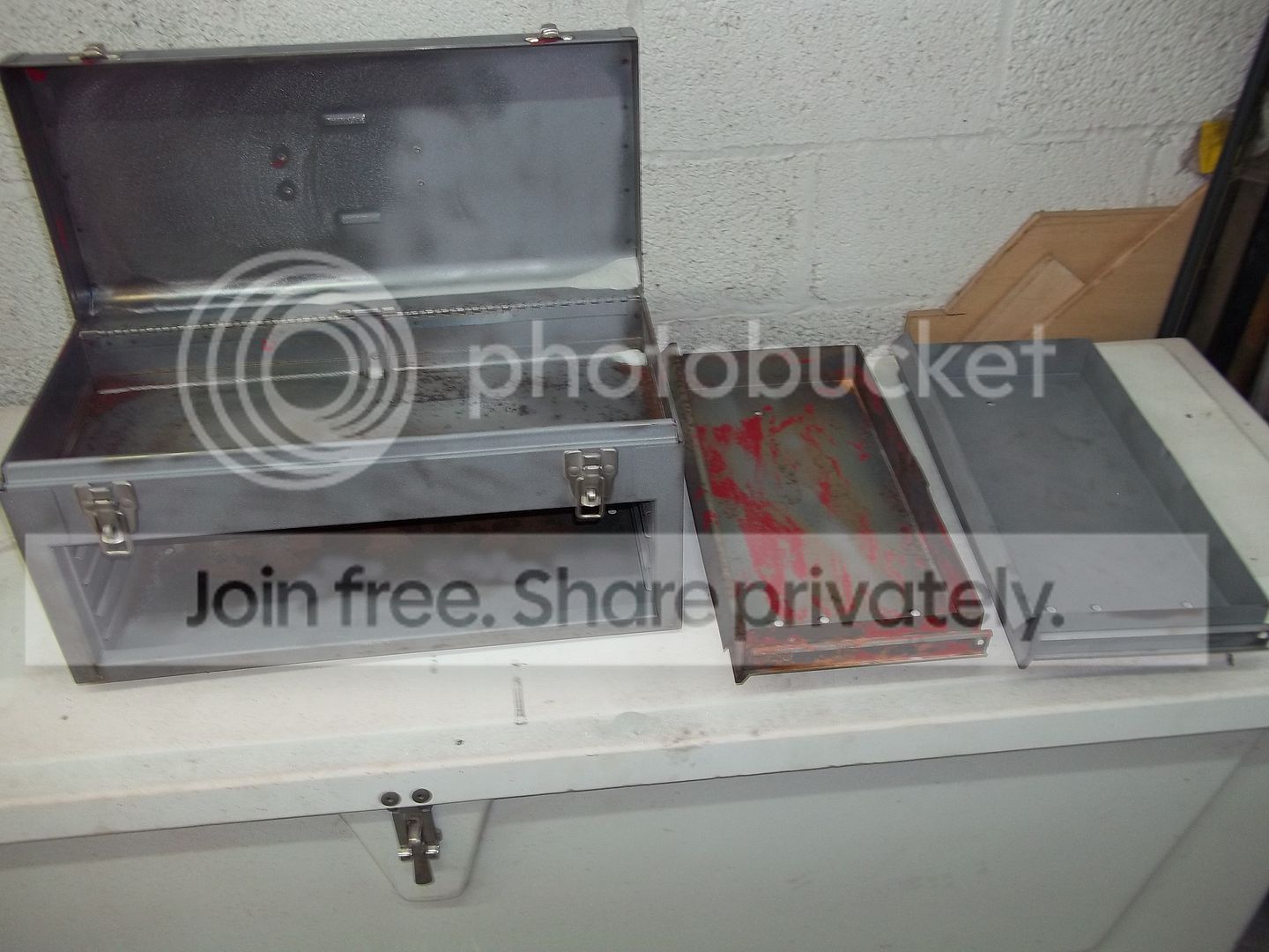

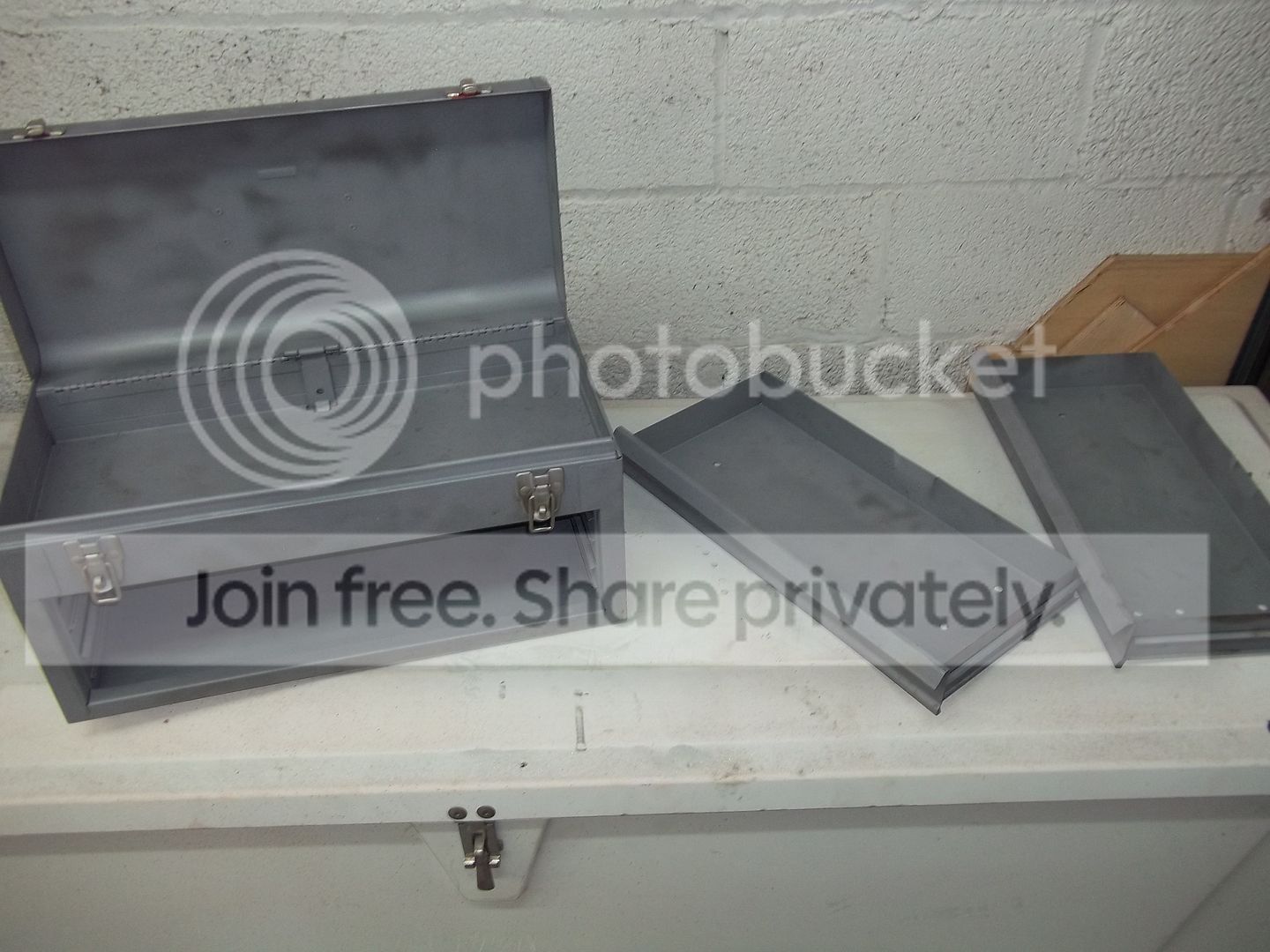

this weekends project, old semi stripped, semi rusty Blue Point toolbox... forgot to grab a pic before I started..
after 15 to 20 minutes in the cab...
mmmmmmmm, clean steel.......... :popcorn: :pimp: :woot:
this'll be going zinc/ Ryoken Red and go in Mutt...
the cab works killer.. needs a light down at the other end fo sure tho...
Looks great brother! :waytogo:. I know what you mean about should have done this long ago. I should have never gotten rid of one of the three I've had over the years. Hopefully soon I'll build one. Right now, it's all about machine tools for me. You need to start building and selling these. I'd bet you could make money on them. For the guys that don't have the ability, or time, that would just as soon buy one.
You did an awesome job on this cabinet! I guess you could build one any width you want if you were wanting to blast axle housings.
thanks.. :D so far it works excellent... and yup, you would just need 3+ sheets of ply as opposed to 2...
