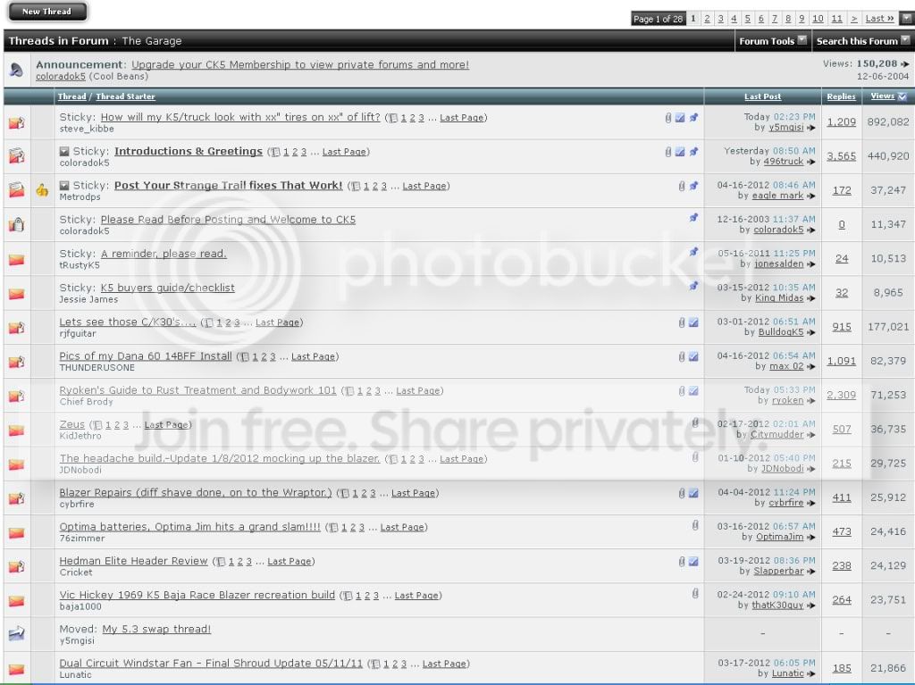

Just to try and show how useful this thread is, its third from the top for views! So for every ig-no-ray-moose that posts some silly question(like myself) many other folks are getting excellent useable information out of this thread! Good job fellas!
