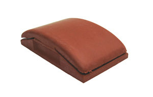

or, you can forego stripper, and mechanically remove it with sandpaper from the get go... this allows you to stop at any depth you want.. but be very aware, it is not steel and can cause low spots, etc very easily with sanders, grinders, etc if you are not careful and watching your layers and what your removing from where.....
