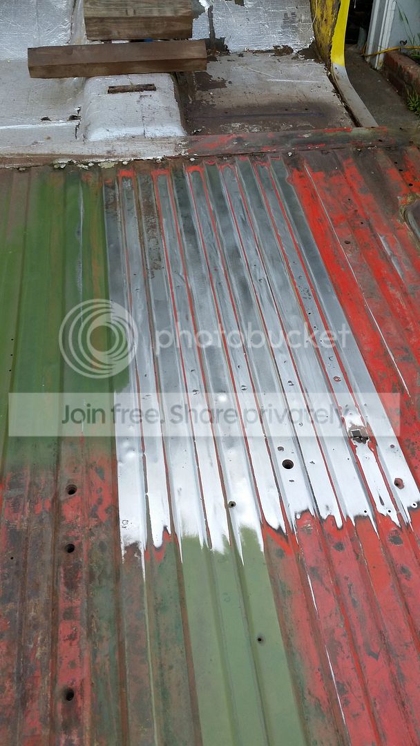

What's the best way to get the paint out of inside corners where a DA sander won't reach? Right now I am stripping the bed. With a fresh sanding disc, I can get the edge into these corners, but that edge wears out quickly. Later I will need to strip areas where the sander cant even get to. How should I go about that?
The plan is to strip the interior, to bare metal on the floors and interior wheel wells. And to take it down to the original coat of paint on the sides and other areas that don't see foot/cargo traffic, and then use a truck bed liner on the whole interior.
well, few ways to go... obviously blasting will do the best job... the way I integrate blasting, is to do what you're doing, mechanical strip as much as I possibly can with a DA, etc, than blast.. that way you're keeping your blasting to an absolute minimum.. than re-DA after stripped for an even cut..
couple other options are also once it's down to the nooks and crannies to use a bit of aircraft stripper, scrape, wire brush/wheel... than re-DA...
also remember that rotary tools will strip too, everything from a DA locked out, to rolocs... rolocs totally rule... a 2" or 3" setup will rip right thru that...
just keep in mind, primers, paints, etc work better over a dual action cut, than a rotary cut... so if you use a rotary to get the corner, it's always a good idea to go back over with a DA to get a proper "cut" to as much of it as you can...
also... just as an aside to this, from a guy who has run a DA eleventy thousand hr's... the way I usually go about sanding to utilize my paper to it's fullest is to, fresh sheet, absolutely flatpad it till the middle of the paper shows some wear, bigger flatter areas usually... than begin to finish off the paper by creating angle... finish off by edging into tight areas like these..
and I've said it a few times, but I'll repeat myself.. the most durable, toughest, longest lasting topcoats are created by a system... each time you remove a level of the system, you increase the % of possible premature failure.....
good primer and bedliner? ok...... good primer system, a proper urethane topcoat, THAN a bedliner? FAR FAR superior... is bedliner over primer an automatic fail? of course not... but it's not as bulletproof as over a quality paint...
Thanks Ryoken. I have a 2" roloc setup with a 90* die grinder for my compressor. I didn't even think of trying that. Derp. I will end up buying a sandblaster because I want to take care of that area along the front off the bed where it meets the foot well, as well as the rust pitting in spots along the bed floor.
One of the previous owners put a custom carpet kit in and used a plethora (Do joo know what a plethora ees?) of sheet metal screws to secure it in the bed, and on the wheel well humps. I was planning on going through and welding all those holes shut, but is it necessary since I will be using bedliner? If it makes no difference, I will skip it, but if it will mean less chance of rust getting hold, I will do it.

that's a nice well-rounded kit... shrinking hammer is always handy, and that has one... economy set would probably get ya by, it lacks the spoon, but you can usually get by without one for dings and dents here and there.....
I wouldn't rely on bedliner to fill screwholes... be worth a quickie with the mig usually, even if you don't gind em flat flat.. better than a hole IMO...
ask anytime ya have a question and hopefully I can help... :D
oh, and just to clarify myself.. I was talking about sanding/grinding discs on rolocs, not surface conditioning pads and such...
