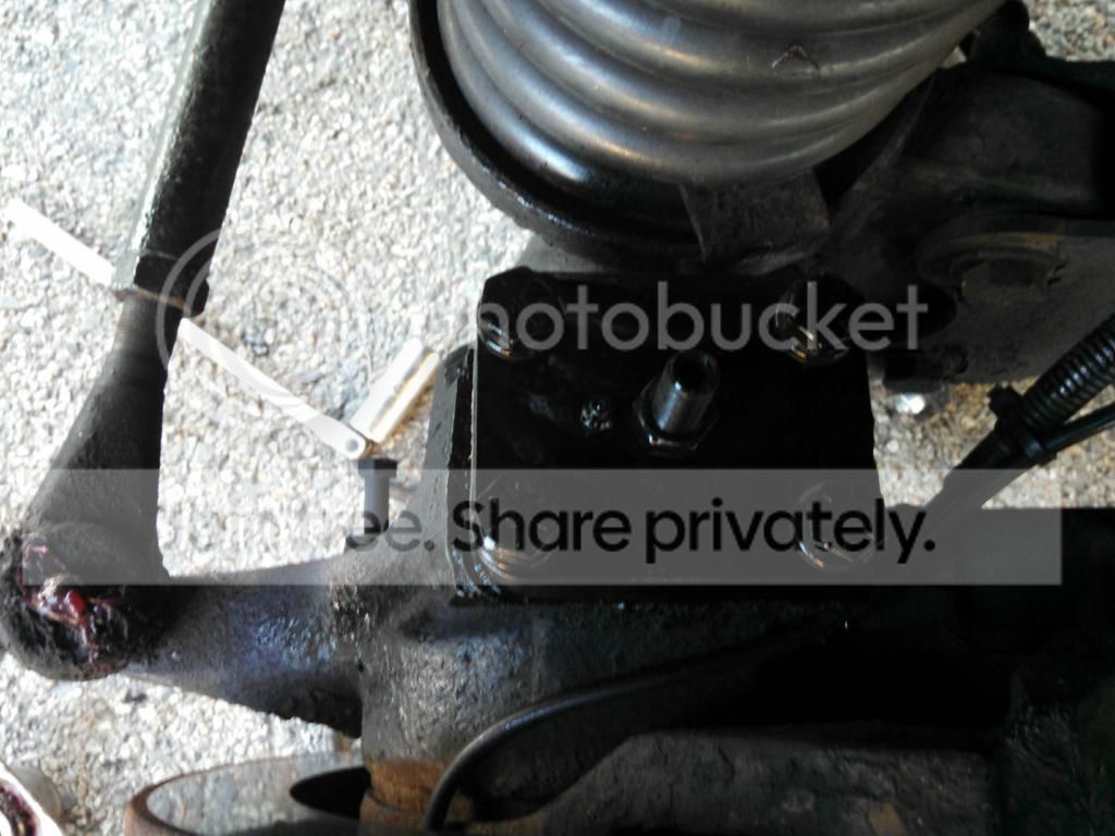

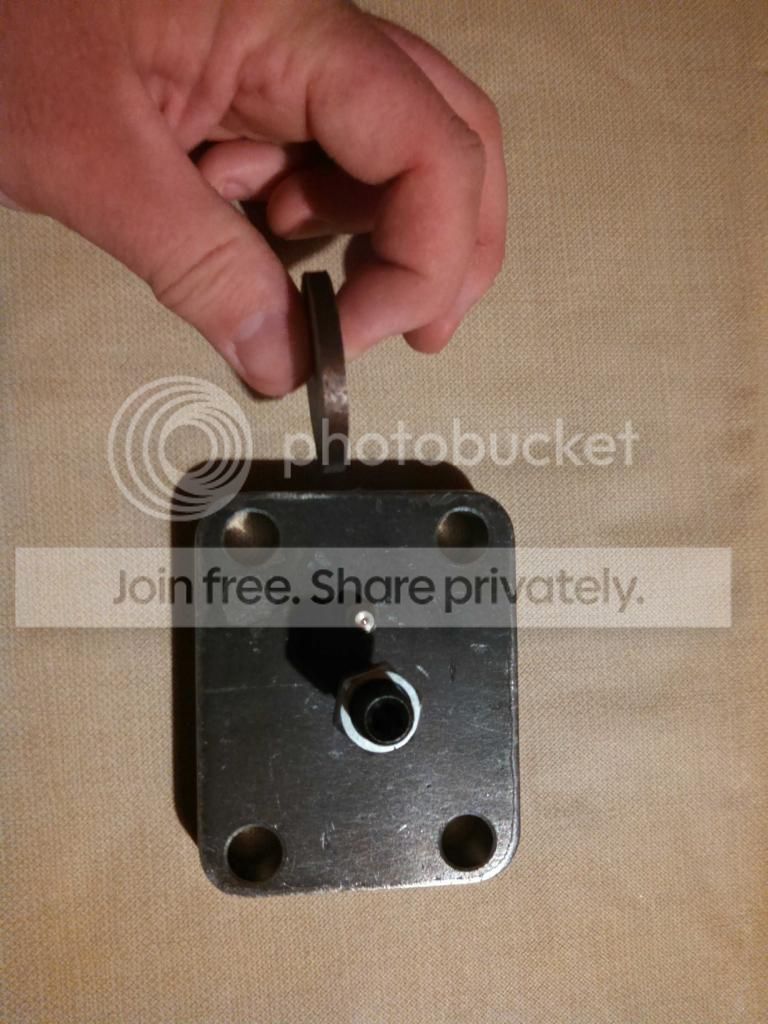

I went out this am and removed the washers, it made a big differance. The tight steering is now a lil snug but way better than before. So i think that did the trick, ill just keep an eye on it and see how it goes.
Ive had no luck with this little swap....the steering sucks still, doesnt recenter all the way and stays slightly turned. Basicly you go side to side in your lane. So like i said before i removed the washers and it was still snug. I removed the eliminators and it still sucked with springs. So i removed it all and used new plastic bushings/springs/retainers and its back to normal. That is until i mess with it more, i ordered 2 springless adjustable caps. Either Im going to put those caps on with the reid bushings or eliminators with bronze bushings.Either way ill give her a try once more. After that its staying stock
A buddy of mine has a shop with a real nice newer hunter alignment machine. It was aligned 6 months before when I bought the mtr's. The camber and toe are all almost dead on what they should be. Also it was done right after this mess this week, nothing changed. The only thing that had to be done was adjust the draglink to bring the wheel straight. I had to turn it in a few turns.( In the pic of the steering arm I put on a clearanced tre) It drives perfect with no shimmys or shakes. The km2's are getting older but the only thing I see is they are a little louder. I have 37-12.50-17 km2's on h2's for winter. They are on November till April. I did notice with the new steering arm it turns tighter than before. The hole location was a little different compared to the ord arm. The track bar and draglink angles are dead on.
I got this thing all straightened out, Started to piss me off..lol. I removed the bronze bushings and sold them, also pulled out the crane eliminators. I bought a pair of 4 wheel supply king pin springless caps. I pulled the cap off of the steering arm and bolted it on. I adjusted the preload with the linkage disconnected, for the 1st 30 miles or so it was a little snug but its real good now. Live and learn i guess, buy fancy not needed parts and something simple was the fix. I changed the tre back to a new straight one, it wasn't needed. I ran out of time to align it but ill get to it this weekend just to make sure its still all good. I cleaned all the grease off of the knuckles and changed the boot on the tre since it was torn and gave it some fresh paint.
