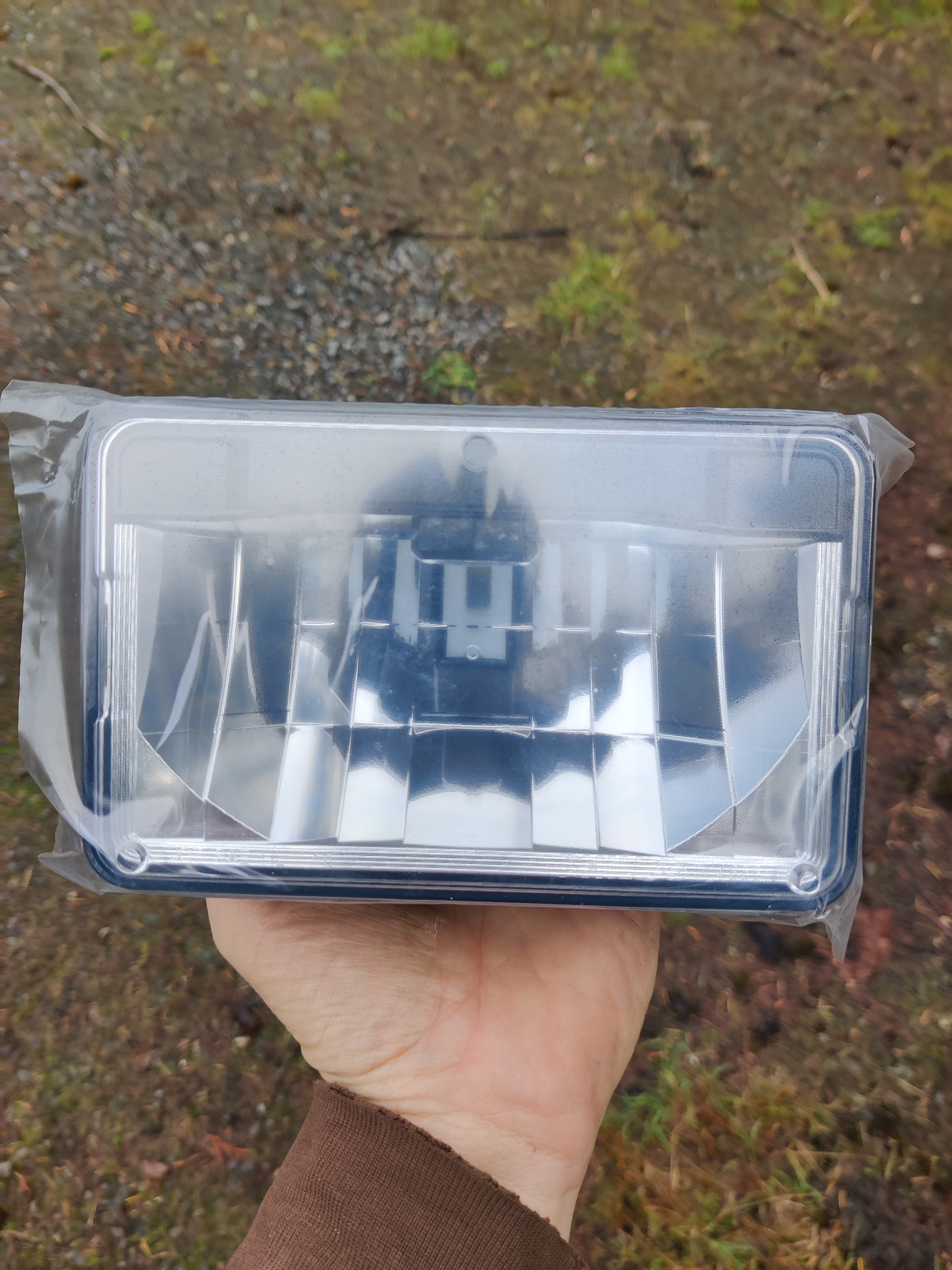

I decided to try out the Phillips H4656 (high/low beam). Bought two of them at $110/each from Rockauto.

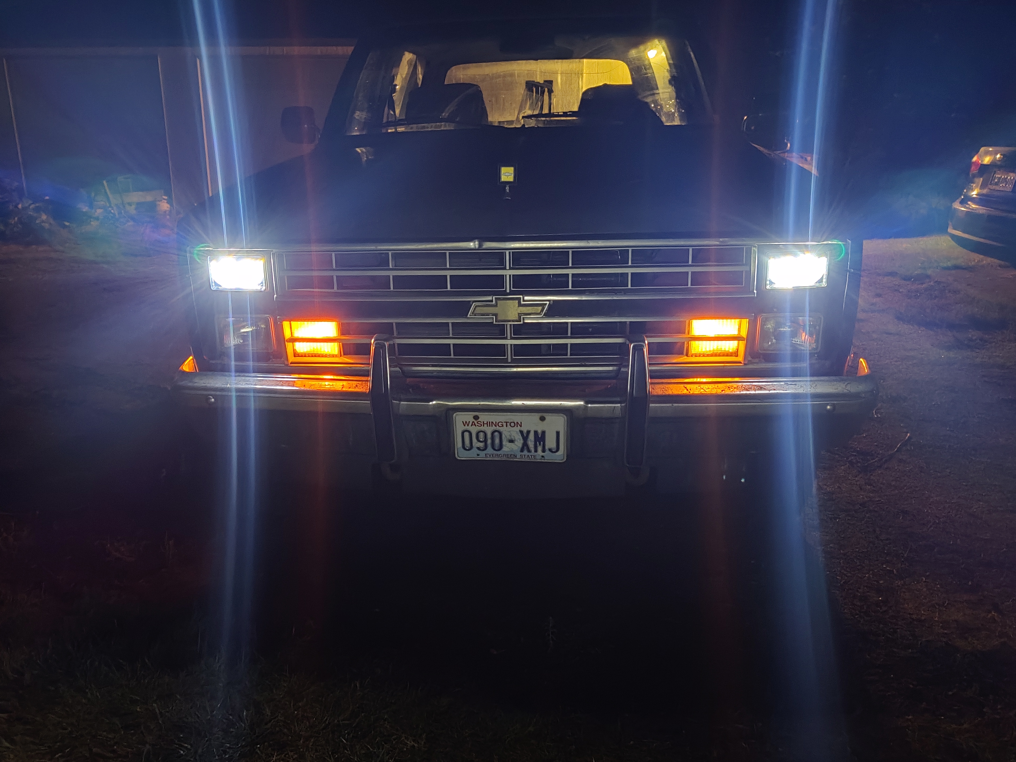

To me, they look better than the lights with a bunch of leds in them. The light output and beam is excellent, very comparable to a new vehicle. They have a sharp cutoff.

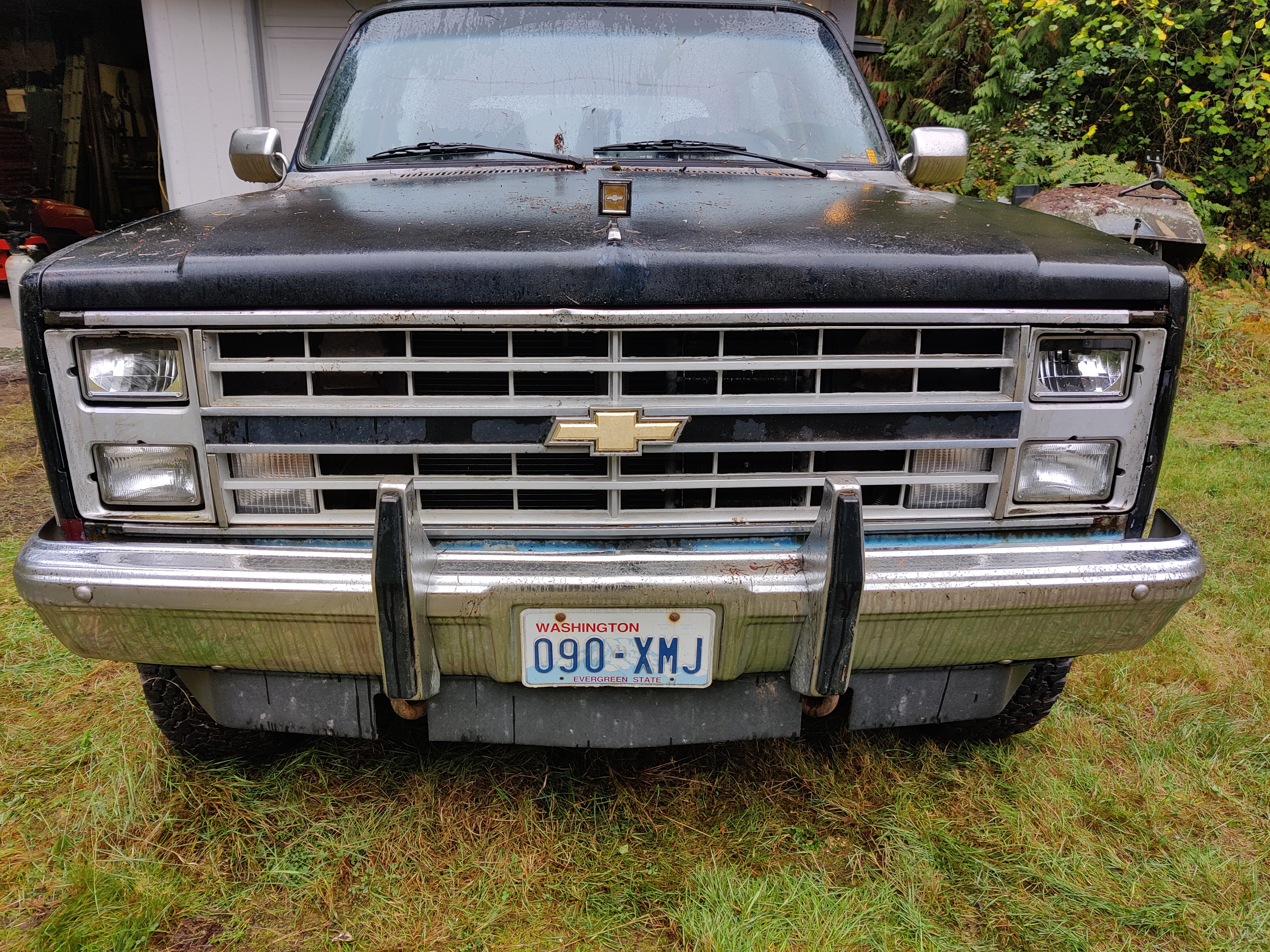

The beginning.

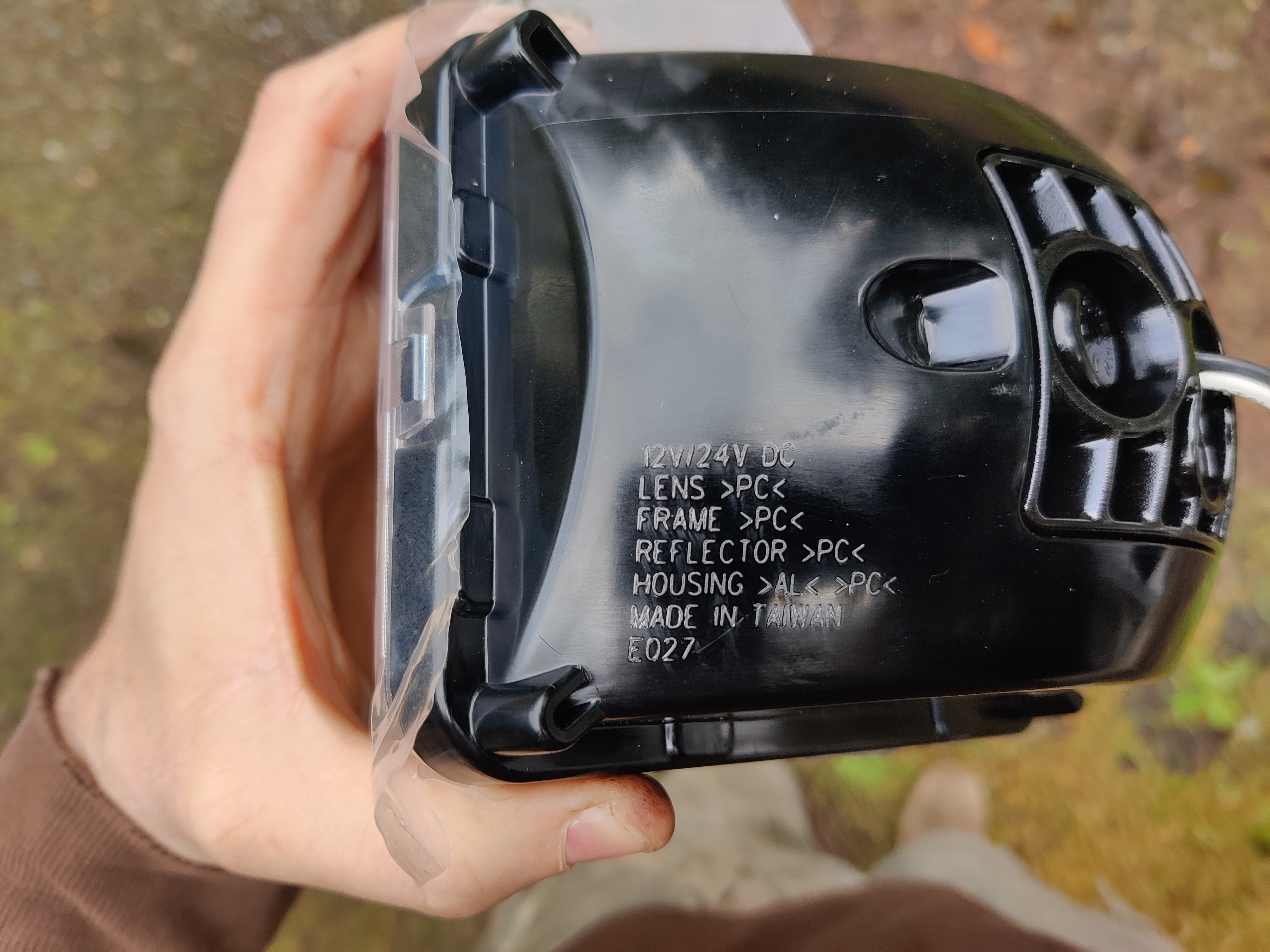

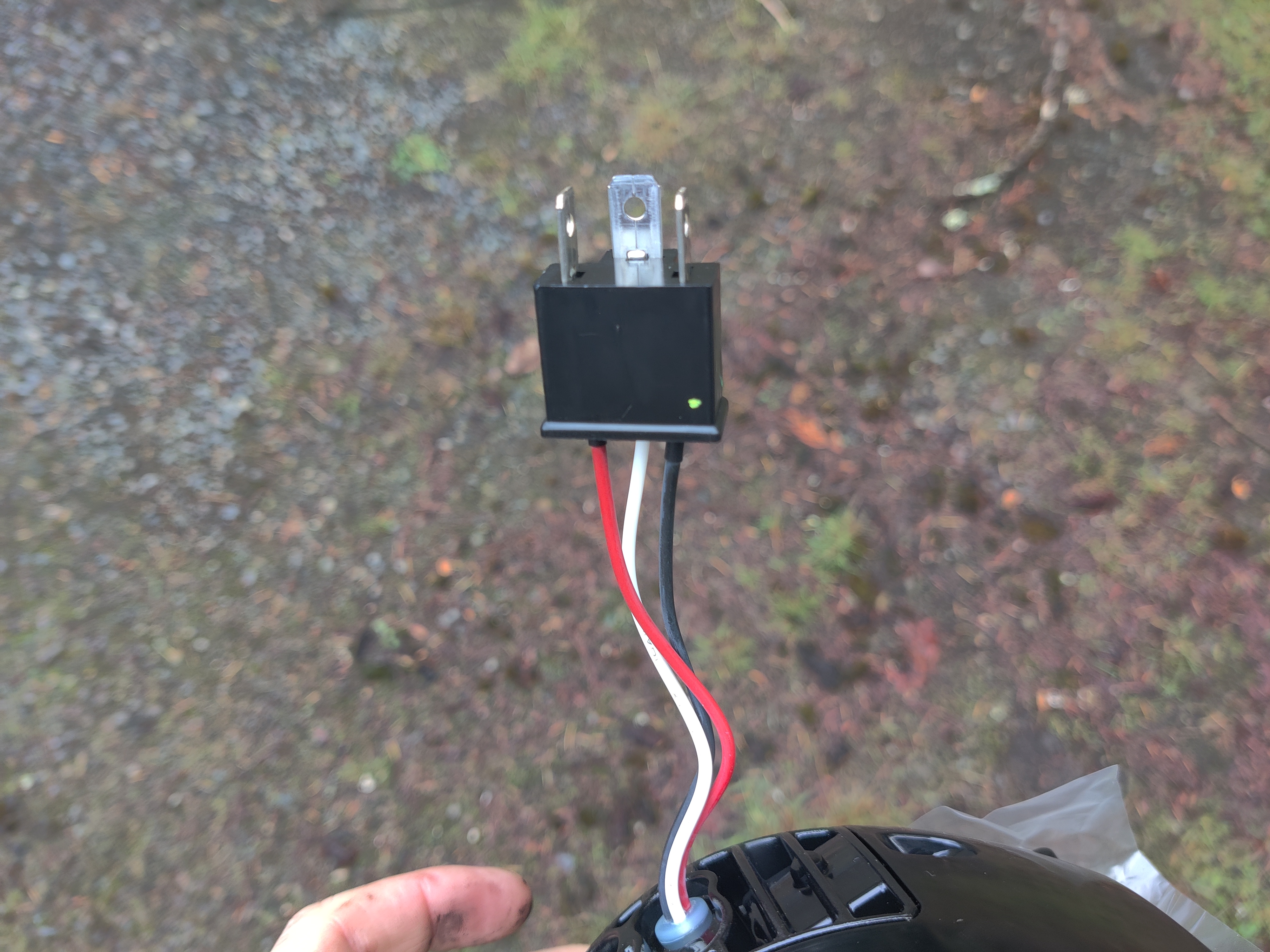

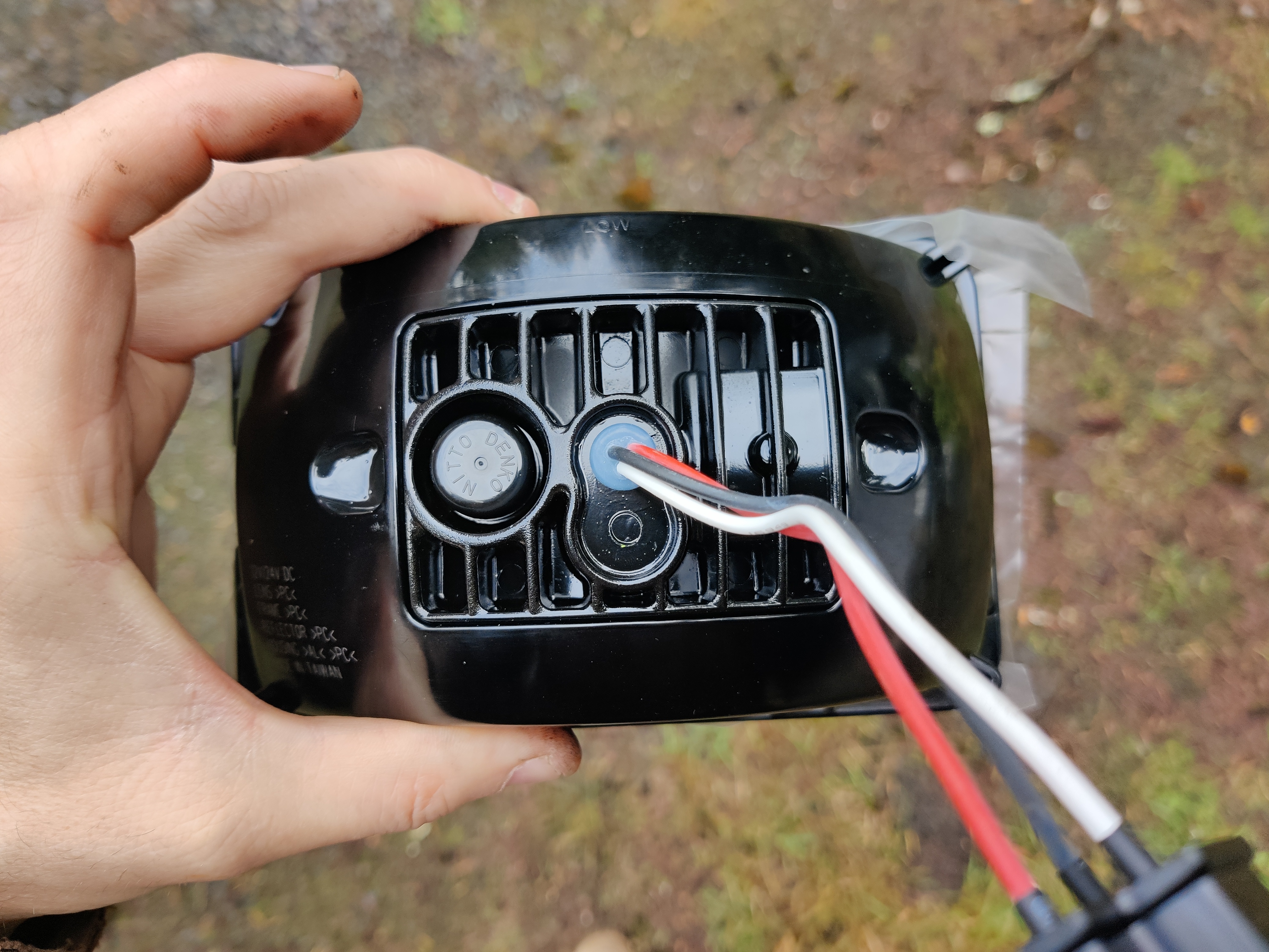

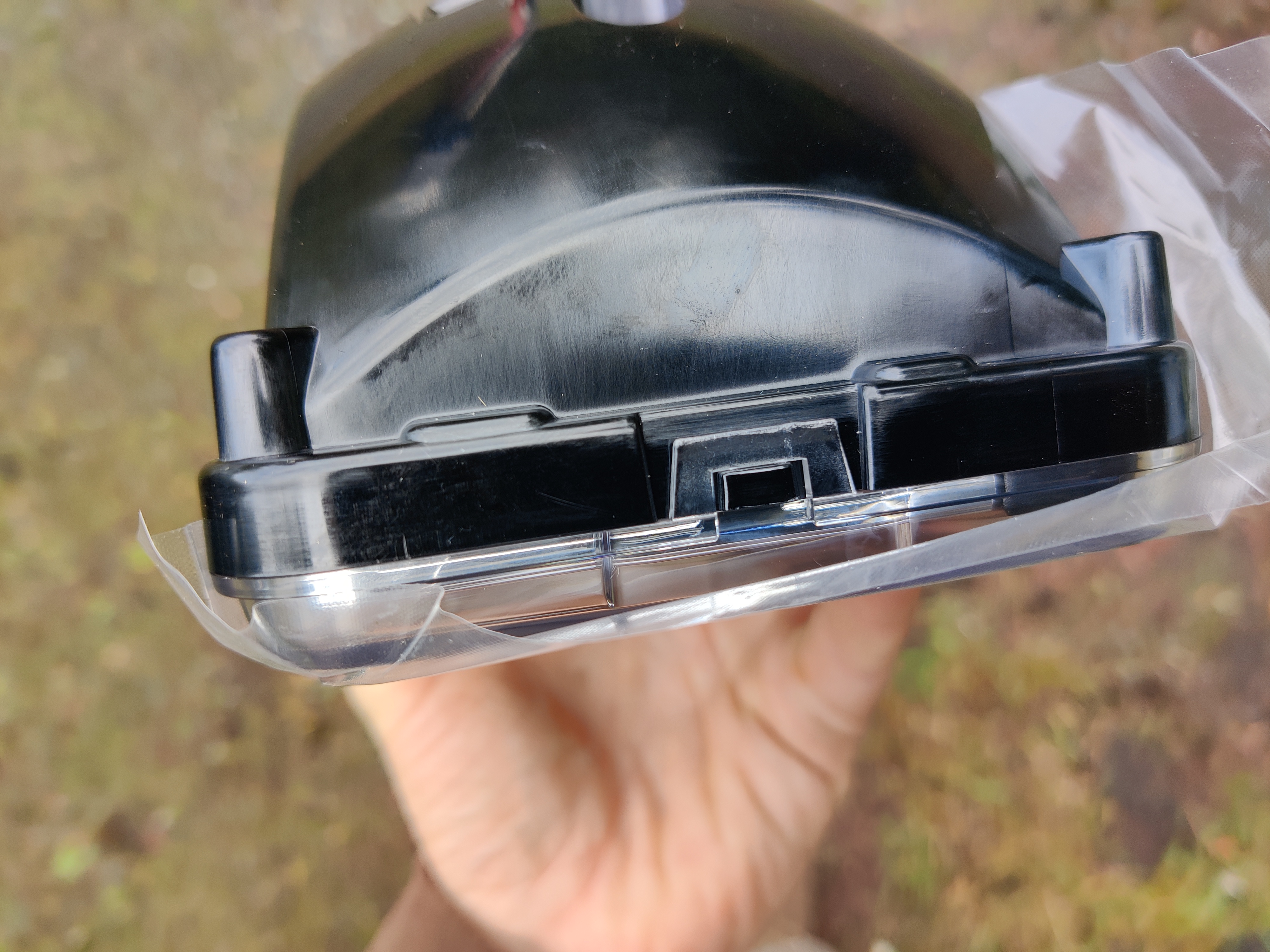

Impressions? Quite heavy. Obviously not just cheap construction. Wires are sturdy. Almost looks like the lenses could be replaced?? Don't want to attempt just to see, but if one gets cracked I will. Everything is plastic except the section that is finned on the back, obviously the heatsink.
Oh, and not chinese.

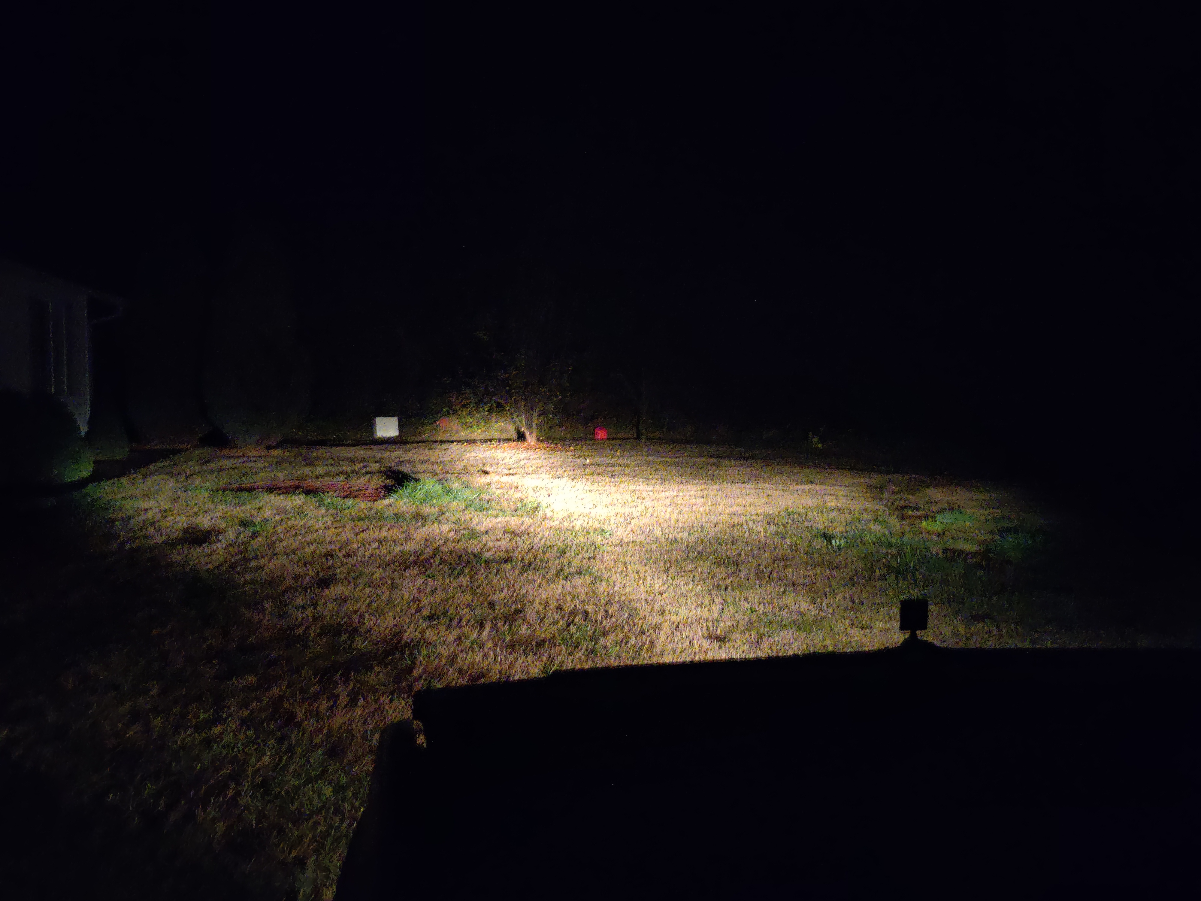

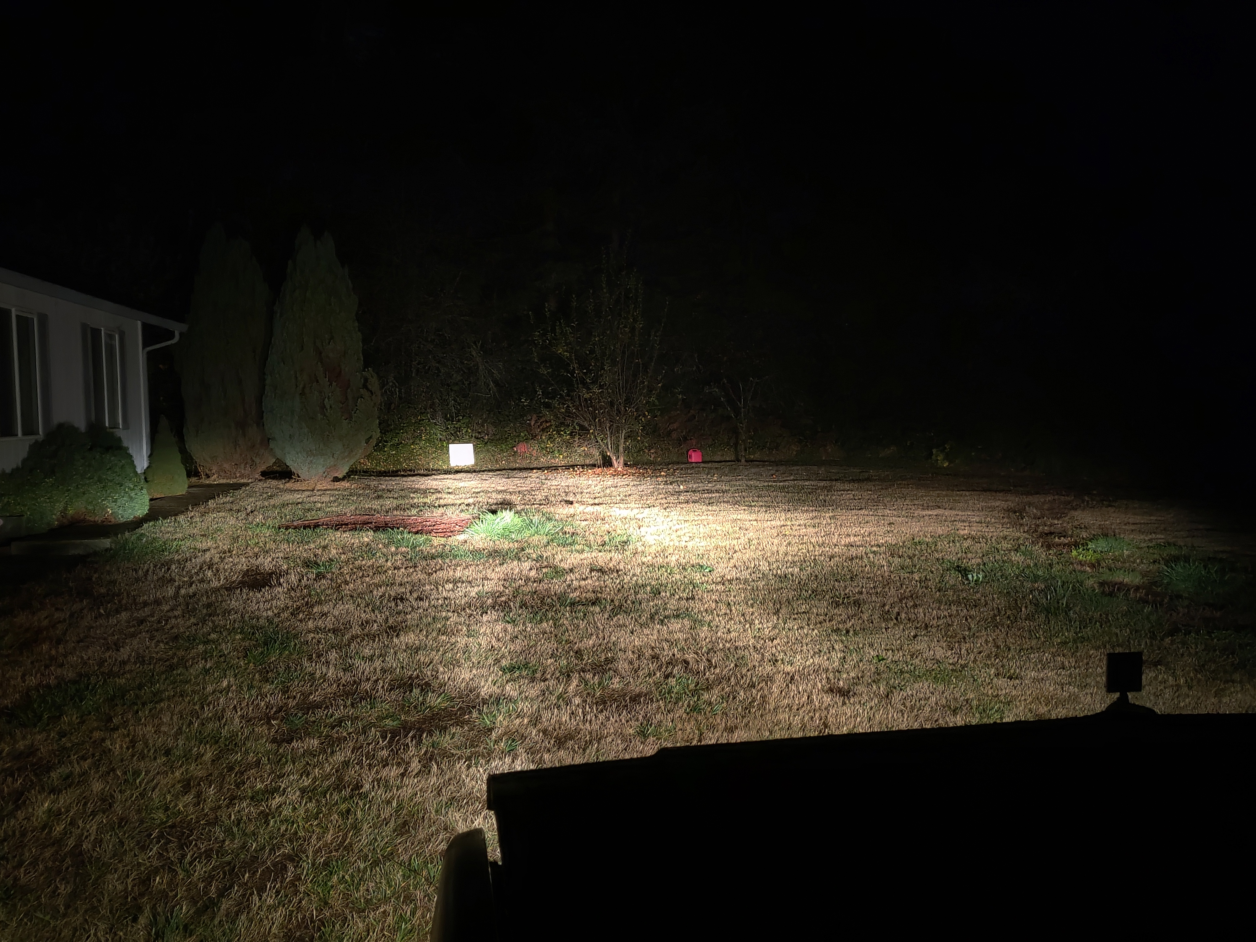

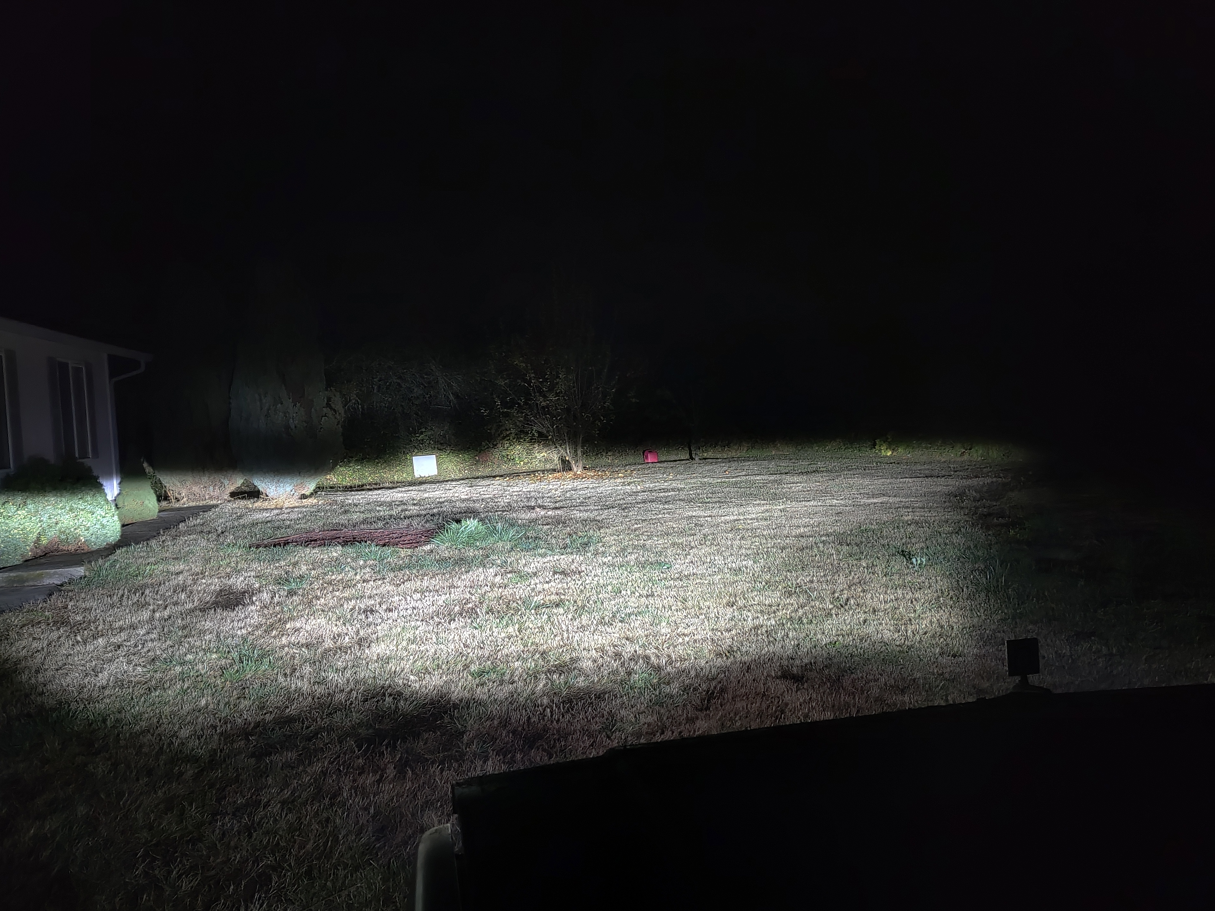

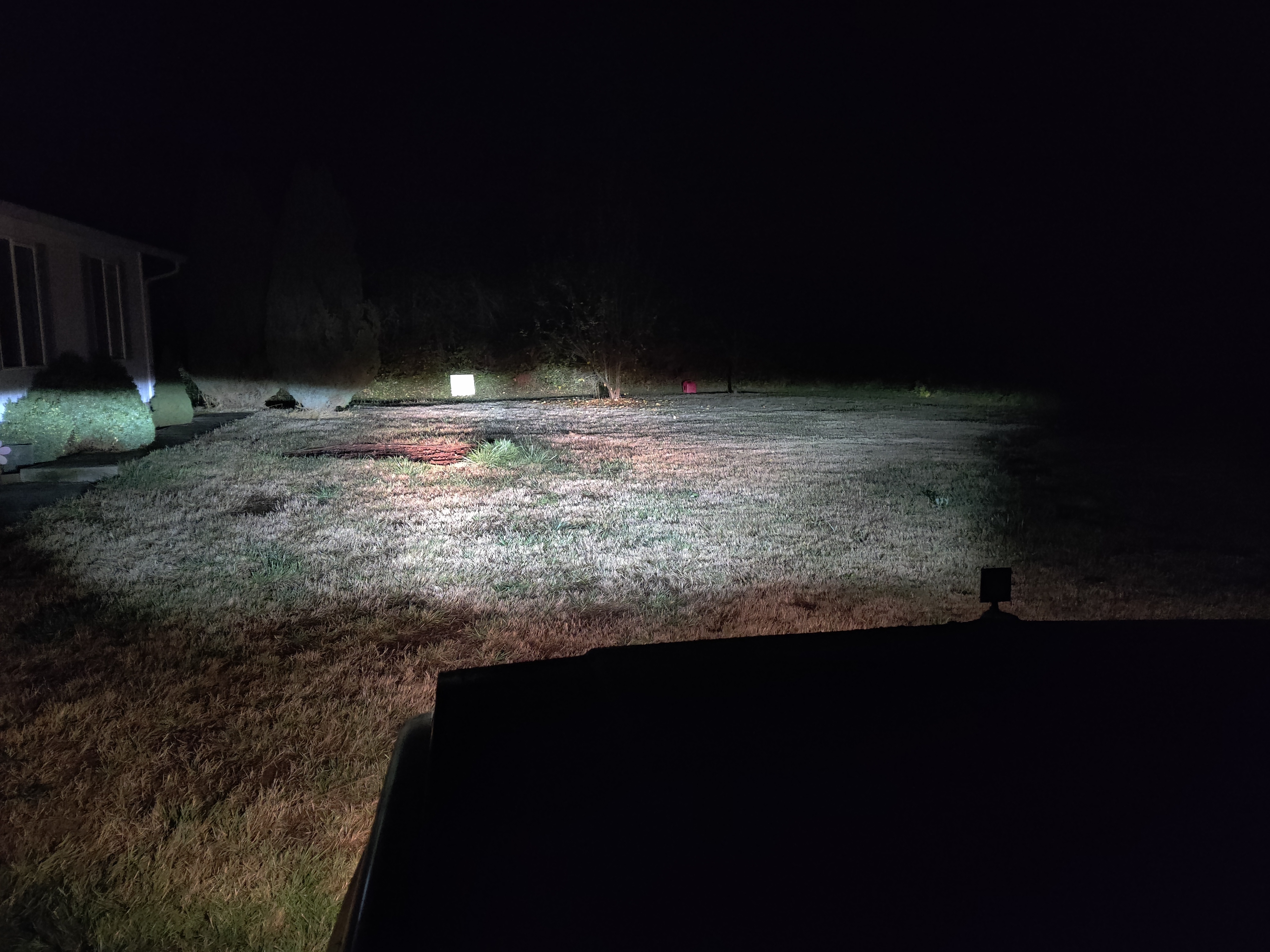

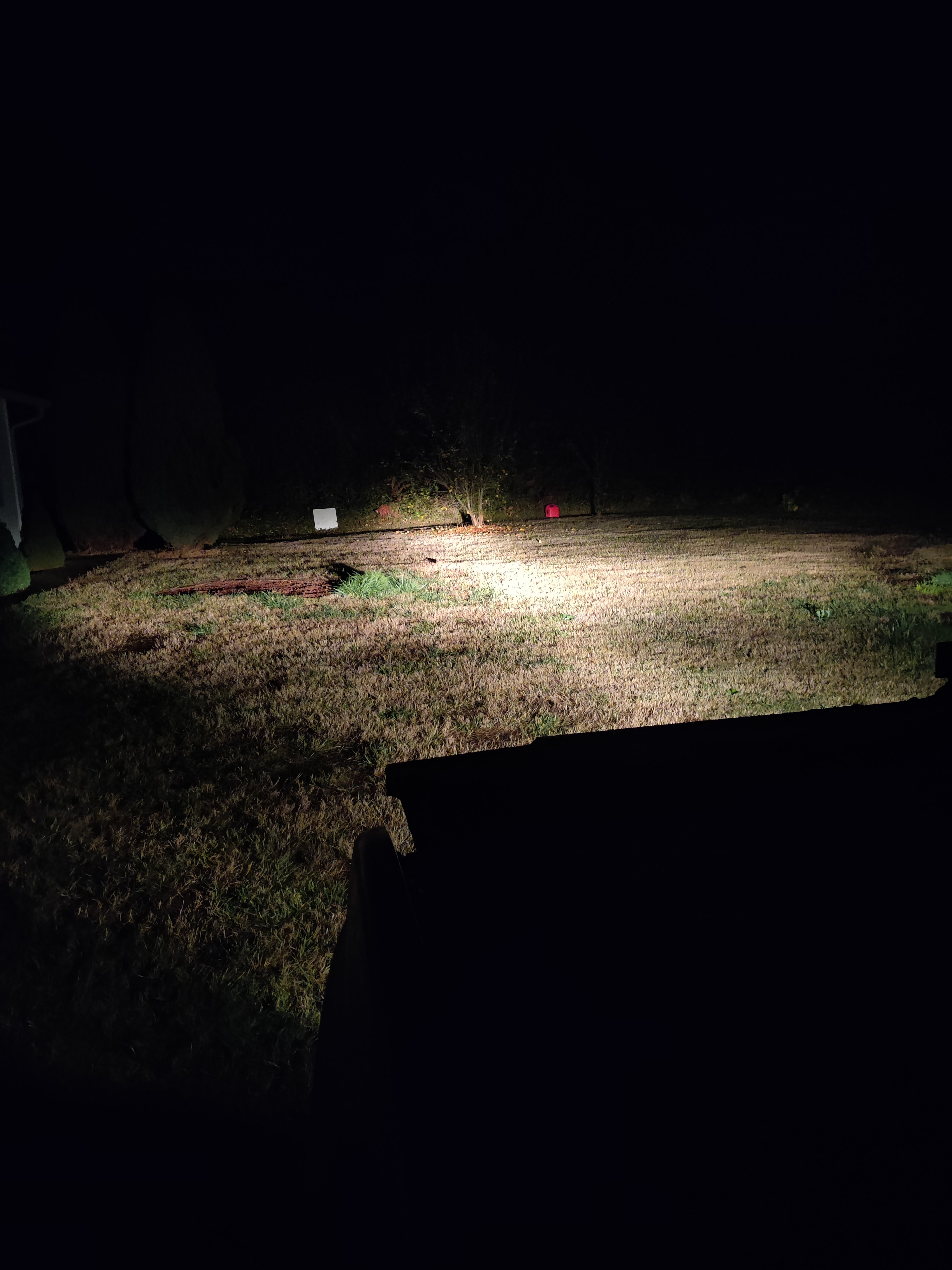

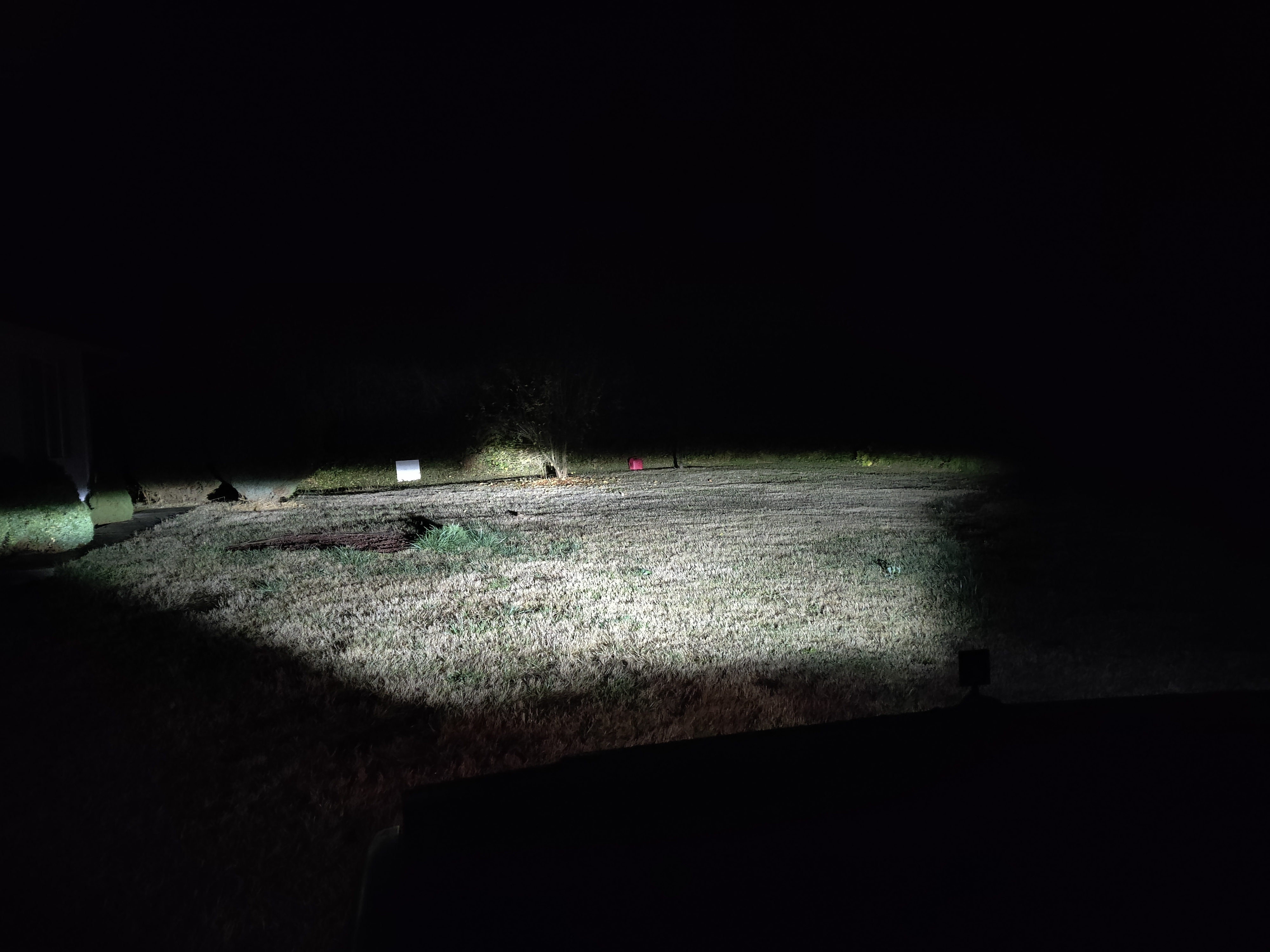

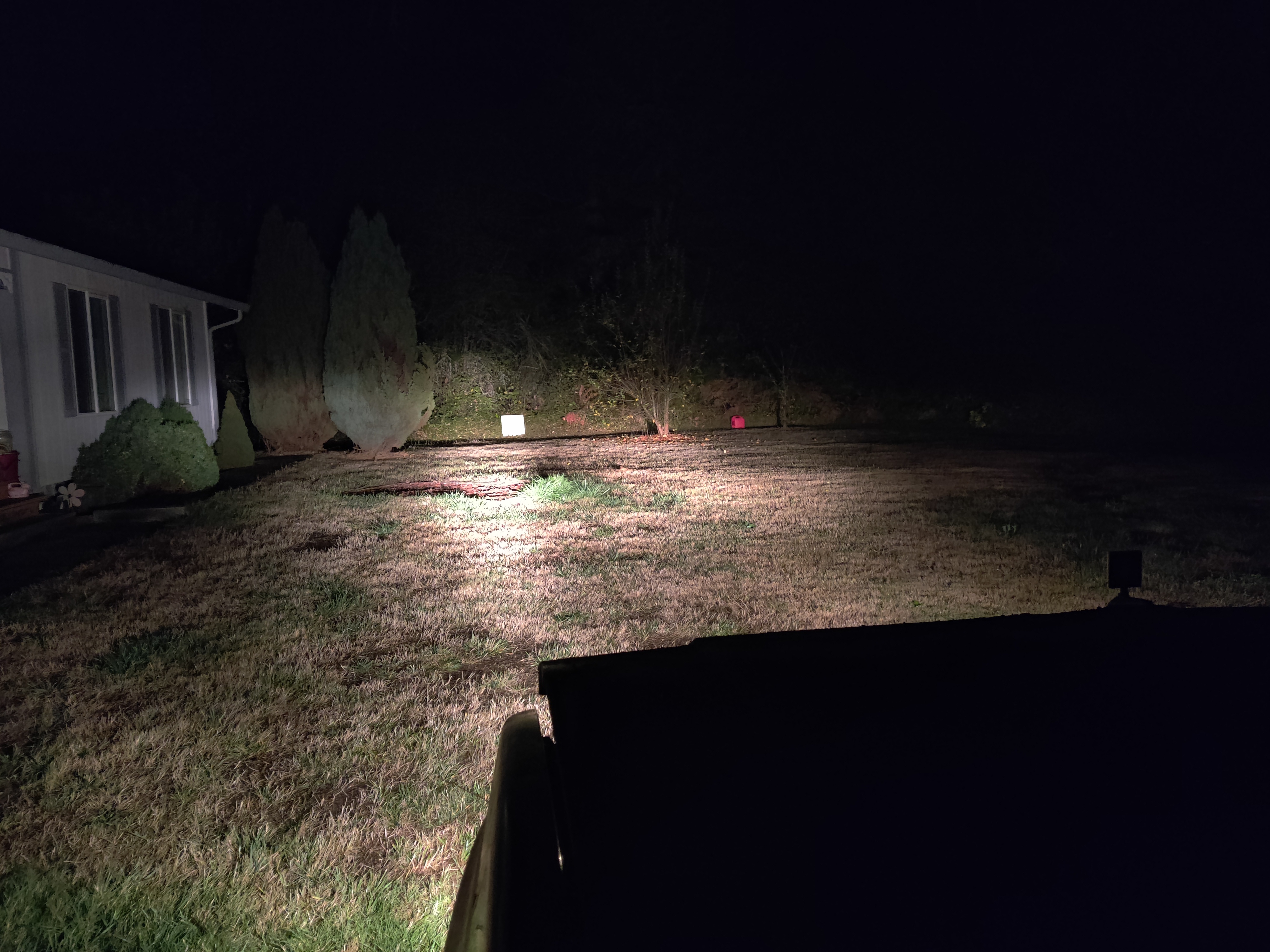

All halogen images taken with truck running. LEDs don't change with truck running or not. "Targets" 60ft out from truck. About a 15ft dead zone in front of the truck that doesn't exist with the halogens. Based on driver position that doesn't matter, except off to the front left and front right. You get no illumination close in at the corners, which would help if you are say, making a tight turn.
Low beam halogens:
full
High/low halogens:
full
Single Passenger Side (PS) halogen low beam, stock wiring:
full

Both LEDs, low:
full
High LED/Halogen:
full
Low LEDs:
full

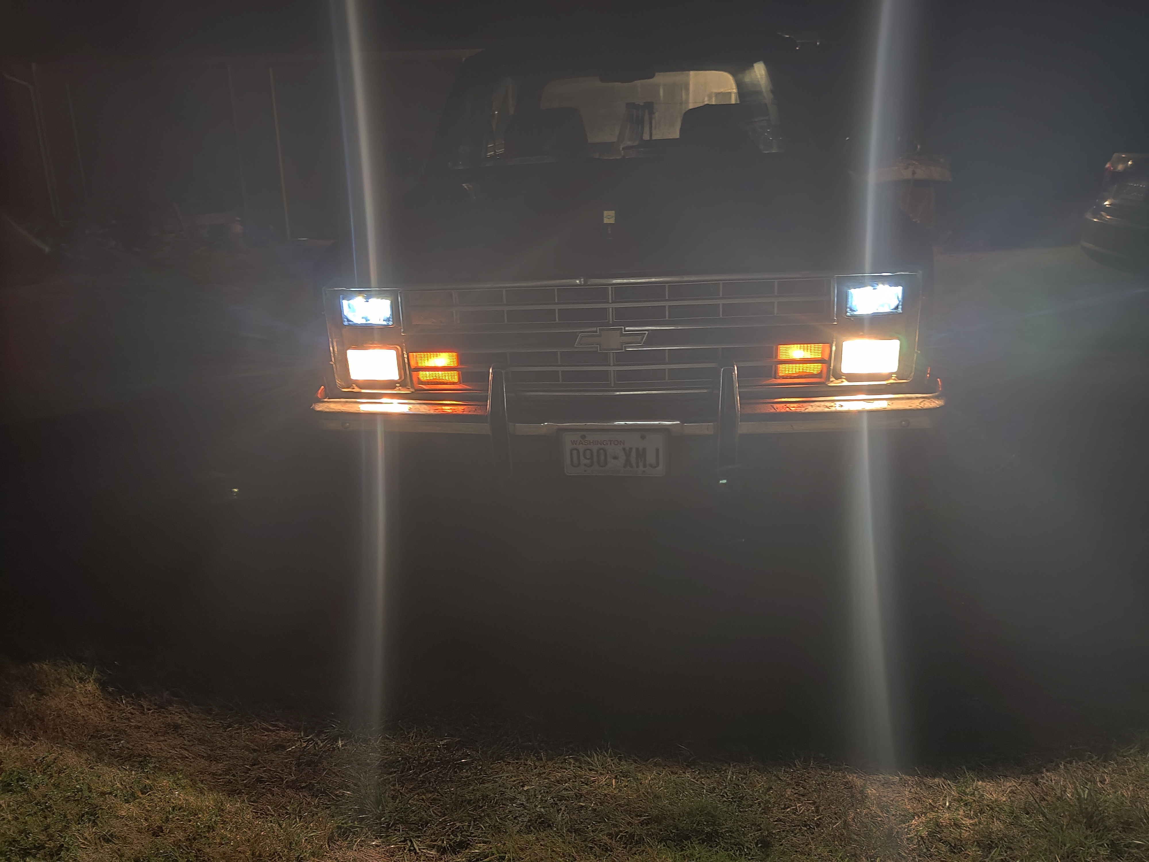

Exceptionally pleased with the outcome. Not completely done, still have to put the headlight trim back on. Have not gotten out to drive with them yet. The factory connectors arent a tight fit, I'm going to depin them tomorrow and figure out how to add some tension to the connectors.
