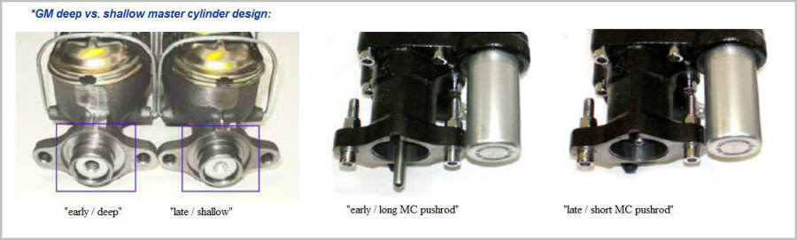

Yep, the correct push rod makes a big difference. There is short and long push rods which can be swapped out or changed.
My issue is I was running a Wilwood master which had issues working with my short rod hydroboost since it went in 1/8" too far in the master. This caused my brakes to lock up after 20 minutes of driving. Only fix was a custom length rod or grind down the Wilwood spacer/plunger so I just grinded mine down on the receiving socket side. Fixed now.
Keep in mind you want a .020 gap between the hydroboost rod and the master.
