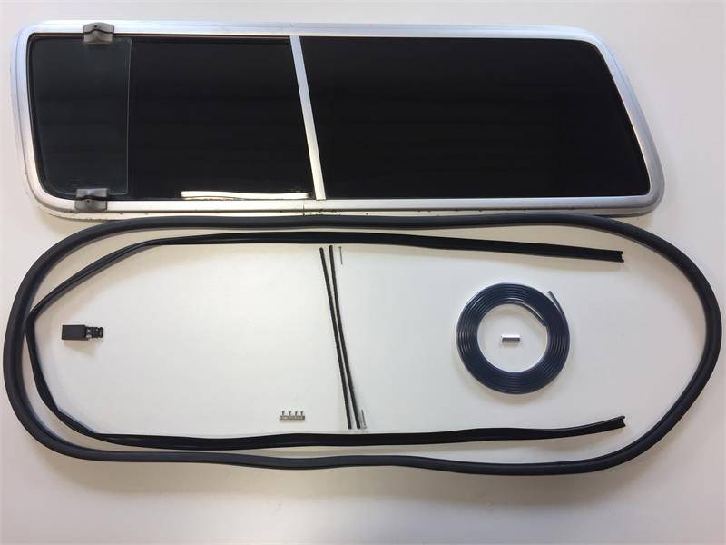

well the Motorcity K5 slider kit is crap and i am out a bunch of money unless he does the right thing and sends me a refund ( still waiting on a reply as to the fitment )
the weatherstrip is not made for this size channel so the glass does not slide worth a crap
had he been upfront and said this was the best he could find but it is not OEM quality I would have just passed on the rebuild kits but now i am stuck with no side windows a hole in my wallet and I am looking for a felt channel that actually fits in the channel properly ( at least this thread gives me options) this site makes it hard to just add pictures from a computer but i will upload some to a file share site so i can show you guys what not to buy

not sure what you mean? the kit i bought is specifically made for the sliders on the K5 it shows the slider in the description ( i inserted the pic from MC above in post #41 already )

So i just got off the phone with MotorCity K5 again
apparently, all the window frames he has, have a channel width of 16 mm mine is just over ten
we are both scratching our heads on this one since I have had my Jimmy for over 25 years and my windows look like OEM with the wings and all we have to imagine there was another supplier in the mix
the kit MotorCity has may well work for most of the sliders but check your sliding channel width to make sure yours is 16mm wide
thanks to Mark from MotorCity for taking the time to figure out what went wrong here
this also explains why the Amazon weather stripping worked for Bob and not me
