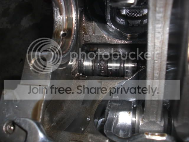

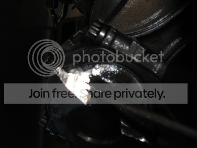

UPDATE.

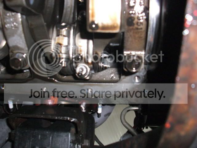

Pulled the motor out, and the first half of the crank also.
I feel CONFIDENT in saying that this is/was a defective crank.
As shown by the pictures, there is only a small amount of the crank that was connected. IE the shiny parts of the metal. The rest, I would assume should have been connected. (save for the oil hole)

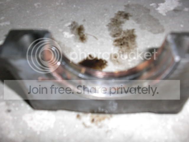

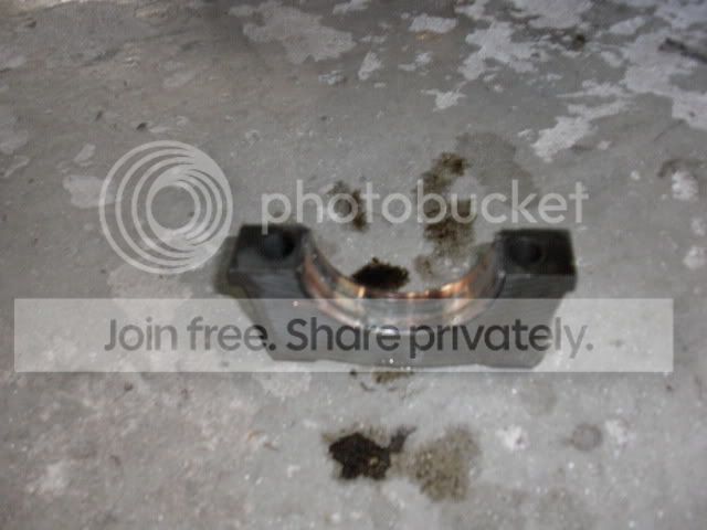

It also rubbed the block/cap. But I'm not sure if it is bad enough to really worry too much about. The most I think it might need is line-bored.
Somehow my cam died?!?!?! The fuel pump cam is flat.:mad:
I checked all of the bolts figured maybe I'm a dumbass and put one it that was too long. NOPE, the fuel pump/plate bolts were from a kit. and the correct size.
Neither of the holes on the face of the motor went in deep enough to even see the push rod?
Weird. :mad:
I guess my next move is to contact Eagle and see whats up.:(

First let me say that now i understand what you want to do and you will still need to rebalance the engine since being internally and externally balanced means different amounts of weight in different locations.
Also, the shiny portion of the crank is a crack that has been there for a while and has been "working" which is why it's shiny. Eagle cranks are not very good, Scat are better but not by much. I have used Scat cranks in the past with no issues even though they are now China made junk like everything else in this country.
