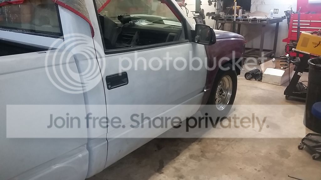

I honestly dont know enough about springs. I need to do some serious reading. The factory truck v6 springs are right around 850 lb/in. Today I put in some 2000 chevy v6 springs that were 750ish lb/in and the damn truck looked like it had a lift kit in it... Ironically the springs had very similar free heights so I kind of assumed that the truck would have come down further with a similar free height on a lesser spring strength but apparently not so much...

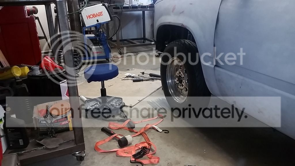

I just threw the towel in and put the damn drop springs I had from before in it. Changing the coils 3 times in 2 days sucked...
But at least it sits how I want now...

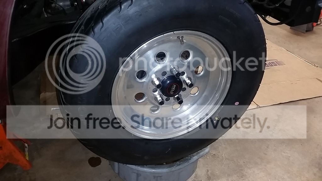

Threw my center caps on, whoopty do lol.

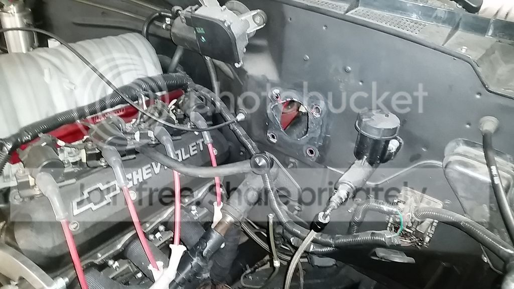

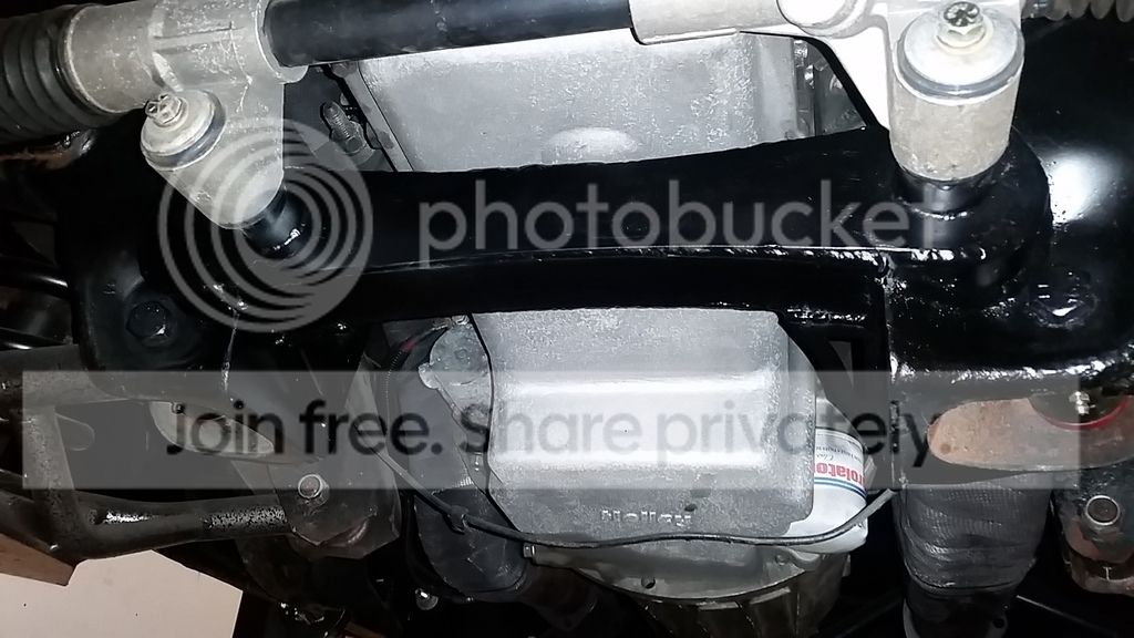

I also cut the piece of tube out of my engine crossmember and boxed the rack crossmember out. It bothered me everytime I got under the truck that it looked like a cluttered mess. Like one was done after the other with no regard towards tying them together. So fixed it.
I also wanted to do that so I have a place to mount the front brake line that crosses to the pass side.

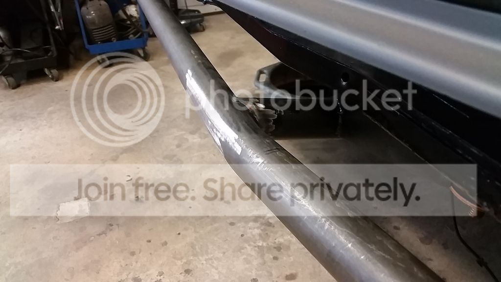

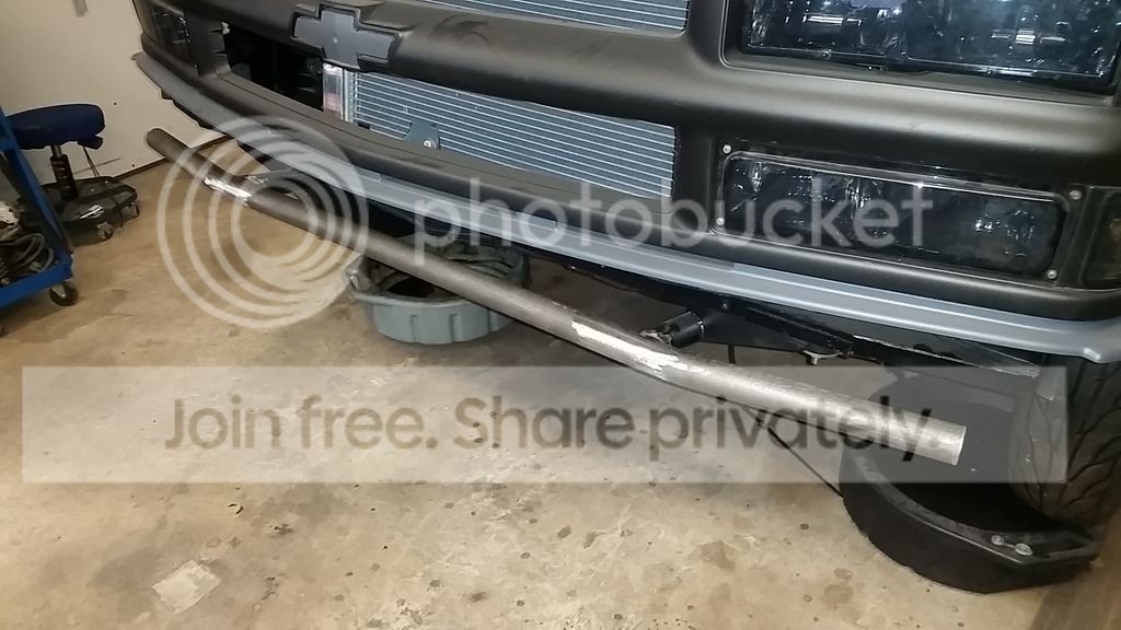

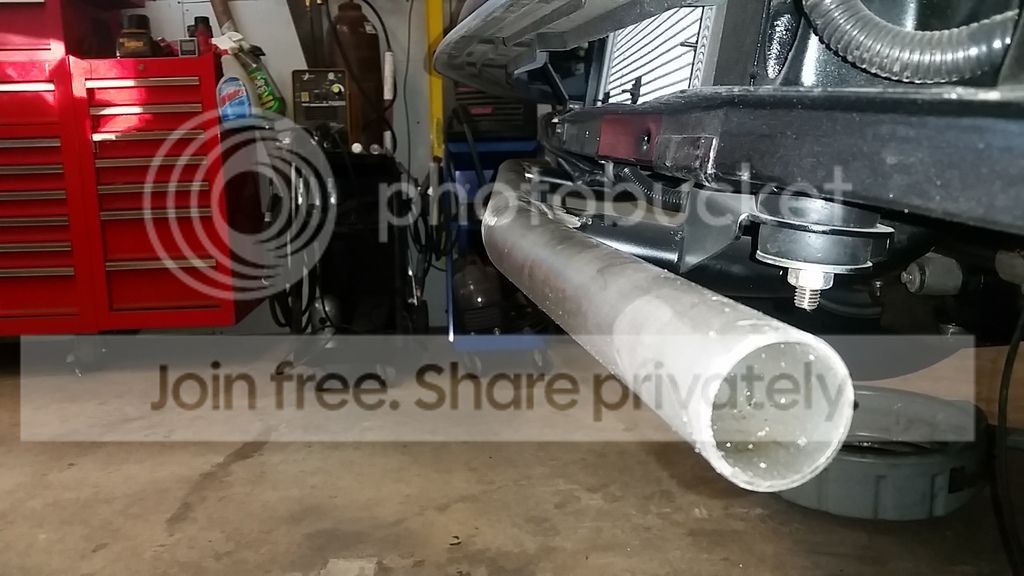

I put on the front crash bar and took pictures of it but my phone was a dick and is just corrupting all my photos now, so I took some again and it did it again...

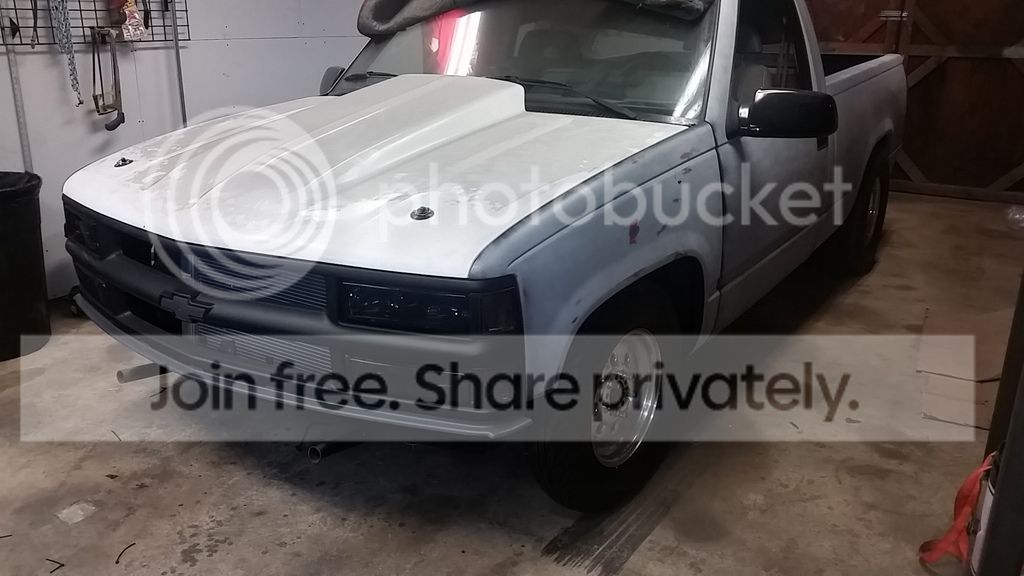

Gonna order up the front glass bumper soon. Lots of side work going on so thats a good thing.
