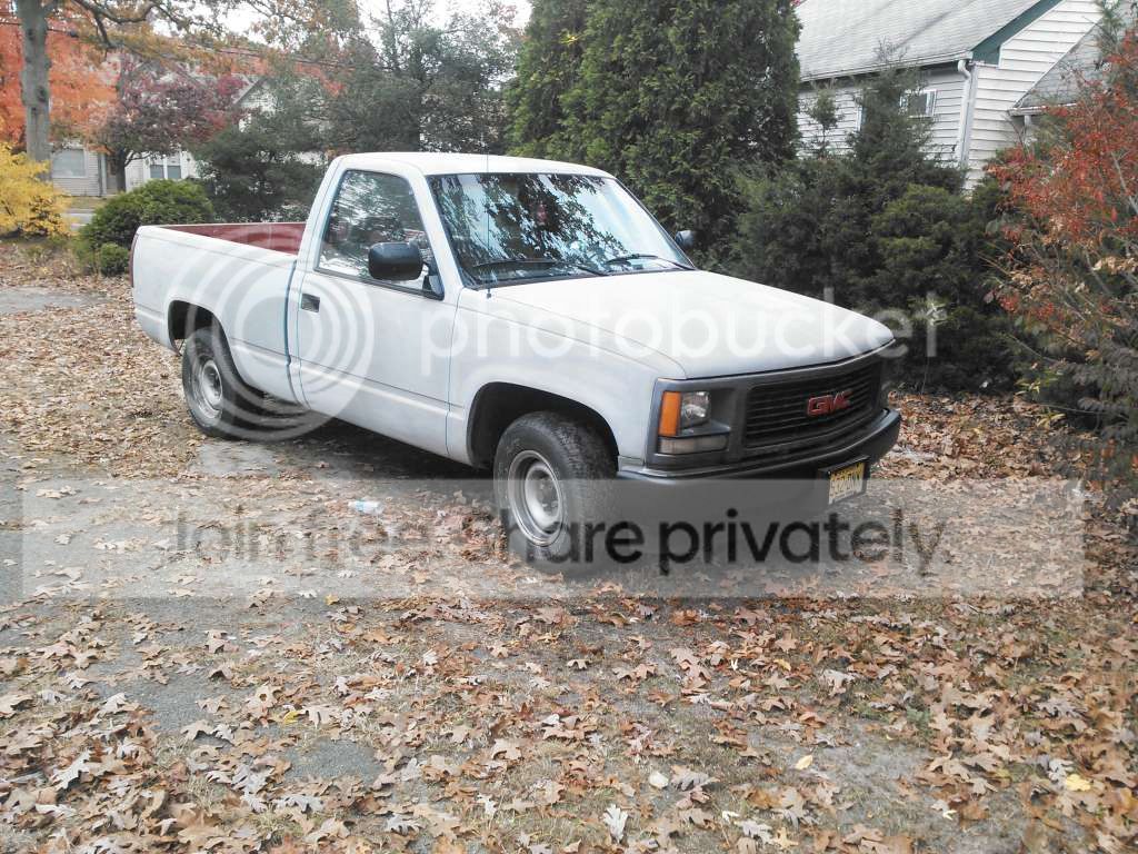

So Ive spoken of it on here but never really elaborated. I bought a 90% done project from a guy on craigslist. Specs as follows:
Originally was a 1994 GMC sierra C1500 standard cab shortbed 2wd. Base model with a 4.3 and 5 speed. So the guy I bought it from gets his hands on it and does a lot of decent work to it. Paints the frame, straightens the body out, primes it, and most importantly throws a VERY health 355 in it.
So I buy it like this for $2400. Figure I test drove it and it drove well so I'll drive it home the 1.5hrs.

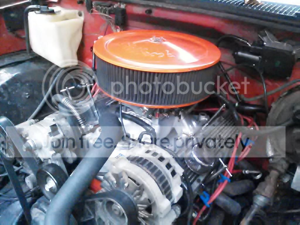

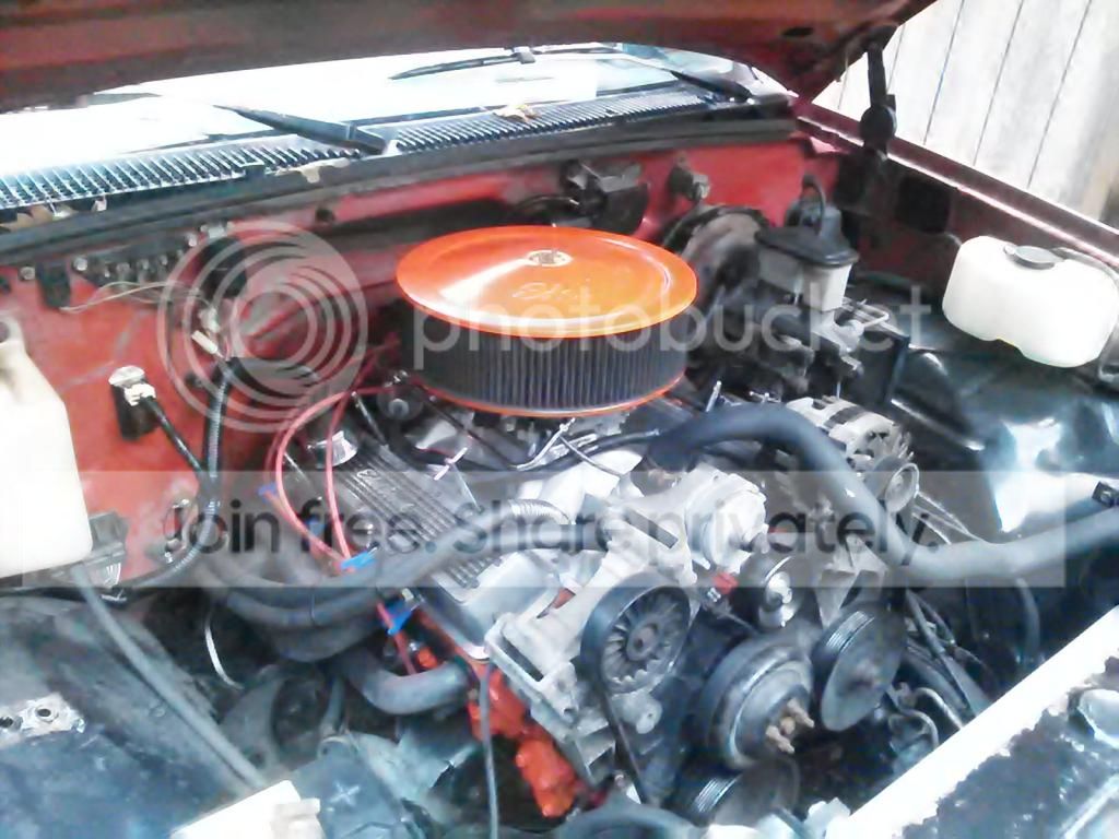

Did my first tuning work on a carb ever... Changed my squirters from 29s to 35s ,my primary jets from 65s to 67s and my vacuum secondary springs from a stiff fuel mileage stocker to a purple performance spring. I never played with a carb before. I had no idea there was so much to change beyond jets...
Its running way better and Id say I picked up even more on the bottom end. No more stumble when you jump on it from a roll.

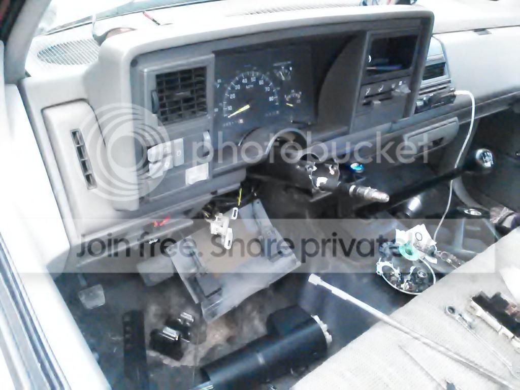

So I spent the day at the shop working on the truck and the wifes car. Changed the oil and retuned the idle on the carb with the new jets/squirters. Then I went on to tackling the wiper and ignition switch. Lovely mess of dropping the column and taking it all the way apart...

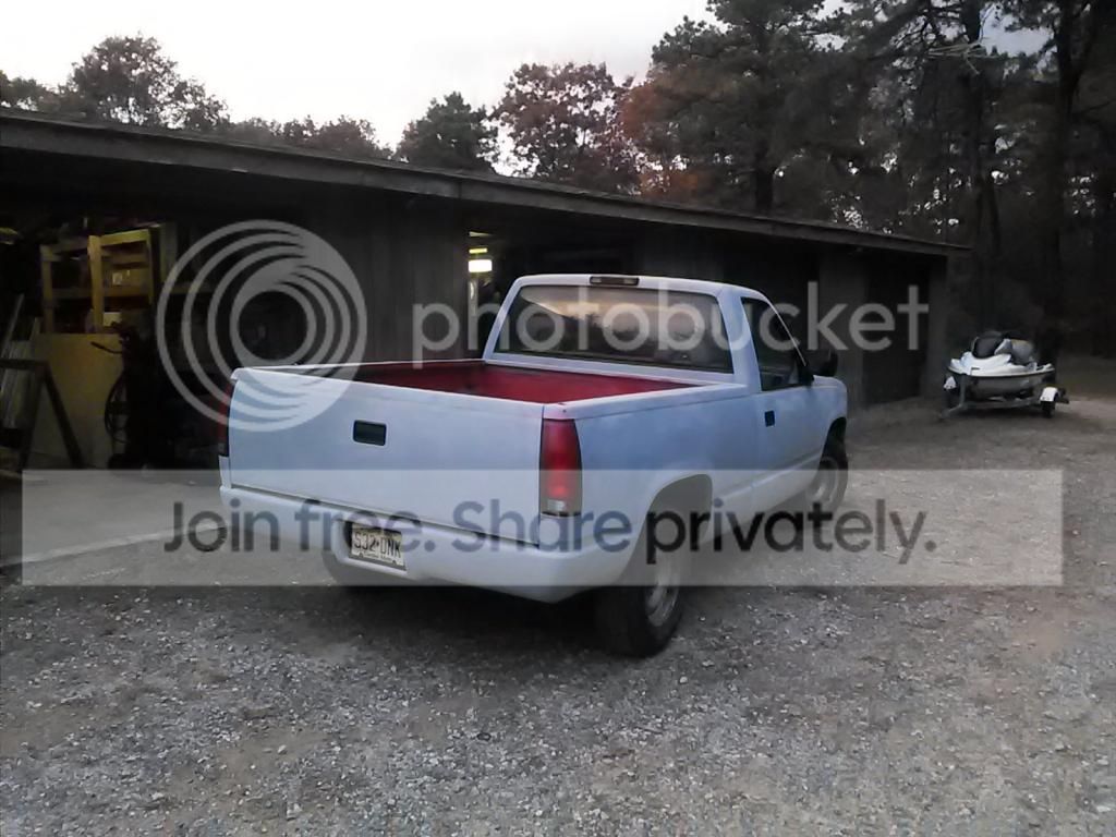

Snapped some overall shots of how the truck is sitting right now.

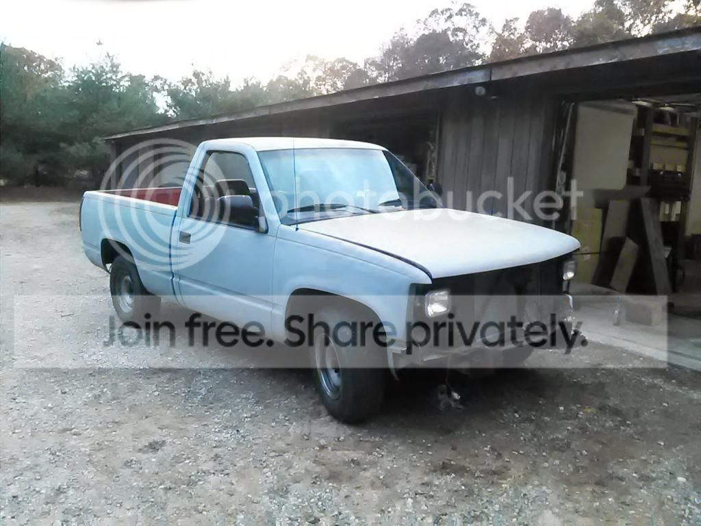

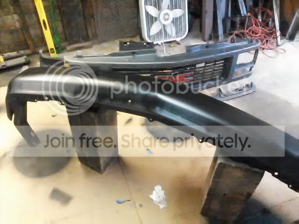

As you can see the bumper and grill are off. I had to wait for the wifes wheels to dry and I had some extra plasti dip so I got to work on that front bumper. KILL THE CHROME!
Gotta put it back on tomorrow morning. I almost painted my existing grill black to match but I really wanna get an early composite light chevy grill at the junkyard. Im planning on painting the hood, grille, bumper, and tailgate flat black and doing the rest of the truck gunmetal grey.

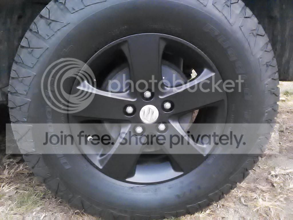

Heres the wifes wheels done in plasti dip.
Sorry for the **** pics on the last post. I screwed with my phone camera settings and didnt realize it degraded the quality at the same time...
I put the bumper back on this morning. I love plasti dip just to say it again. I cant wait to paint the truck with it this spring. The bumper came out great. Unfortunately it doesnt have the eye popping effect I hope it would but that w/t grill just ruins everything. I gotta get my hands on an early Sport style grill and shoot the grille and hood to match the bumper.
