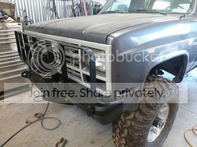

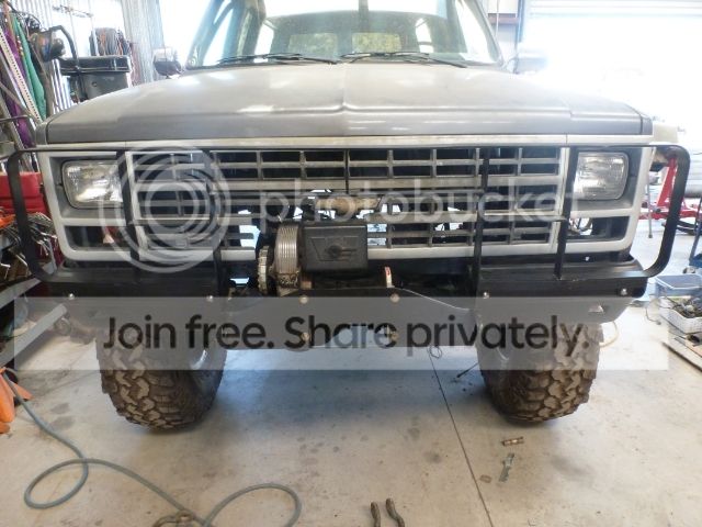

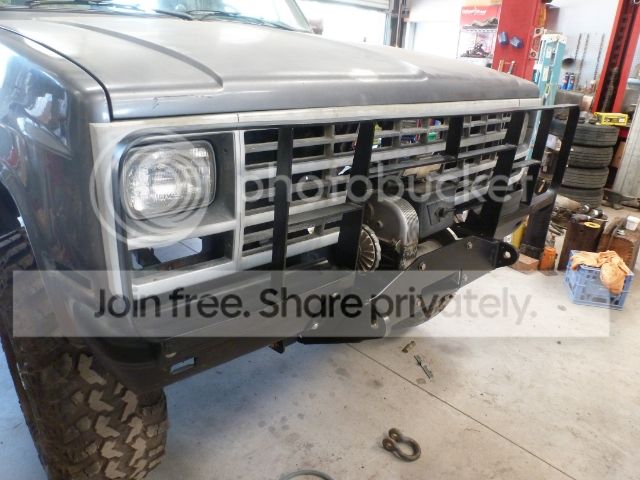

So today I tried out the bumper and guard that I built for my other truck, what do you think do I make this work or build a tube bumper.
I need to raise it up do to the 1" body lift.
I have an idea for a cucv rear bumper as well.

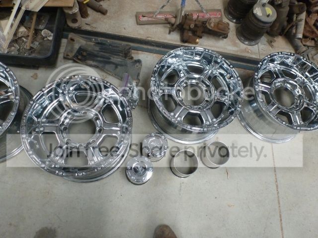

Since I sold my Irocs and H2 rims I have been looking for some new to me rims.
I found these pro comp 17x9 rims on craigslist and got them for a killer price and I was going to spray them with plastic coat, until I cleaned them up and they are perfect so I think that I'm going to put these on my Silverado.

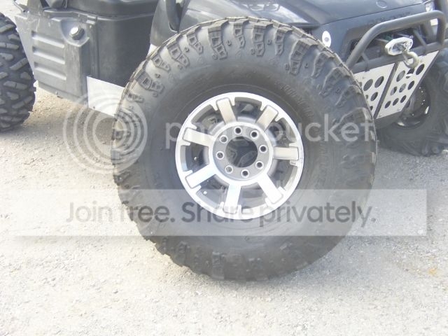

And put these H2 rims on the burban, remember these are going on the new 37" Nittos.
How hard do you want to hit stuff?
The cucv bumper is good for bumping, but it you want to hit rocks, I'd be cutting the flanges off the fenders and building something strong and high clearance.
I plan to de fang the front fenders and angle cut the bumper, right now I'm trying to decide if I like it, I think the skid will take most of the punishment.
Definitely a craftsman at work here. Wow, that looks sooooooooo nice! I'd love a Burb with that overall length. The CUCV bumper and center winch cradle are nicely blended too. It looks like a heavy duty Burb the should have been made by GM right at the factory.:waytogo:
Even my tna wings mounted to the cucv brush guard push in and allow body damage. I need to reinforce them with some triangulation back to the frame. The body on that burb is real clean. I'd want some more protection. These trucks also seem to like to clip trees just where the marker lights are.
Due to the body lift I plan on mounting the guard to the frame and then mount the bumper to the gaurd after I cut and reinforce them.

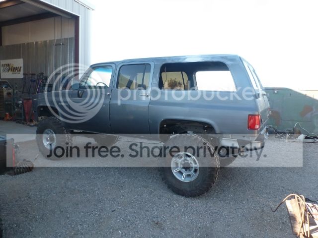

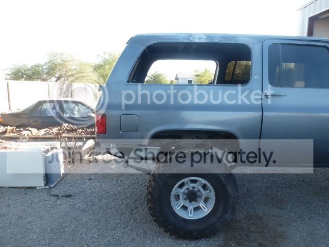

Had a little time today and got the body work wrapped up on the 1/4 panels, inside and outside, for now its blocked out to 80 grit primed and painted with some rattle cans and the roof is almost blocked out as well.
Also installed the new 31 gallon fuel tank and cut down the skid plate, time to start working on the bumper and cutting some windows.
