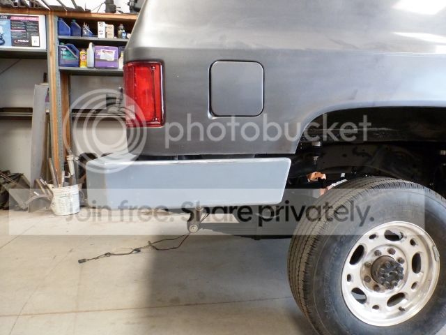

Also decided I really need to clean up the shop and start selling some parts so I should be back to work on the bumper this weekend.
I would recommend bringing the pieces of the bumper under the 1/4 panel out at least a little. The added protection there would help when the rear gets in a notch would be helpful.
I've wiped out two passenger side tail lights now in parts of the trail where that simple little piece of steel would have saved them. You've got a good bit of work in those 1/4s, is hate too see you wreck them. My next bumper will have more protection there.

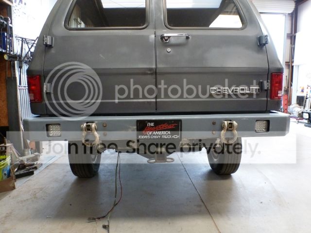

Well between work and Christmas I was able to find some time to get some work done in the shop.
Still need some paint and to wire up the LED lights.

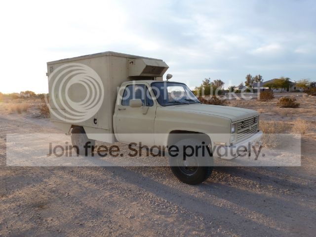

I should be picking up another CUCV ambulance this week, it has a strong running 6.2, K case turbo 400, 208 that I will be swapping with my 205 and the best piece, a Gear Venders overdrive along with more one tons and misc. parts.
The 6.2 will get me running till I can build my 6.5 turbo engine.
are those CUCV shackles sticking through the bumper?
That is a badass pic...hell of a job on the chop job. :bow::bow::bow:
Thanks to everyone.
Yes I will have a very pampered set of one tons for sale and yes they are cucv shackles.

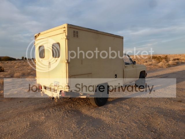

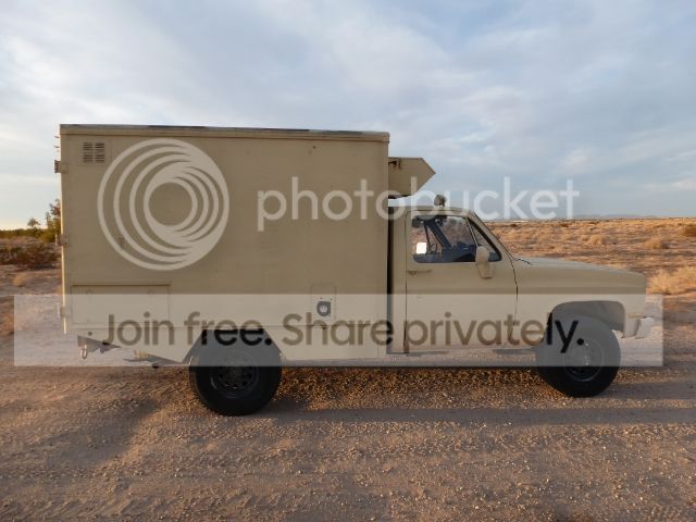

Picked up the cucv today, no pictures of the parts yet, with any luck I will get this parted out and the engine, trans, and t case in and running soon.
I could her a tiny gasp or was in a communal cry of all the east coasters knowing you are going to party that ambulance out. "The metal, it has no holes.....":D:rolleyes::rolleyes:
