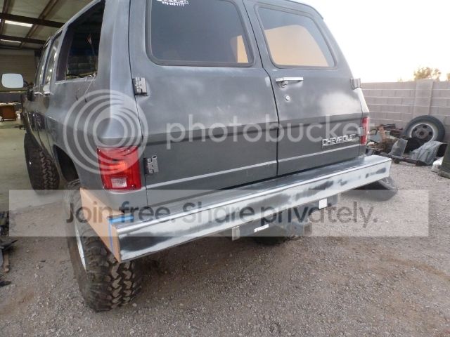

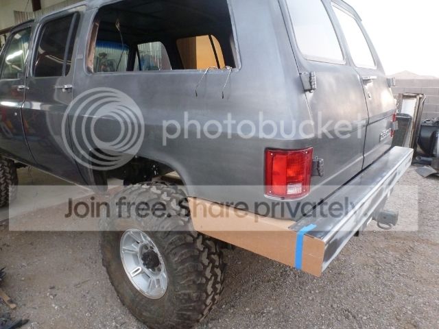

Started working on the rear bumper today now that I have the body work done for now.
Cut and tacked in the hitch, found some 6x6 3/16 square tube and cut the back out to go over the frame and tank.
I will be using 3x6 3/16 rectangular tube for the wings on the side.
I have some D rings and mounts from the cucv rear bumper.
As you can tell I'm using the most advanced CAD design.:D
So.... you shortened it only to add six more inches back on it :confused:
I think it sticks out to far, but that is my .02
You could pull the hitch and weld a receiver into the tube. I'm sure you've considered that already.
bumper does make a nice step. simplifies roof rack loading if you go with one.
Since the hitch sticks out 3" past the fuel tank I have the bumper the same distance.
A stock step & tow bumper sticks out no farther than that one...I see nothing wrong with it...
But then,my mail box is made from the same 6x6 square tube,(5/16" wall !)..so maybe I'm biased...:rolleyes:..so far no baseball bat or M-80 has phased it!..
I would say yo put the receiver tube in the bumper, but his fuel tank is pretty vulnerable back there, so the hitch might be okay.

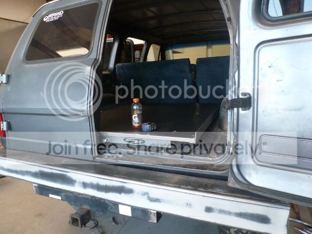

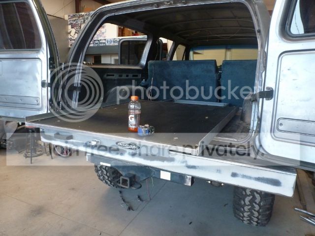

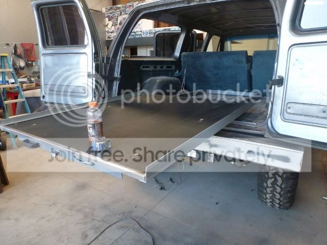

Got a great deal on C L Saturday and with a little cutting here and there and its in, I still need to drill some holes down the side rail so that I will be able to tie down anything that I put on the slide.
it holds 1200lbs but I don't think that I will load that much.
It will also make a great table or bar.:D
