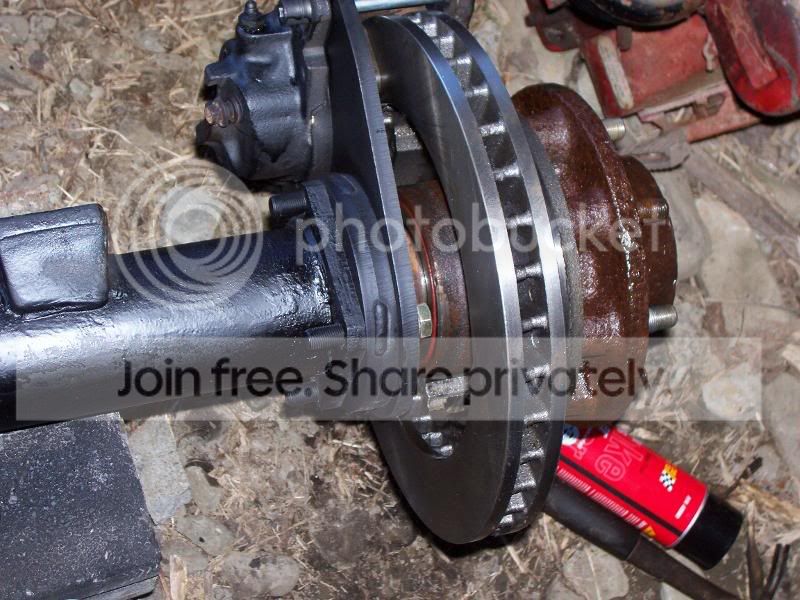

Is it just me, or do these look difficult/impossible to bleed? :confused:
Look how the spring perch sits in relation to the bleeder screw. When the axle is in the truck, the bleeder looks like it will be horizontal, pointing to either the front or rear of the rig.
