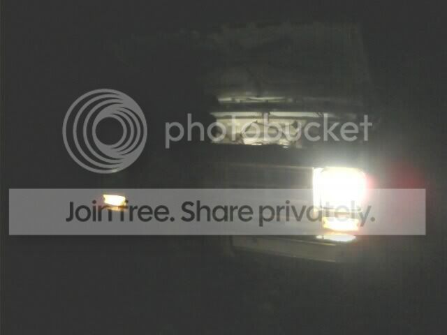

Off subject of the tires, but how am i supposed to have a running/driving 4x4 and only 1 working headlight?
Pics or its not real right :D light underhood is dads flashlight.
