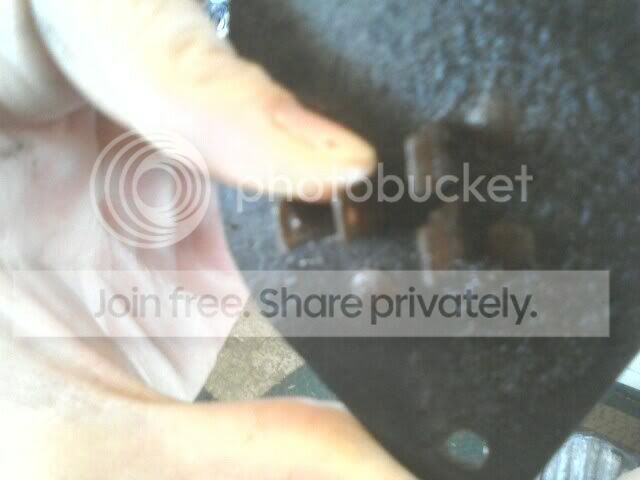

Alright guys, on this heater deal, replaced the old blower motor because it was almost seized up. But it still barely spins, but does get warm. We jumped from battery to heater blower and it spins nice and fast. We tried jumping the resistor but it still didnt change the speed, could it be the switch? or what else can i check. Some resistance readings i can check for with a tester would be nice to have for reference.
The defrost vents dont quite open up enough, but thats a vacuum problem, and ill be searching under dash for why they may not work right. Why cant everything be simple like my non ac truck :rolleyes:
Replace the resister on the heater box. Thats was did it for me! Well, when I had a stock heater anyways.
bypassed it already, no change.
Theres also a 20amp fuse right above the heater fan fuse i think, in the area, that instantly blows when keys on. I dont know if its ac related maybe thats causing the problem, needs more investigation. Will do after i get out of class tomorrow.
Well dad figured out why the heater wouldnt blow on high, it was the rhiostat (spell check). Hers got a new one coming in for it. So that solves one of the issues.

When i cross these two, the heater fan works on high, but even with the new rhiostat it still only blows on low. We think its the switch, we have a new one ordered gonna get here tommorow. What a PIA the switch was to get out!
Edit: soaked the switch in some silikroil, played with it some more and it was the switch, the internal contacts must have a problem, but have a new one coming in the morning.
And the accesory fues didnt blow when we took off the cig lighter line, so theres some problem in there that needs to be sorted out.
new fan switch fixed everything! :D
