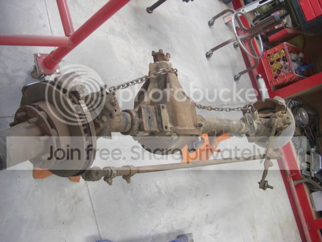

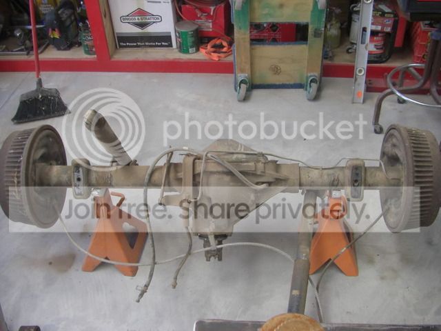

Im swapping out a set of one tons that I got out of CUCV 1031 with factory lockers both front and rear.
The frame has been striped of all brackets, painted and the rear axle and installed with a set of 56" springs and a DIY4x flip kit that I got off CL.

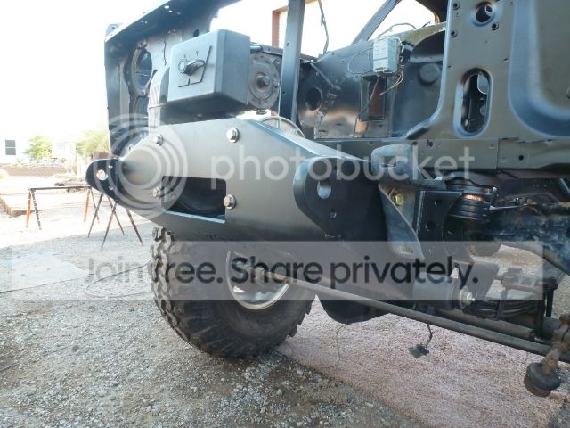

Painted the front axle and 52" springs and bolted them in, feels good to have a roller, cant wait to get my DIY4x Abomb front end kit.

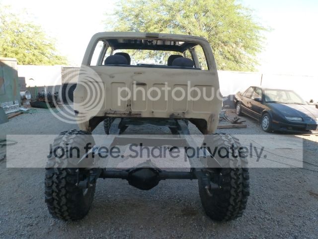

Here it is with bed on.
Well it looks like I have some more cutting to do, as long as I have room for my batteries in the lower boxs ill be happy.

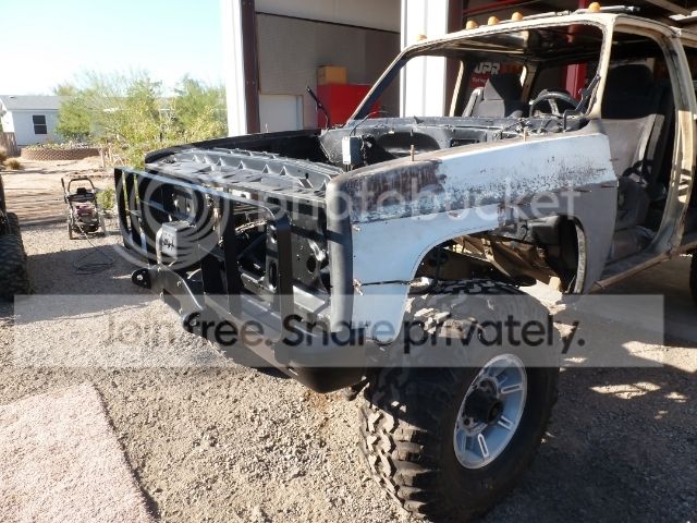

Got some work done on the box, I bent up some tube and sliced it and notched the rear to slide over the box sides and create a fender.
Once I get the rear of the box done on the other side I will remove it and put the cap on the front of the boxes.

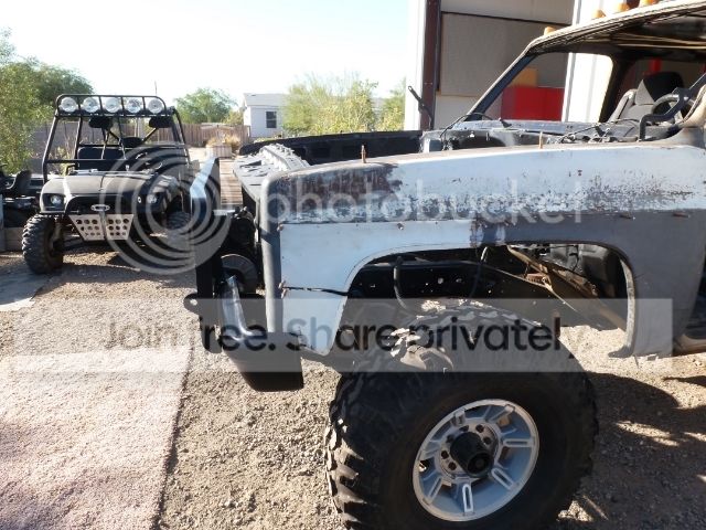

I did get started on the front fenders, with the 52" springs up front and 40" tires I had to make some room.
Moved the fender well up 2" back 1" and forwad 2".
So what do you think.

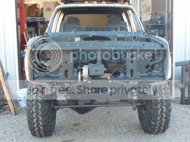

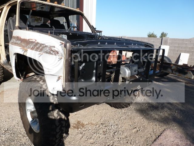

The best part is that when I got home I found a bomb on my front porch, not just any bomb a DIY4x A bomb front end, cleaned it up, painted it and put it on the truck.

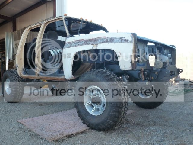

I also found some H2s on CL. and got my tires mounted up and put on the truck, it sure is nice to have some real tires under it for a change.
I got some more work done on the bumper, it's off a cucv that I had some time ago, what do you think of it?
I need to do some cutting on the ends, anyone have some ideas or pics ?

just a fyi better check the front axle .
there not locker equipped. its a trac-loc light duty posi . not even a power-loc the heavy duty one .
