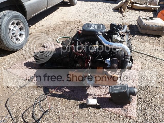

I picked up my powertrain, it's a chevy 6.2 diesel with a Gale Banks turbo, turbo 400 and a 205 transfercase, now to get it cleaned up change some gaskets a few parts and slap it in.:D
