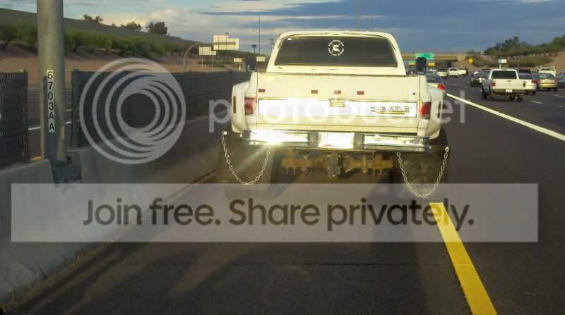

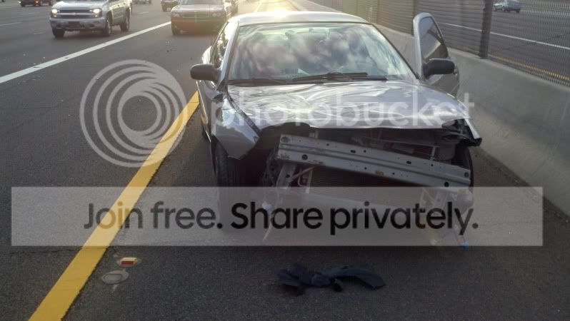

I was on my way to work one morning last week and got into a little mishap. Traffic on the freeway suddenly slowed down and came to a stop. Everybody slowed down but the guy behind me. He hit me at about 40 mph.I was very pleased with the outcome of the wreck. His car was totaled but my truck only suffered a bent mudflap and a small dent in the bed
Ha! Shweet. Sucks about the dent though.

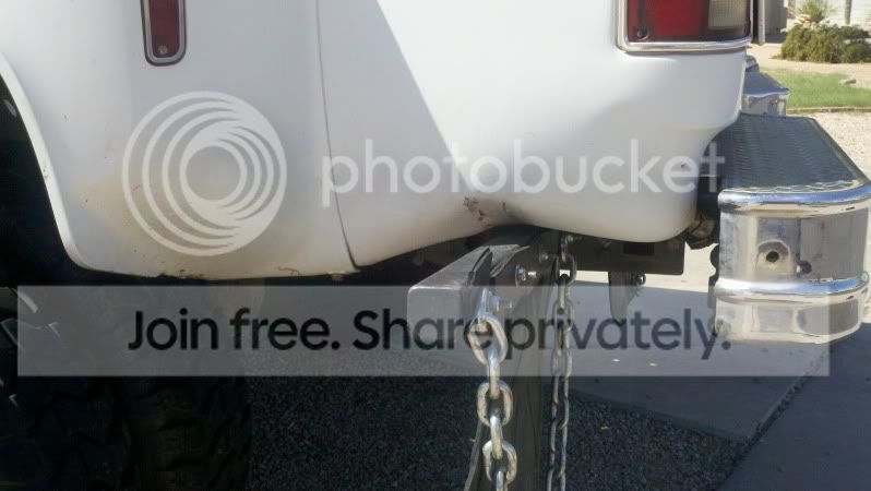

Appears that your rear bumper is also bent up on the driver's side...
The rear vehicle usually takes 90% of the damage in that kind of accident.
The right side of the bumper is bent down, it was that way when I bought the truck. The car actually went under the bumper and didn't hit it at all. The dent in the bed sucks but its not really that bad. I pulled most of it back already and will finish the the body work in only a couple hours. Im just glad the truck hasn't been painted yet as that is one of the next things on the list to do

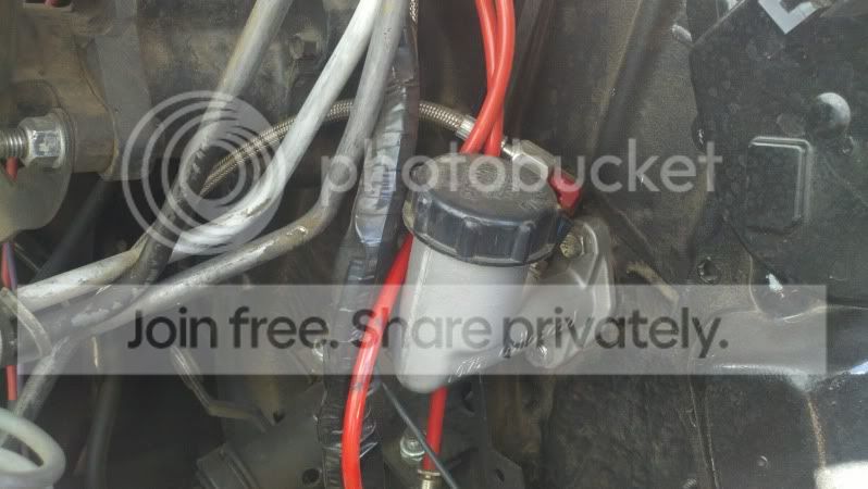

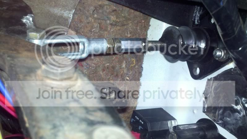

How did you connect the master cylinder to the clutch pedal?
