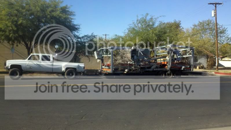

I built this truck to work and I tow with it quite often. Yesterday I pulled the biggest, heaviest load yet.....and it was on a bumper trailer. Luckily I wasn't going too far. I hauled an old vacuum forming machine to scrap and crossed the scale at 28k!!!!!! The truck pulled the weight fine other than the rear suspension was 1/2' off the bump stops.
I was busy when you sent me that pic and forgot about it. Holy **** man!! Time for some bags, come on you do it for a living!!
