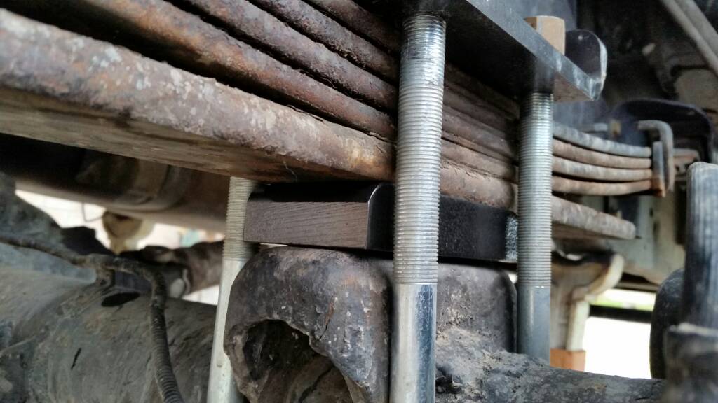

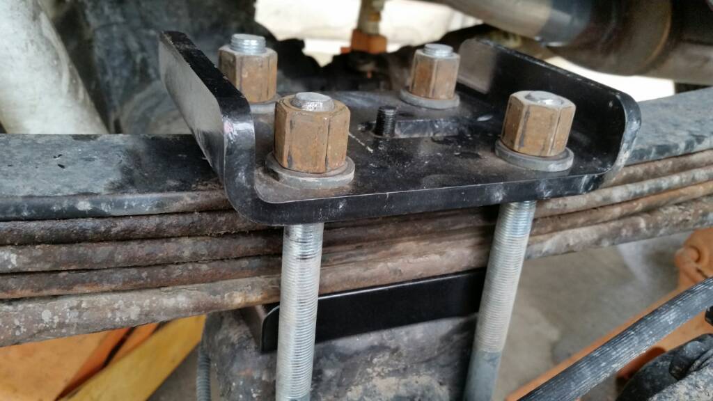

The inside U bolt looks fine, the outside one I'd probably replace. What I've read about is that in general you want full thread engagement - at least 1 thread coming out the other side for full strength. They're relatively cheap for some piece of mind.
