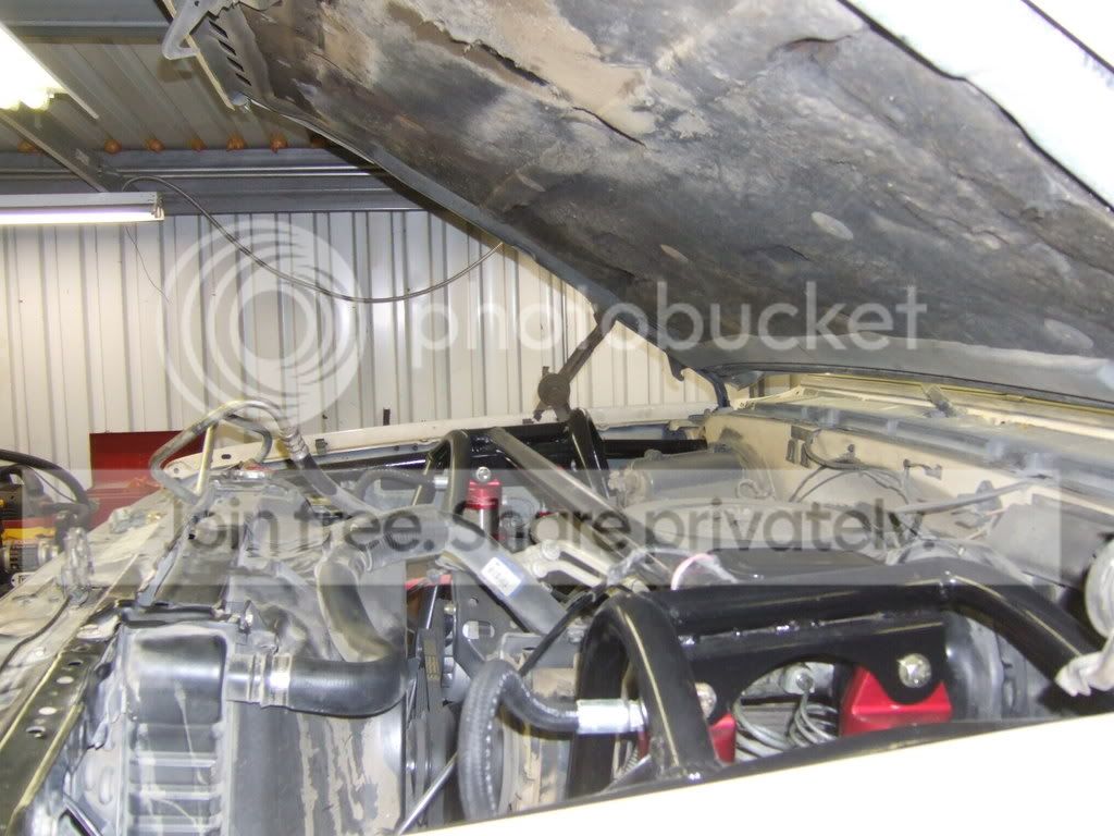

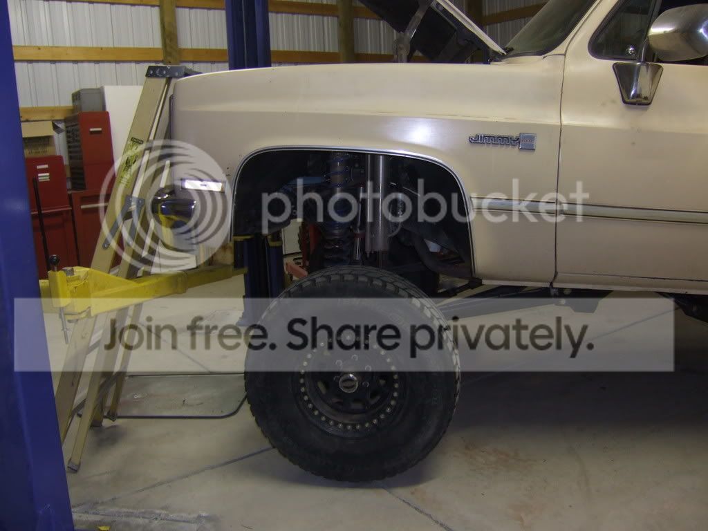

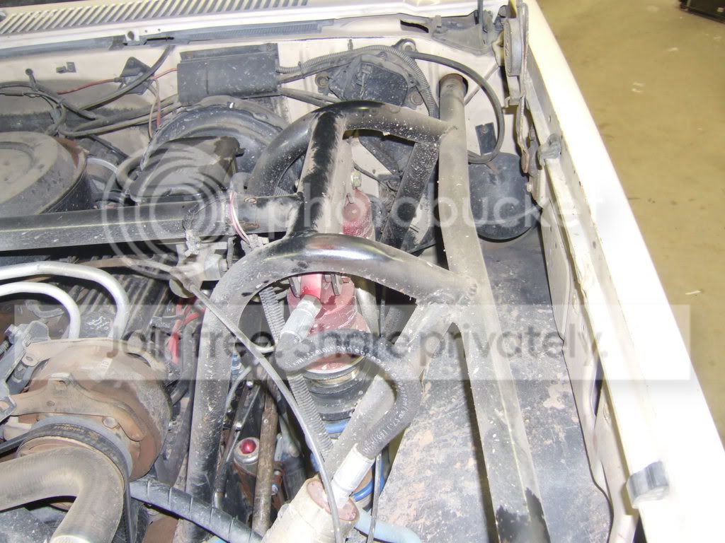

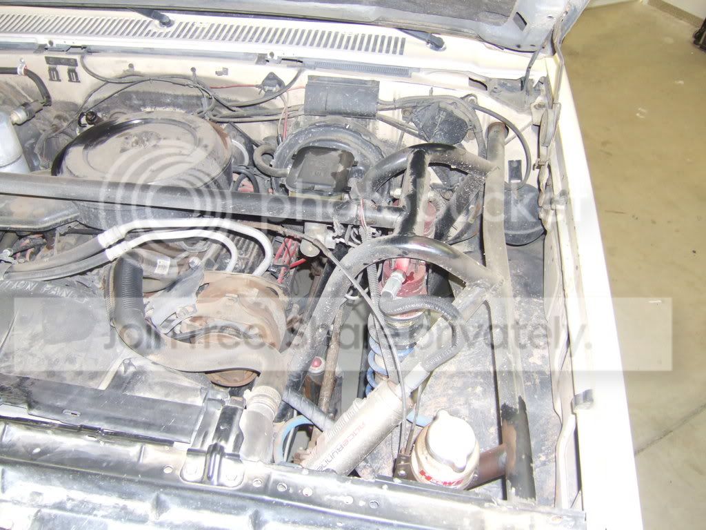

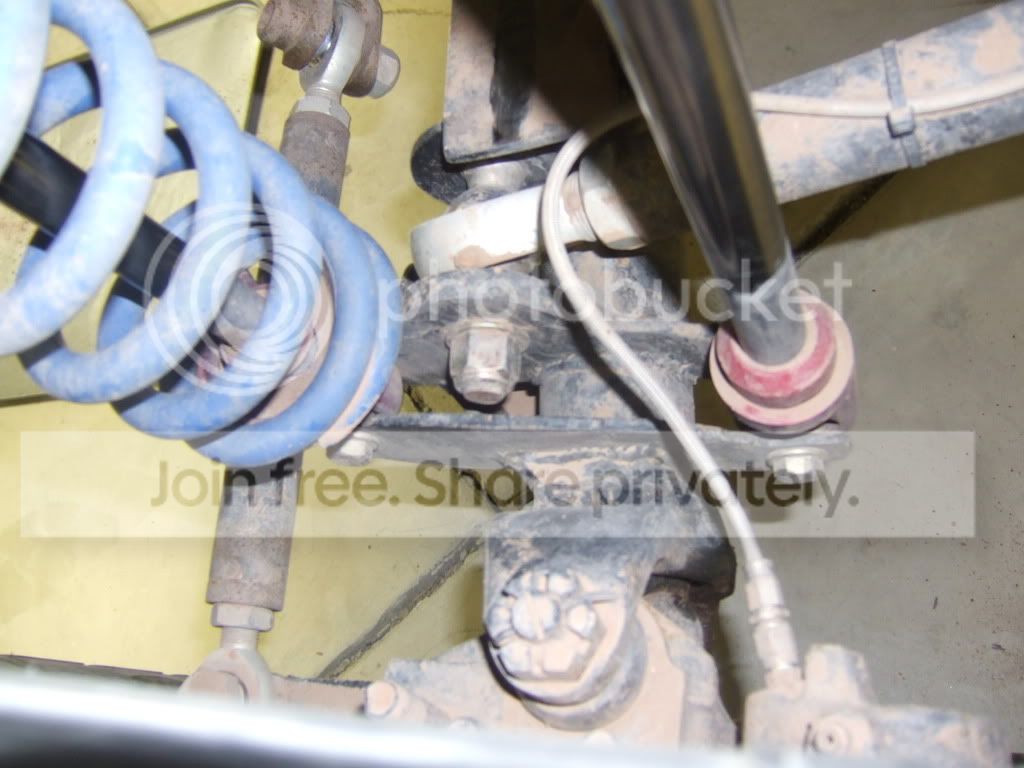

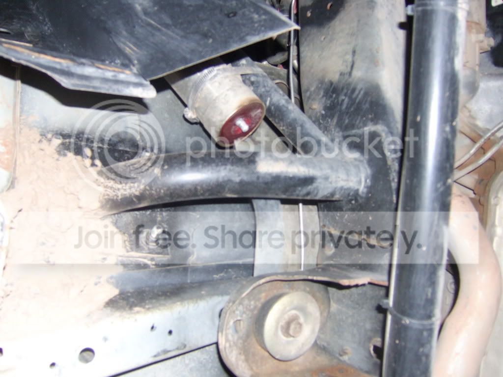

I'm a fan of this build :eek1: I'm looking for some new coilover mounting ideas up front on my rig with a little more beef. I think my current set up is fine for the average usage but I'm a little unsure of it dropping off of a ledge at speed. Would you mind posting extra pics of how your shock towers tie in to the frame and the outside of the motor cage along the fenders? I've been trying to find a way to pull something like that off. thanks!
Here are the pictures I promised. For more, see my photobucket link.
Thanks for the pics. I'm looking for ways to at some point mount my coilovers further out away from the frame and have them mounted on vertical tabs rather than horizontally with a little more surface area to be welded. the pics of the cage foot tieing into the frame help out :bow:
Just remember one thing while designing it. When the axle articulates, the tires roll in at the top. Mine rub where they are now. Any farther out and damage would occur.
