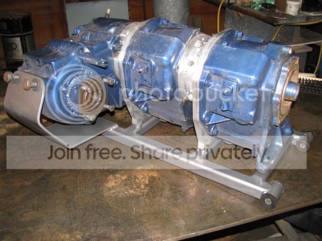

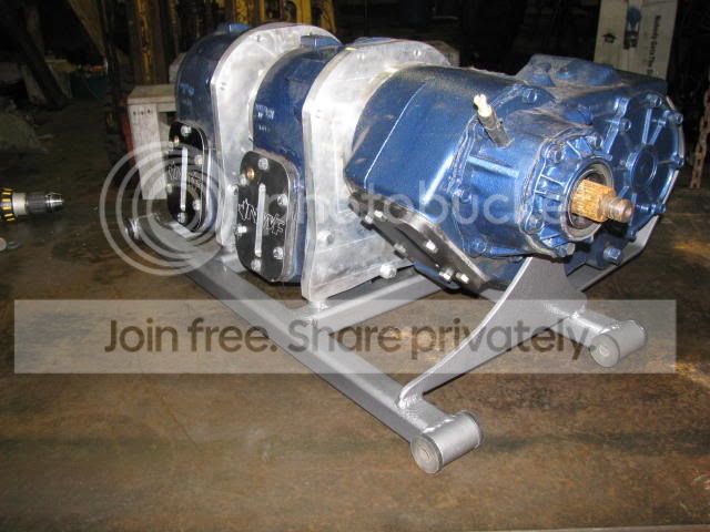

mine won't be on a k5 frame though, it'll be suspended on a full tube chassis. I just need an idea for bracing the crossmember, maybe even add another crossmember to carry the weight of the doubler.

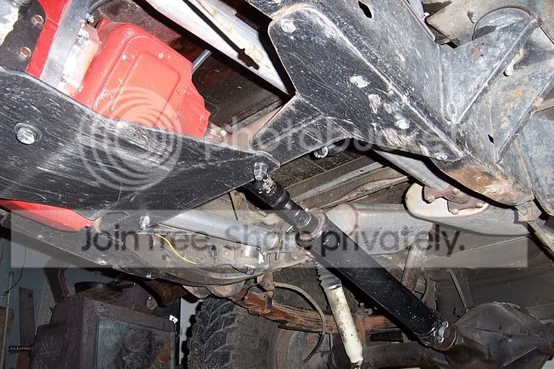

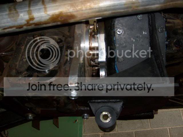

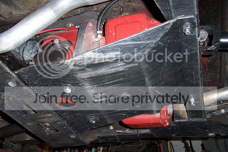

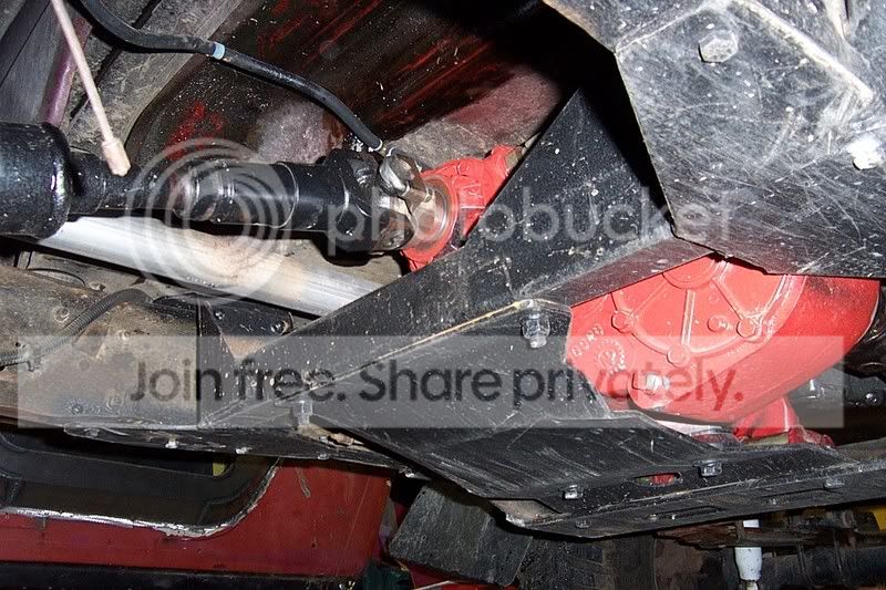

Here's my old setup-
Made mostly from factory parts.
This one is before the notch for the driveshaft-

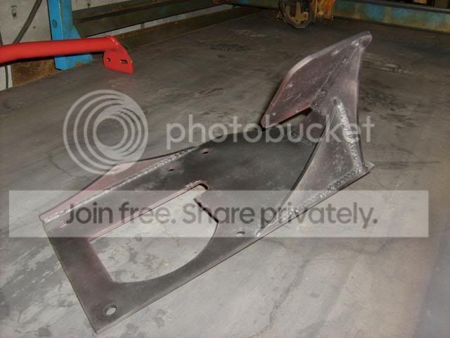

Here's another pic of a doubler mounting plate. This is sold by Copperhead Fab.

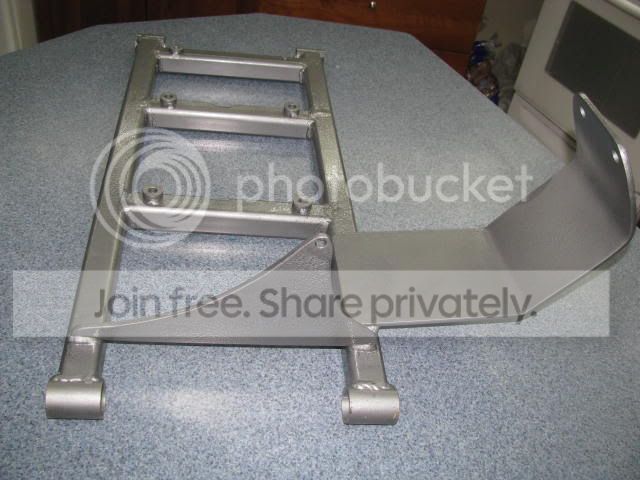

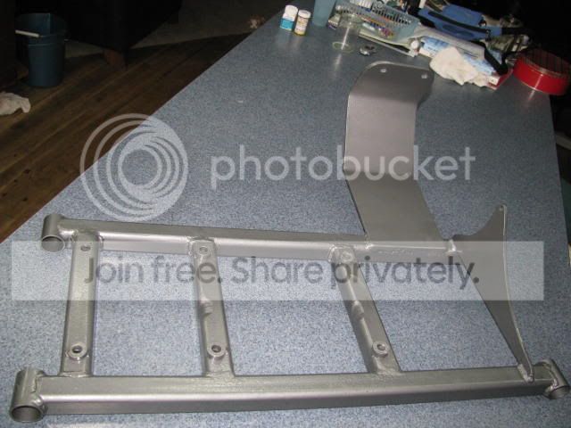

Just finished my suspended x-member...still not sure if I'll have enough room fo r my seat (pass seat won't really matter I'll just slap it somewhere in there) but I'll worry about that later. Worked around hoping to leave enough room for my seat and the exhaust that'll run to the driver side.
TTT, any more ideas? I pulled the one I built...not happy with it for several reasons. Going to redo it in the next few weeks to make room, change the mounting location of the bushings to the adaptor instead of the frame, & make some decent welds :haha:
