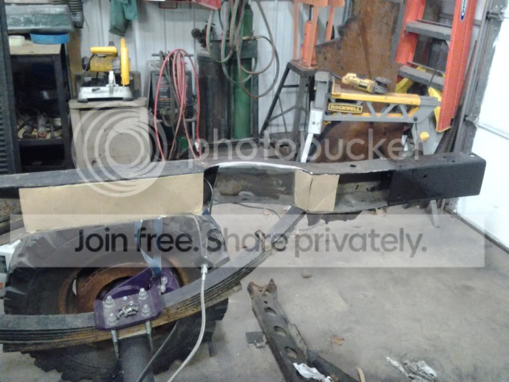

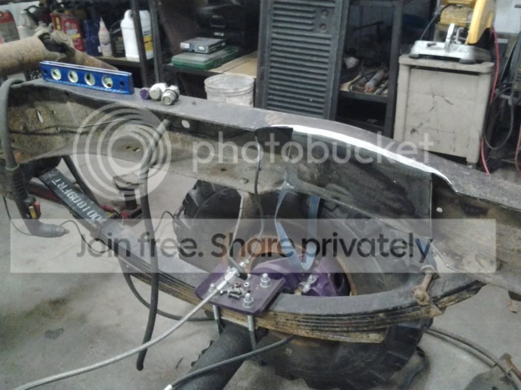

Also worked some more on boxing in the frame. Only was able to get one piece cut cause I ran out of oxygen for the torches so I switched to the plasma which takes forever:doah: I got some card board templates made of the pieces I need to cut out yet.
