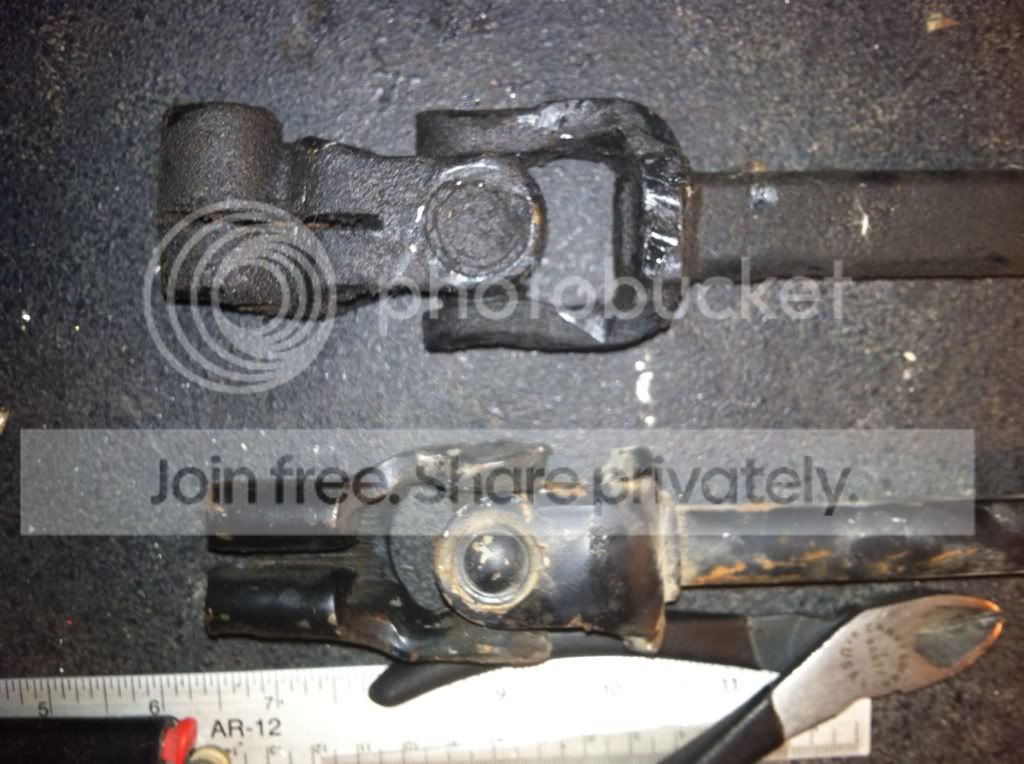

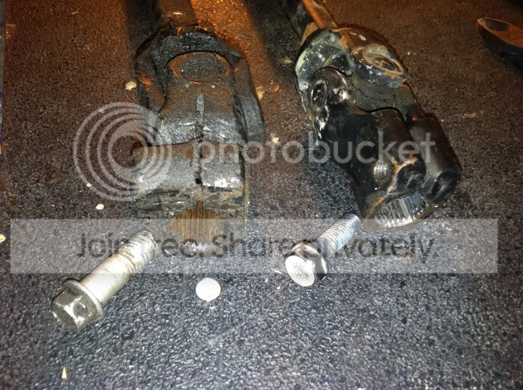

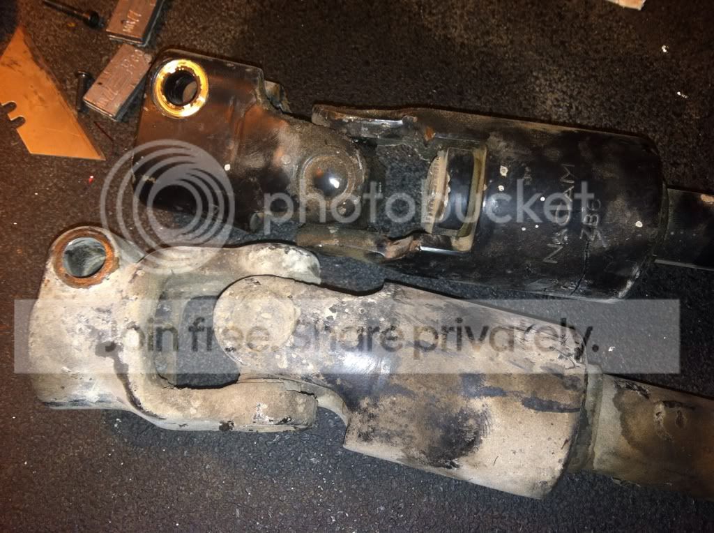

i finally did something suburban related today. i went to a local junkyard and pulled two XJ steering shafts. one's form a '90, the other is from a '93. there are some slight differences between them so i figured i'd post some photos and see which is the right one. i guess i could have pulled the shaft off of my suburban and matched them up, but that'd make too much sense. lol
