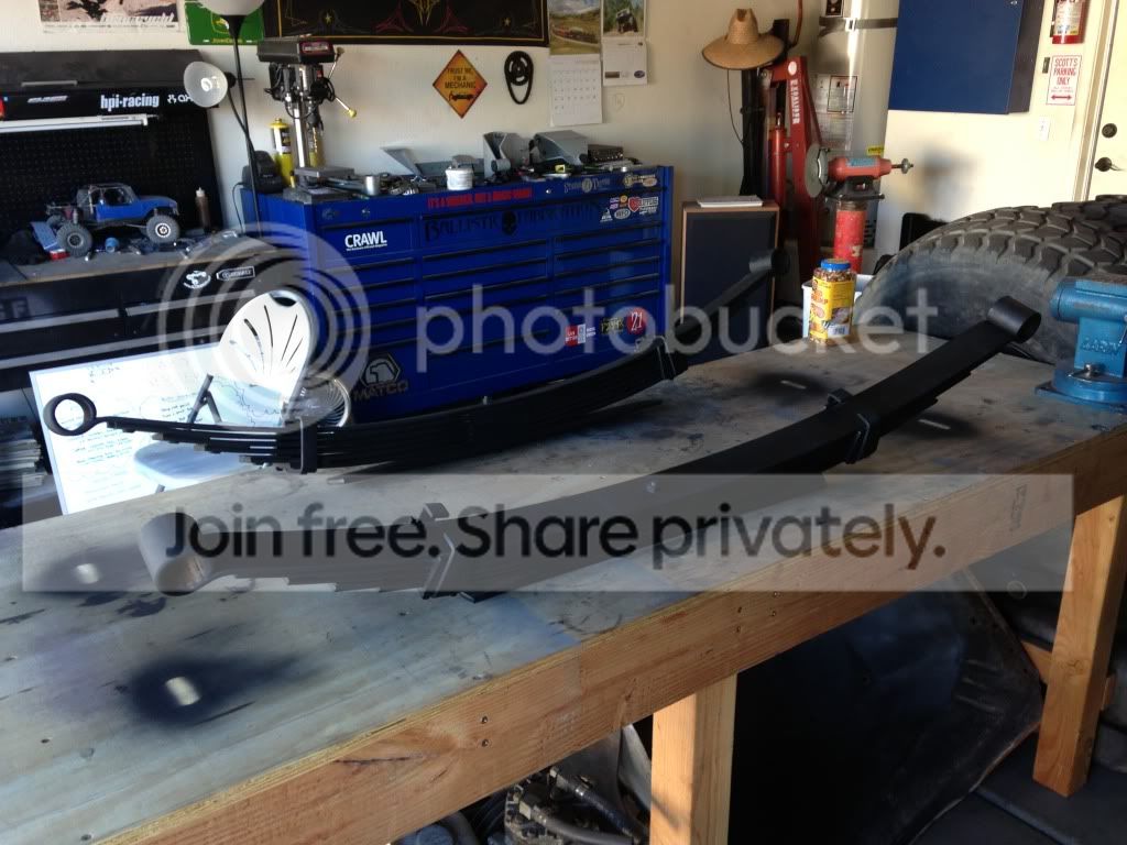

got the springs out and removed the old bushings, took about an hour by its self. does anyone know of a source or part number for new poly bushings?
cleaned and painted the springs, i know, i'm gonna have to do this to the front now...
14b is all painted.

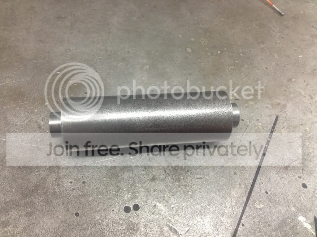

anyone care to guess what this is?

I have no idea what that thing is.
Yeah I posted about it in the garage and got an answer. According to ORD's site, some 89-91 k5s/suburbans has metric rear springs, that measure 1.7" ID.

I went to my friend's house and got something done today. That mystery part was to cross tie my rear shackles. 1" solid rod, turned down to 1/2" on the ends to insert into the center holes on the WFO shackles, welded in. 3/8" thick shackles with a 1" solid rod cross tie, I shouldn't be bending these, ever.

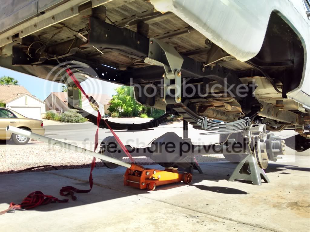

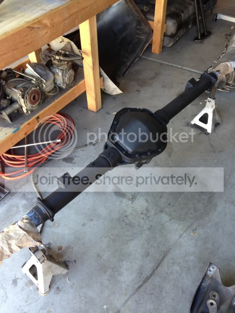

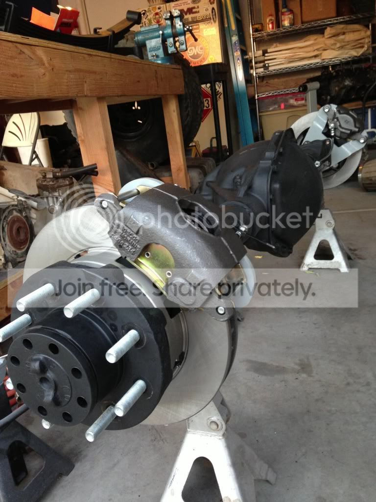

wheel studs and lug nuts showed up, then my rear spring bushings from ORD and spring plates from DIY4X came in the next day. i bought a bunch of new hardware and got some work done yesterday and today.
installed the springs bushings, assembled the hubs, bent up some hard lines and installed everything this morning. i also picked up a brake line flaring tool and fixed the hardline from the load sensing prop valve to the soft line bracket. the nut was rusted shut and got ****ed up trying to remove he soft line.

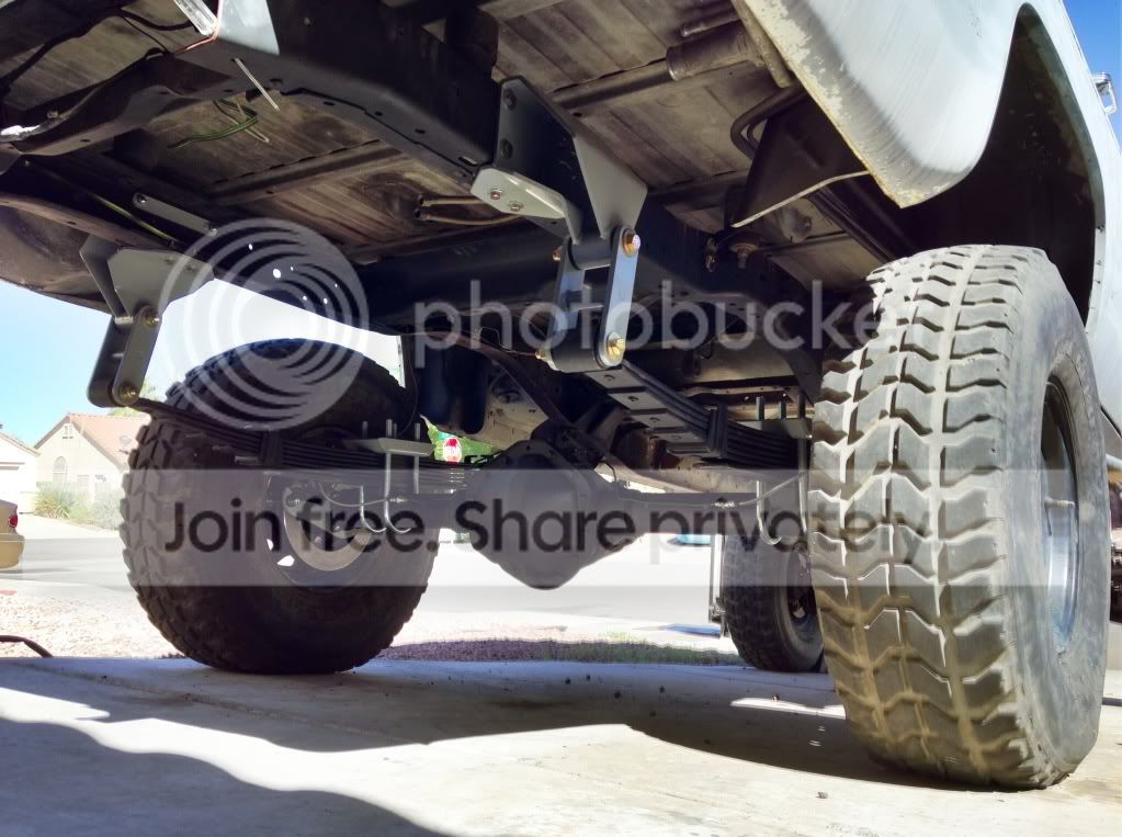

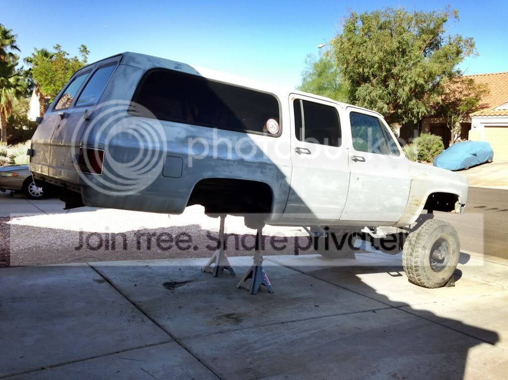

you haven't lived until you've installed one tons under a truck on a slanted driveway. i actually hung the axle from the frame with ratchet straps and lifted it into place with them, lol!
all bolted in.

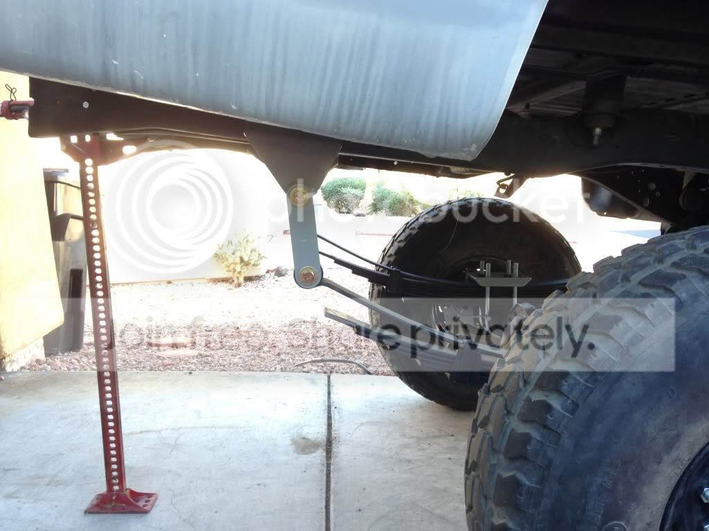

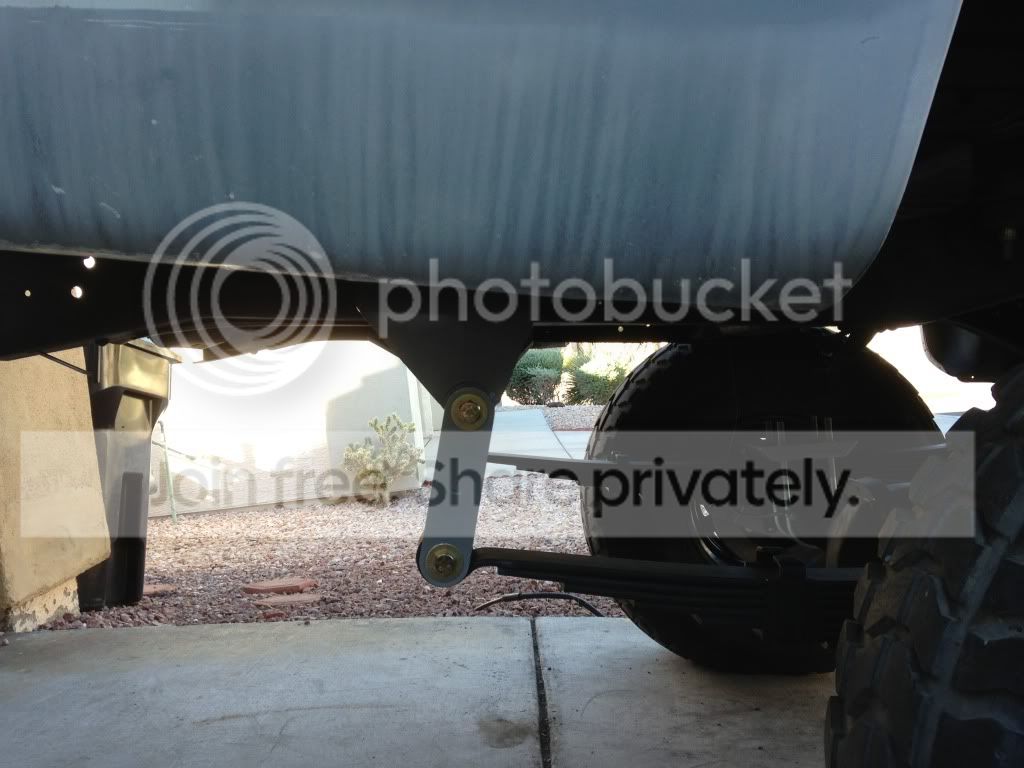

as she sits right now, too tall. currently at 8" front and 7" rear. still gotta ditch the body lift and the front shackles, that'll bring it down to 5" all around. i just need to have a rear line made and the brakes are done.
shackle angle, there is no weight in the truck at all, fuel tank isnt even installed.
Wow looking good. In like strap holding floor jack from rolling away
5" seems like a goodvheight for a burb. Looks real tall now with the body lift.
when its all said and done, if needed, i can drop to a 4-5" shackles and add a zero rate in there for to get the height i need and add some shackle angle.

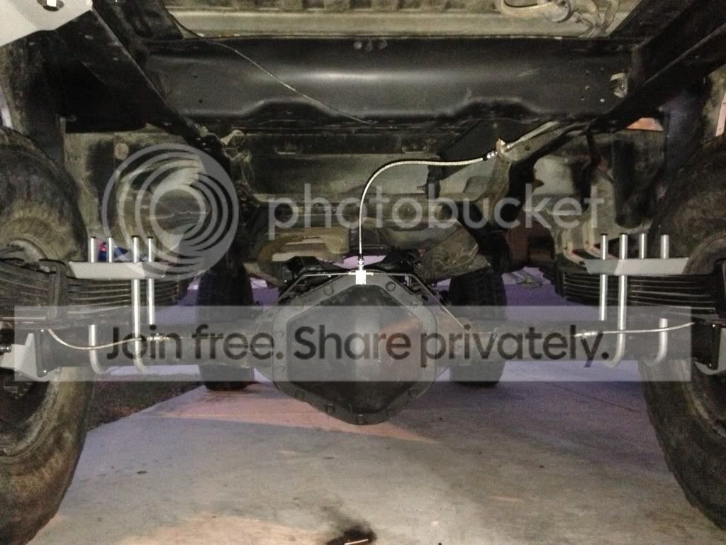

i had a new rear brake line made at a local hydraulic hose shop and got it installed today. i bent up a new set of hard lines to fit it a little better. the other lines i made had i just kinda floating above the diff, this way, they're bolted down.
