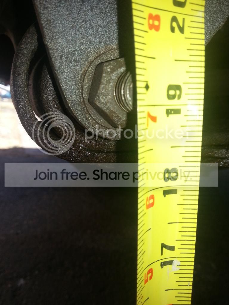

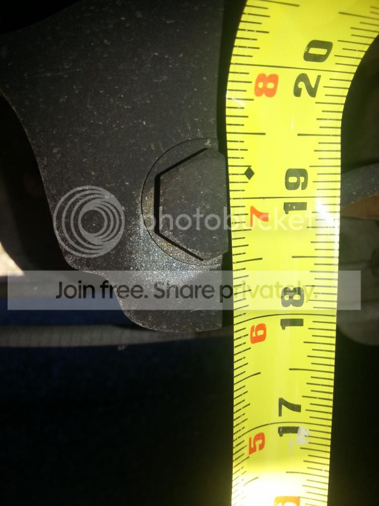

i did some measuring and i'm wondering just how much lift the front has right now, after removing a leaf the springs settled some. ever since i drove away from the tire shop yesterday i've been thinking about dropping the front end an inch to fill the fender a little better but i'd like a better idea of where i'm at now. can someone else on 35s measure their trucks there and tell me how much lift you've got?
front spring eye bolts are at 26 7/8"
rear spring hanger bolts are 24 1/8"
i can pull the zero rate out of the front which will lower the front end and move the axle back 1". the problem with all of this is that i've got 14" shocks and that'll leave me with 4.5" of up travel from ride height in the front shocks. i could buy a pair of 12" shocks for the front i guess. or just deal with it and save my money for a set of ORD springs... i should probably just leave it alone and work on other things, like sliders bumpers and skid plates

hmm... this makes my truck 5" taller in the rear and damn near 7" in the front. i think i'm gonna drop the front an inch and start saving cash for ORD springs.
My K5, 4" superlifts up front, no motor. 25" to the front bolt center. Rear is 23 1/4" with 4" block and a 1" zero rate. Truck has 35's on it that measure about 33 1/2"...they're pretty worn.
Your taking tire size into account also right?
Your tires are 31.5" mounted, mine are 34" mounted. That's a 2.5" difference in diameter, split that in half for radius makes a 1.25" height gain from the tires. that makes my truck 3.75" taller in the rear and 5.75" taller in the front. Does that sound right? I'm a victim of the Clark county school district... Haha!

So at 1/2" less tire which is effectively only a 1/4" less tire your truck still sits 2" lower than mine. Hmm.... Seems like I'm a little tall, which is surprising.
I guess I never took into account that Dana 60s have taller perches and larger tubes that add an inch of lift over a 10bolt.
