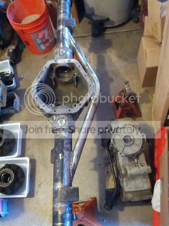

Took it down and had it straightened, tubes welded to the center section, and a truss added to the top:
During reassembly:
All fresh and ready to go. The lube I drained out looked darker than it should have for the amount of time it was in service so I went with synthetic lube this time.

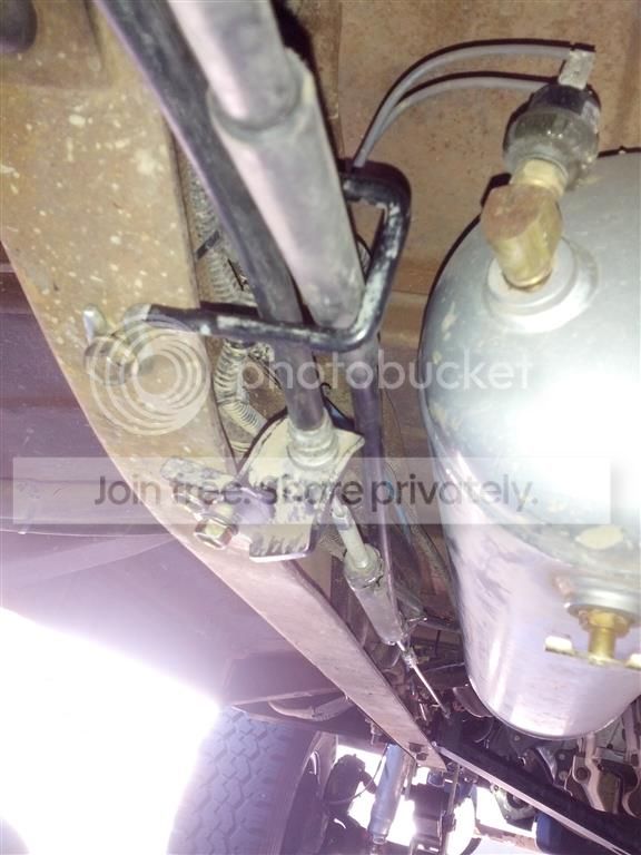

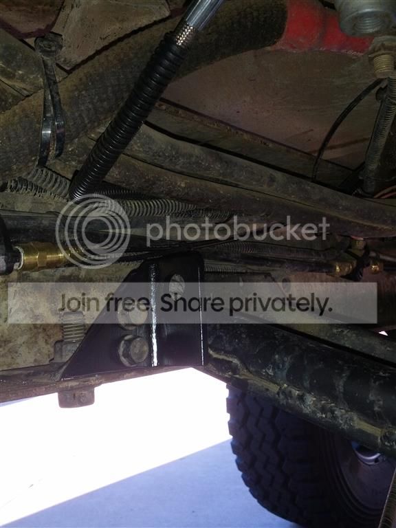

One thing I did change was I went with the later parking brake cable setup. It is the style that runs both cables down the driver side frame rail. It ended up being fairly easy and very well worth the effort. It will hold the truck in reverse, under power now, whereas before if it was on a hill I had to shut it off and leave it in gear to be sure it wasn't going to move.
Rear mount:

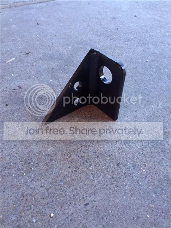

I had to make a new front mount for the stock Suburban cable to fit into:

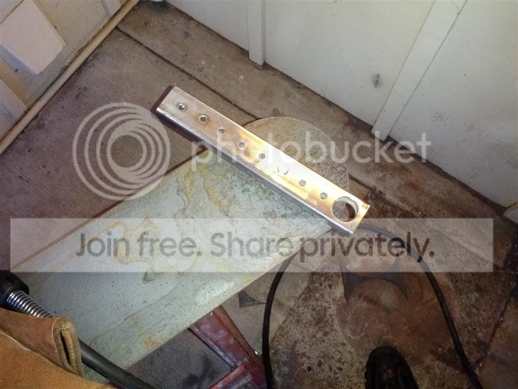

While the axle was out I got a Daystar lower bag mount kit for the air bags. I had to make some plates to support the bag mounts. I don't have a cool circle cutter, so I hacked one out of a piece of tubing:

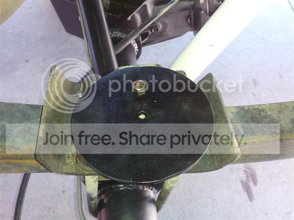

Plate mounted:

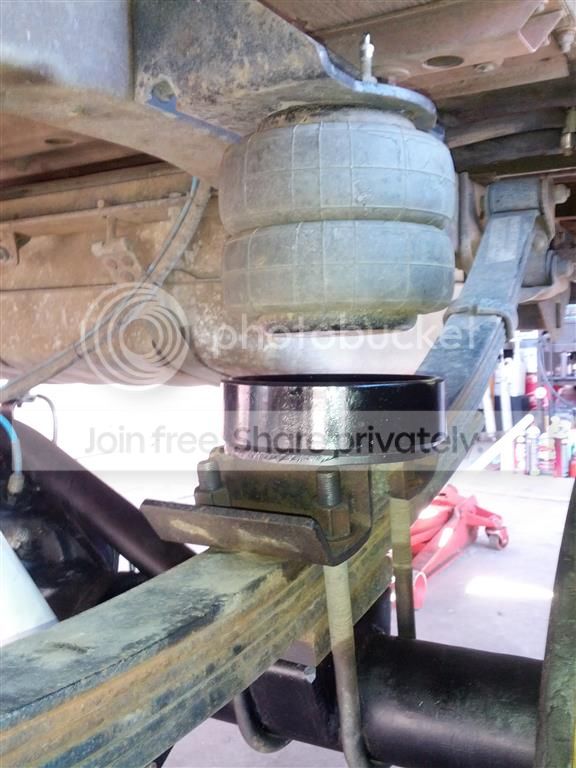

Bag mounts installed (it looks like the mounts are offset, but they are directly under the bag--just looks goofy in the pic):
This setup keeps the bags from becoming limiting straps when the truck is twisted up. They work great. I am surprised I did not have problems with over-extension of the bags before, but this removes that from even being possible now.

Moses, what led you to believe the axle was bent? What symptoms did it have? And how did you determine it was in fact bent?

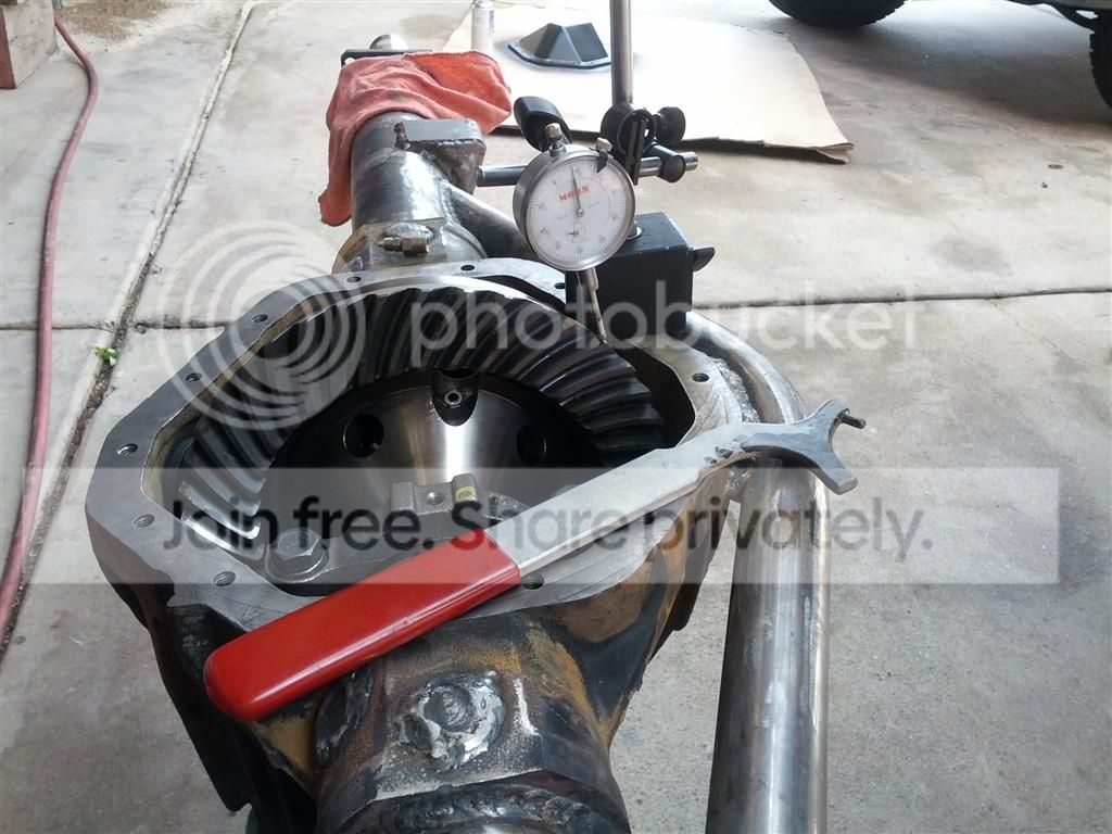

The parking brake cables on the 14FF were not going to work with the lift and the '72 brackets. I need to address this issue because I need a parking brake. The pinion seal has needed replacing for many years and I need to swap the original G80 Gov-Lock unit for an open carrier with a Detroit Locker in it. I guess it is time to tear into the rear axle.
I was glad to see the ring and pinion were in fantastic shape. The backlash was in spec, so no need to replace them. I pulled the carrier out and was going to go after the pinion seal. I was going to check the pinion preload, but decided against it because it woud have been a waste of time. There was some, but nowhere near enough to bother checking. Luckily, I had enough foresight to realize this would probably be the case and I had all the pinion bearings on hand. As I was pulling the pinion support out, the UPS dude showed up with my two crush sleeves and shim kit. I always have two crush sleeves on hand so I can get the preload right the first time. I found out years ago that if I have only one, I go past the specified preload and have to go get another crush sleeve. I got the pinion support assembled and installed. I got the Detroit installed, set the backlash and sealed it up.
I looked at my rear end and it was smiling at me. I verified it with a digital protractor on the tubes. I guess technically it was more of a grin than a smile, but it was giggling nonetheless....
