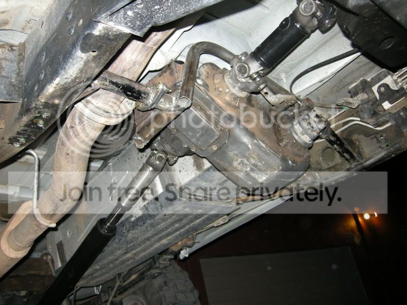

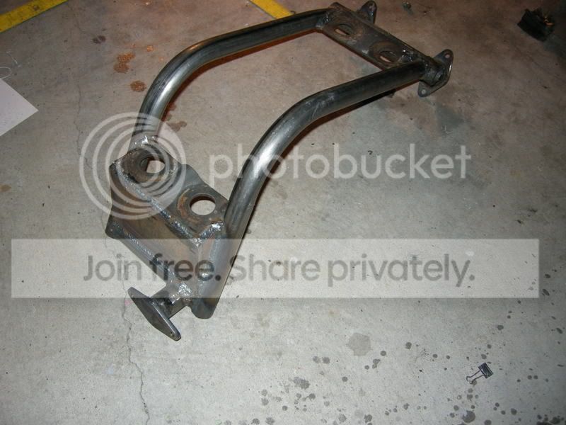

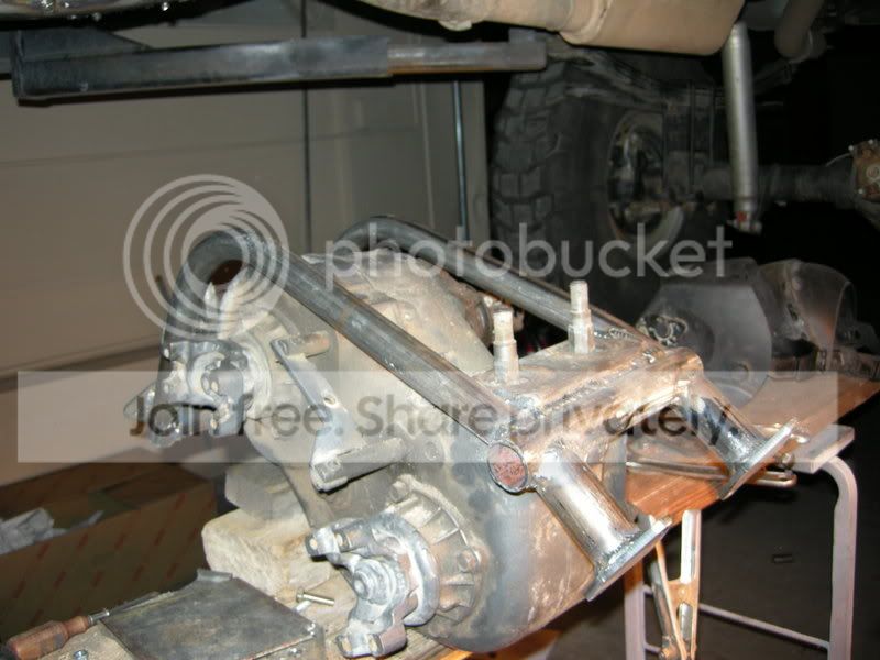

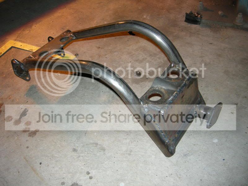

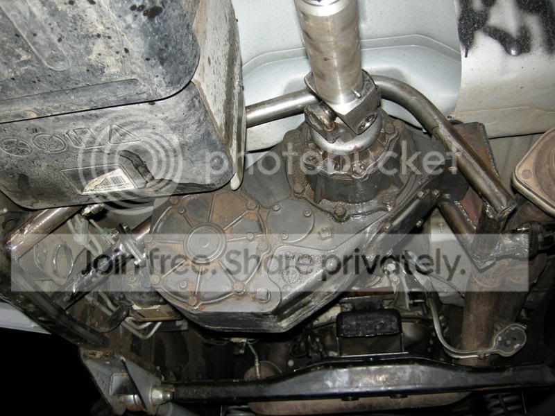

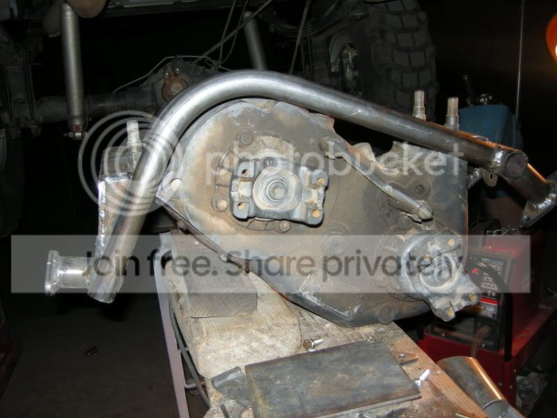

well I finally got a some time to get the transfercase mount done..I am not sure if this one will stay in there or not but it helped me pass some time.
im going for a test drive to beat on it a bit and test it out..hope I make it back:crazy:
it surived my local test spot to "air out" my projects.. lands pretty damn smooth considering the front does not have bump stops yet..now thats going to be going on the list, if it did not fall out with the stupid stunt I just pulled im pretty sure the mount will do the job:D ill post a couple pics I took of it.

when the exhaust is done I will add a 4th mount to the mount, right now the ehaust is right in the way..

Sweet looking set up. Just looking at it makes my back hurt lifting it in there. One note, on most divorce t-case set ups they have a bracket on the back of the t-case bolted to the rear of the front output bearing housing and a support rod running the frame. I don't know if you thought about doing that, but I have a bracket if you want it or I can send you a pic so you can model after it.
