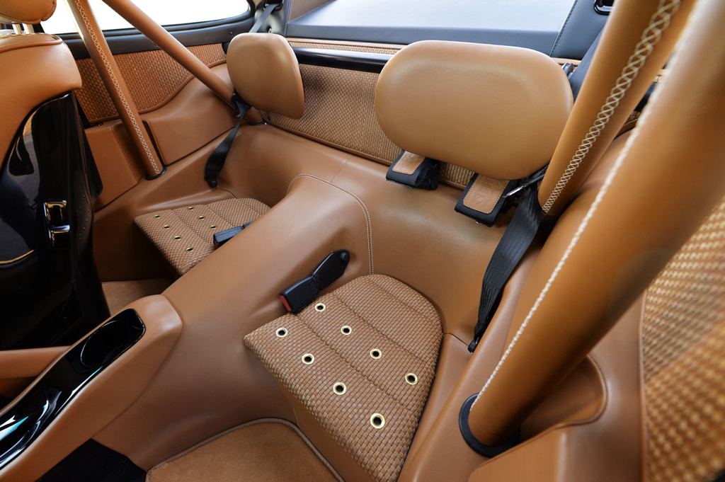

Same page. I have my mind right about a b-pillar halo bar, but the front firewall is a great canvas for a reinforced shear plate connected to the larger rocker boxes which is connected to door bars. I'm headed down that path for now in the aim of avoiding an a-pillar halo and down bars. We're going for Z28 and CTS-V levels of performance.You don't need a NASCAR chassis to make it stiff, plus I really hate to see cages in street cars personally.
This is my thinking. I'm not hung up on an original interior, and an aesthetically integrated cage is appealing - a la the Singer 911. It just might not be wrapped in Ferrari leather......make the cage a feature. Make it the trim. It's hard to do right...
