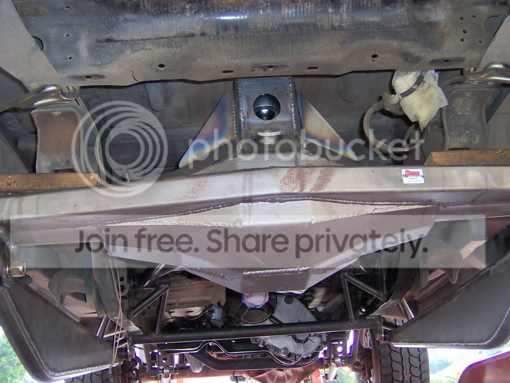

Very nice. Mine was built with tapered roller bearings on chromo 35 spline axles. Much stronger than the sealed bearing unit. And it holds 1.5 gallons of fluid.
thats real nice !
this one is the 1/4 inch wall junkyard model it also has the big bearing style tapered rollers.
trying to stick to the budget somewhat
I was on a budget too. But when I talked to Ray Currie, he said he had a housing they built for a magazine, with GM backing plate mounts. It had been sitting for 2 years in the back of the shop. I got a great deal.
