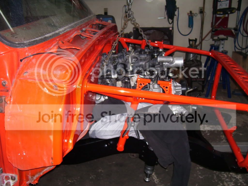

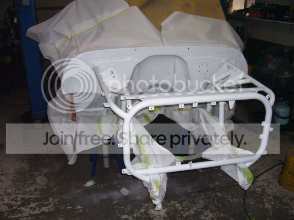

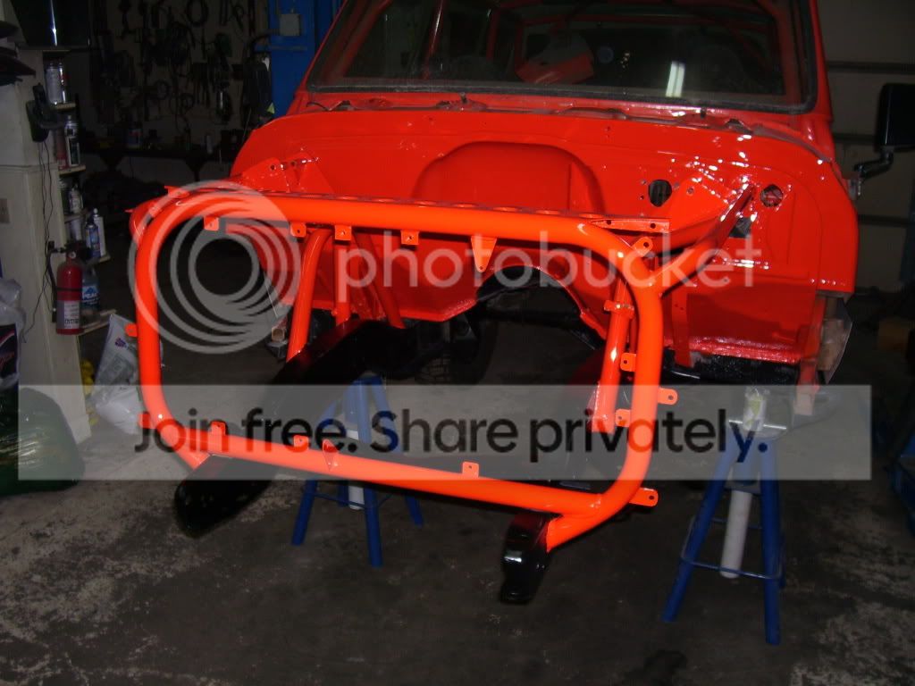

I'm curious about how the engine bay "hoops" are attached to the frame. They look like they are just welded around a short section of tube. Is that all there is to it or is there a bolt, bushing, or something else going on in that 3-4" piece of tube?

The short pieces of tubing just weld directly to the frame and the hoops weld to the short pieces of tubing. The short tubes will be trimmed and capped before it's all done. I didn't reinforce the frame under since the force is spread out over many points.

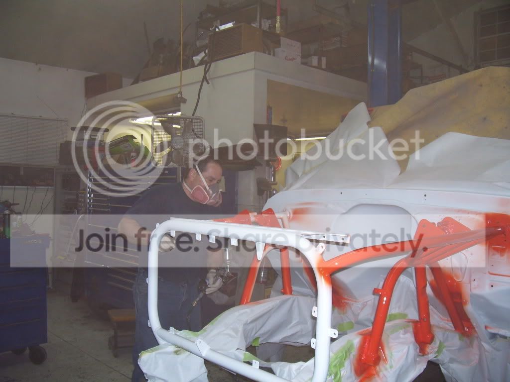

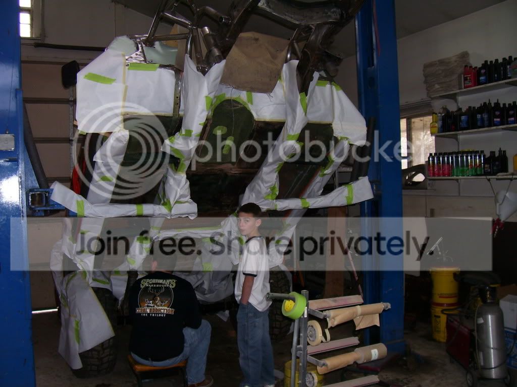

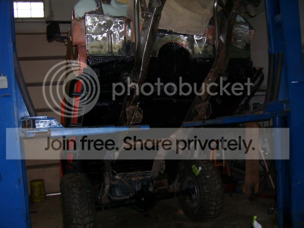

Prepping to spray Al's liner underneath, pretty much just stood the tub up on the rear bumper to make life a little easier.
Lining sprayed and ready for paint.
Sealer on firewall and tubing
A little more orange:D
And a lot more orange.....finally:bow:

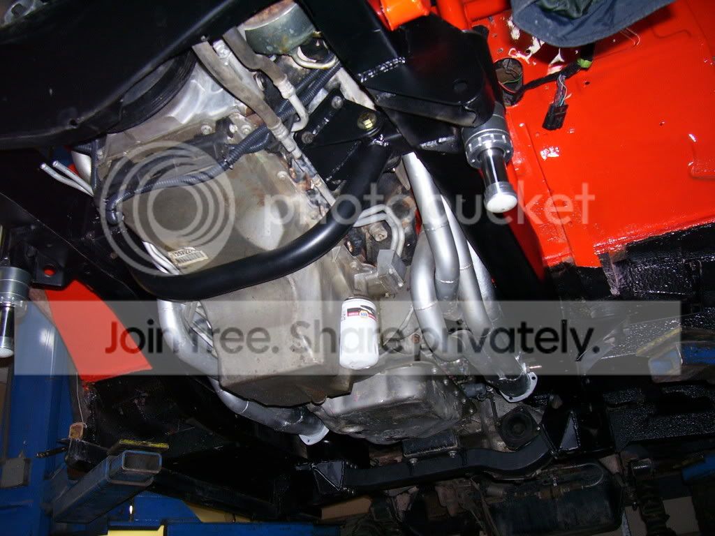

Back in with the motor.
Drivetrain in and ready for the front end:p:

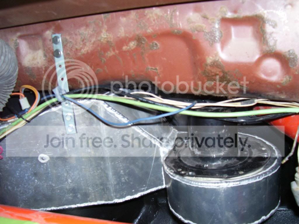

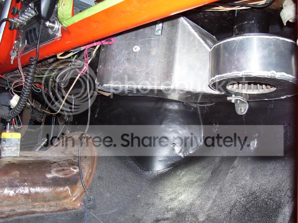

The new heater box to replace the original that was displaced by about everything

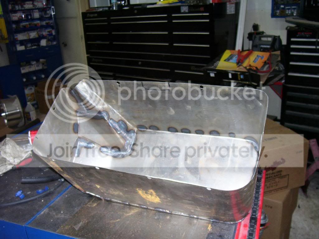

The new heater box then required a new glove box.....just like everything else: one thing leads to another:laugh: fun and games for all.

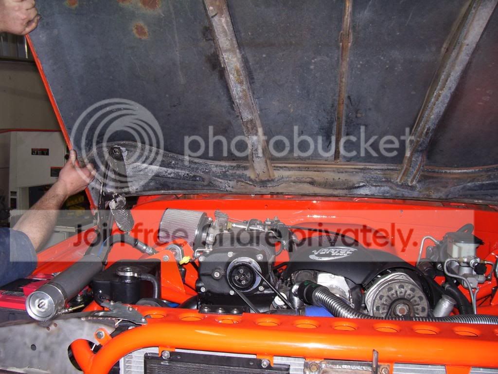

After a long thrash to get ready for President's day weekend the hood goes on (after it's obligitory multi-hour cut and weld session to clear the tubing) and closes on a long chapter in the life of a certain orange Blazer.
At least for now, I'm sure you've noticed the lack of paint on the underside of the hood and on the radiator support pieces. Those will come off and get some black before too long. My desire for fun won out over my compulsion to make everything pretty, thankfully.
