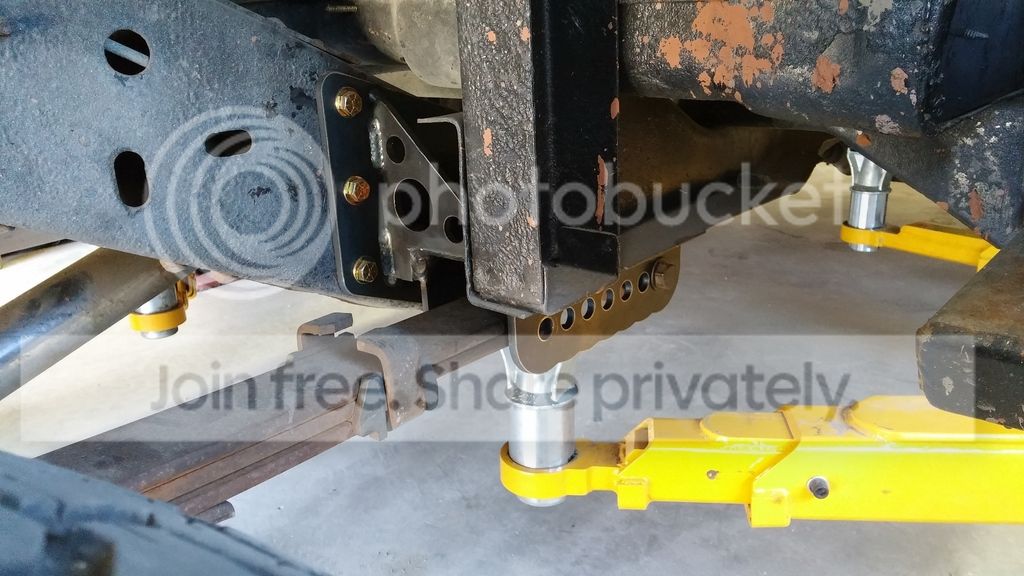

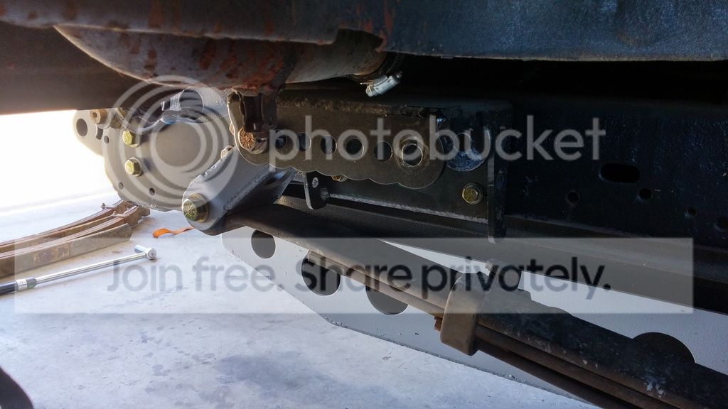

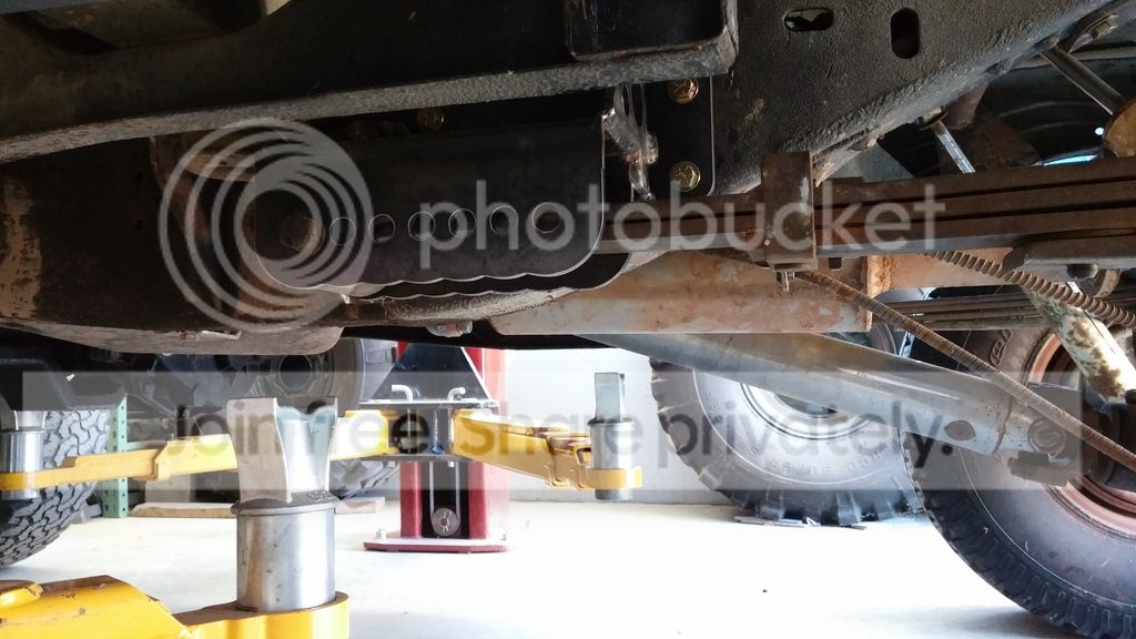

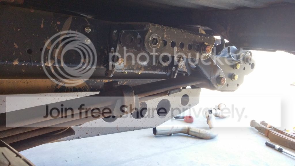

Well, some progress has been made on the Jimmy, but the only thing I got done with the 64 swap so far is the nasty burning out of the factory bushings and the installation of the new poly bushings. So now the spring hangers, shackle flip, and the 64" springs are all ready to go, just have to get the Jimmy off the ground and swap the springs in. The problem with doing that at the moment is the fact that there is a 12,000lb scissor alignment rack stuck in my only bay at the shop with a lift. I have been refurbishing it for my other job, and although the main scissor rails of the rack are refurb'd and painted, I am just now finishing up all the accessory parts that go on the rack - and while I'm doing that, I had to keep the main rails inside out of the weather. So I've been pretty stuck for the last two weeks. I'm optimistic that the scissor rack will be leaving this coming week, so I'm hoping to get the 64 swap done next weekend.
