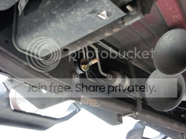

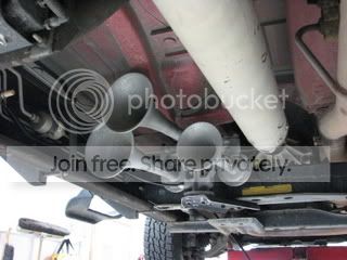

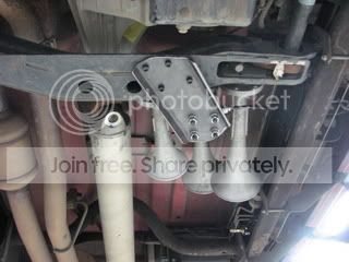

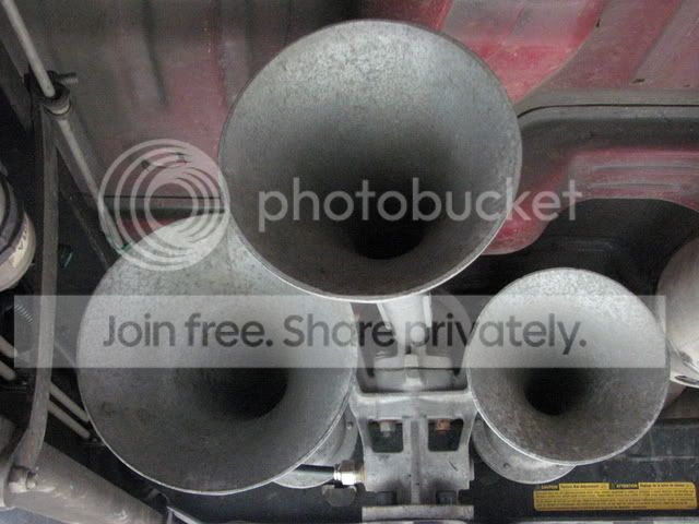

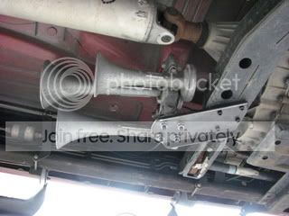

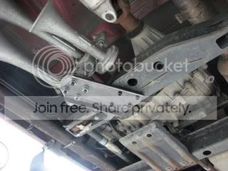

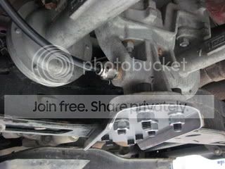

Nathan P3 - installed in my 02 GMC Crew.
I mounted a 5 gallon sausage air tank over the wheel well in the bed of the truck. Hopefully going to get a Viair compressor in the next few weeks. - but for now just filling it with my home air.

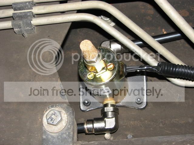

The pics show 3/8 air line - I have since switched to 1/2" - and I need a different valve - that valve is for the 4th axle on a dump truck - to drop the axle when the truck is loaded - either I just have a bad valve or it's not designed to run over 150 psi - cause it starts leaking out the exhaust at higher PSIs - so that will be replaced soon too!
This thing rocks - I hooked it to my stock horn and have it on a switch - so I can hit the panic button on my keys from across the parking lot and get a short LOUD toot! :D :D
sweet. Is this an on road only truck? Are you worried about crap getting inside it?
Yes & yes
This is my daily driver - I faced it towards the back for that reason - but I'd like to get some bonnets for the chimes - I've seen them on Ebay
Hmmmm. I see the horns can't be separated without some fabbing. I was looking at the space in the fender. Two on one side and the third in the other fender:D
I don't think you really have to worry about crap getting inside. They should blow out anything short of packed & dried mud:haha:
No air system components are designed to operate above 150psi that I've ever seen. And even 150 psi is high for air.

Yeah - I don't know that they would work if they were all seperated - I'm sure they would blow - but you might lose some of that nice train "tone."
