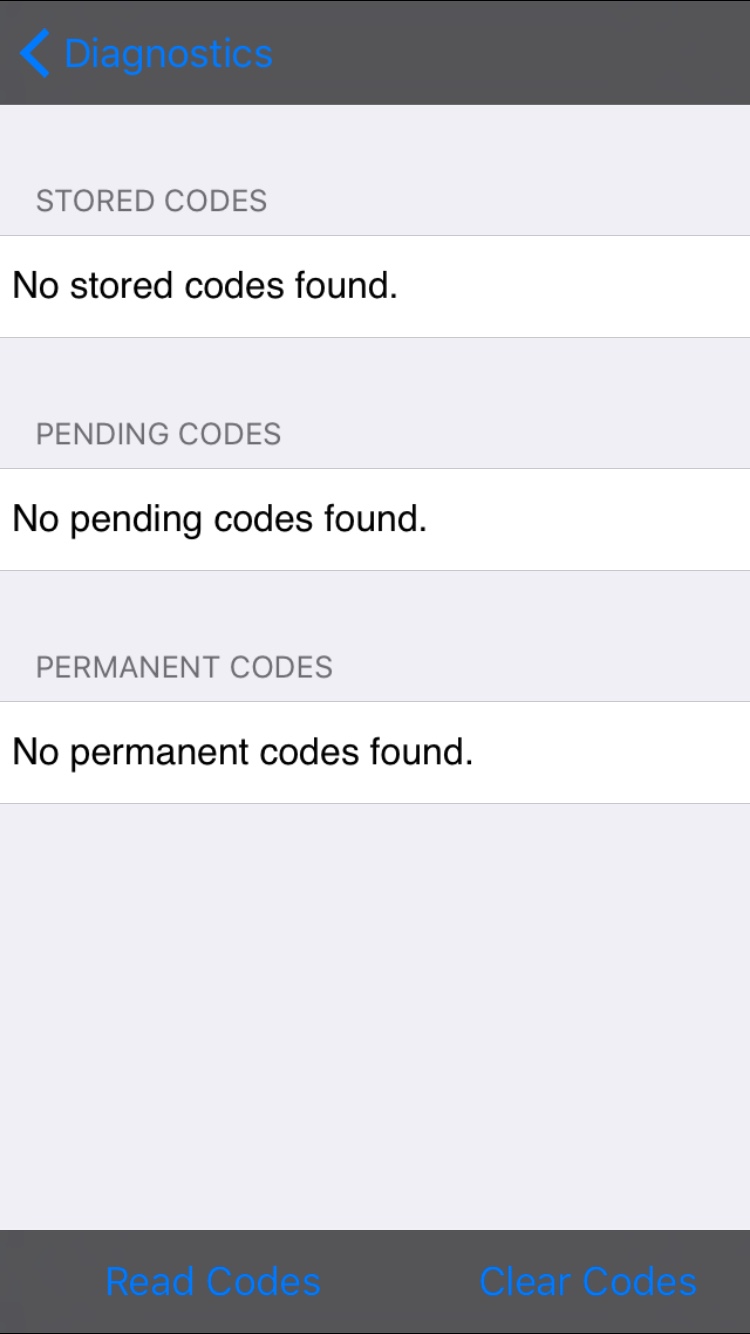

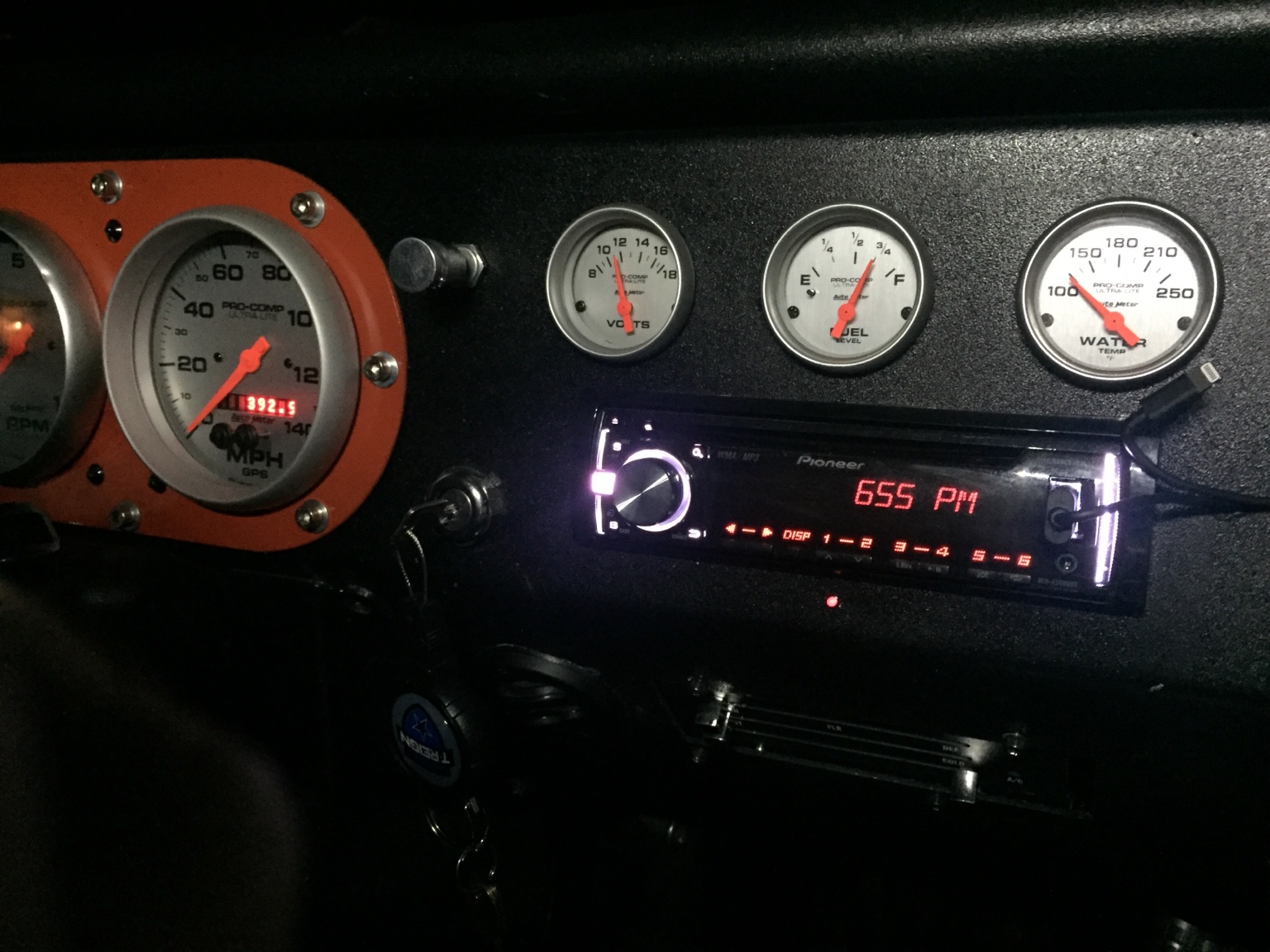

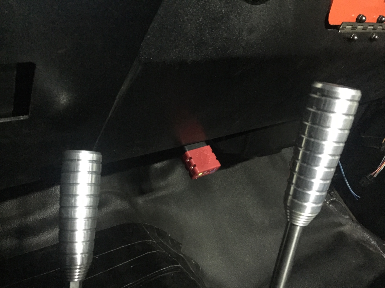

Got my obdmx wifi scanner in and connected. Amazing the visibility this tool gives you. Connected up a CEL which I am happy to report goes off when I start the car!!
You can see the cel below the radio
And the proof!!!

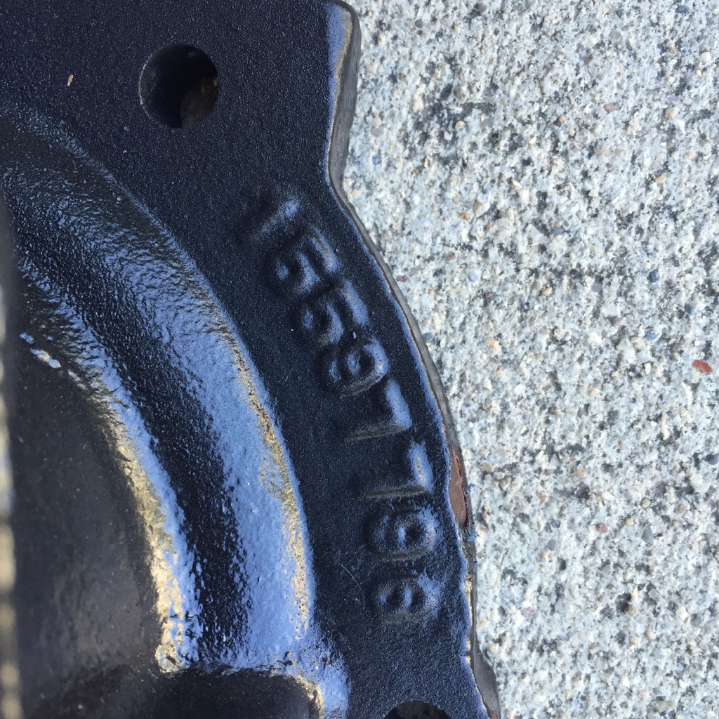

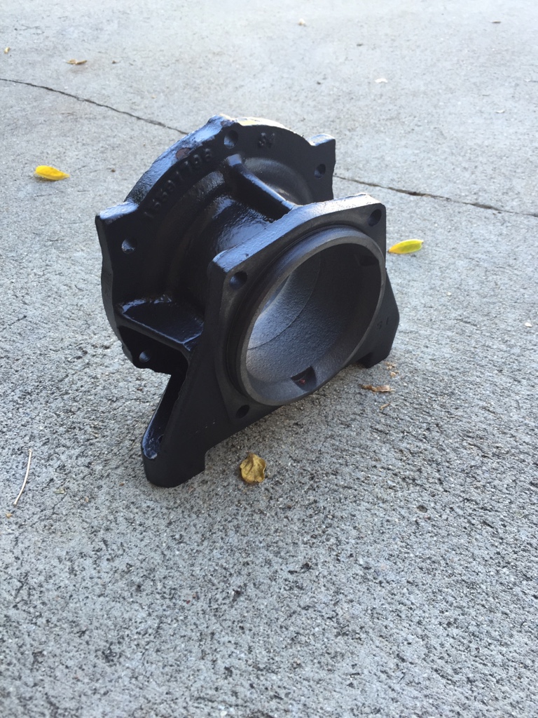

was just looking through your thread again. Is that the standard 4l60-E 4wd t-case adapter between the trans and t-case? Where'd you get your SYE? Thanks
There are two adapters that are common. One has a four hole transfer case side for a 208 and one a five hole for a 241. I had to buy mine. Cost like $50.
The SYE is from jb conversions who were pretty much the only ones doing them when I did it. The flange is from high angle driveline. I plan on adding their driveline brake here shortly
The adapters from my experience are different. I may have the hole configurations mixed up but I know the 241 I used is a five bolt pattern. I found plenty of four bolt patterns in the junkyard but not five bolt patterns.
