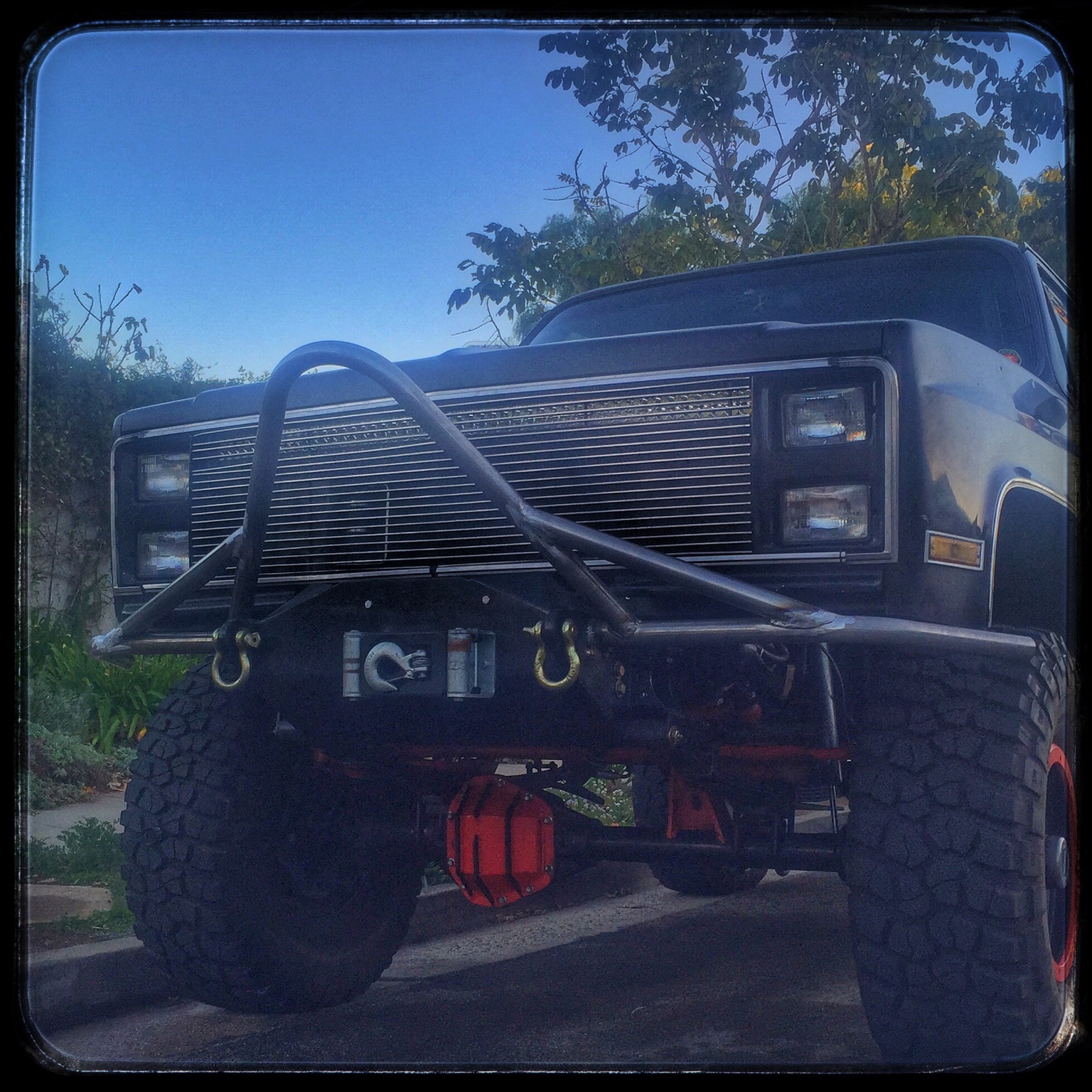

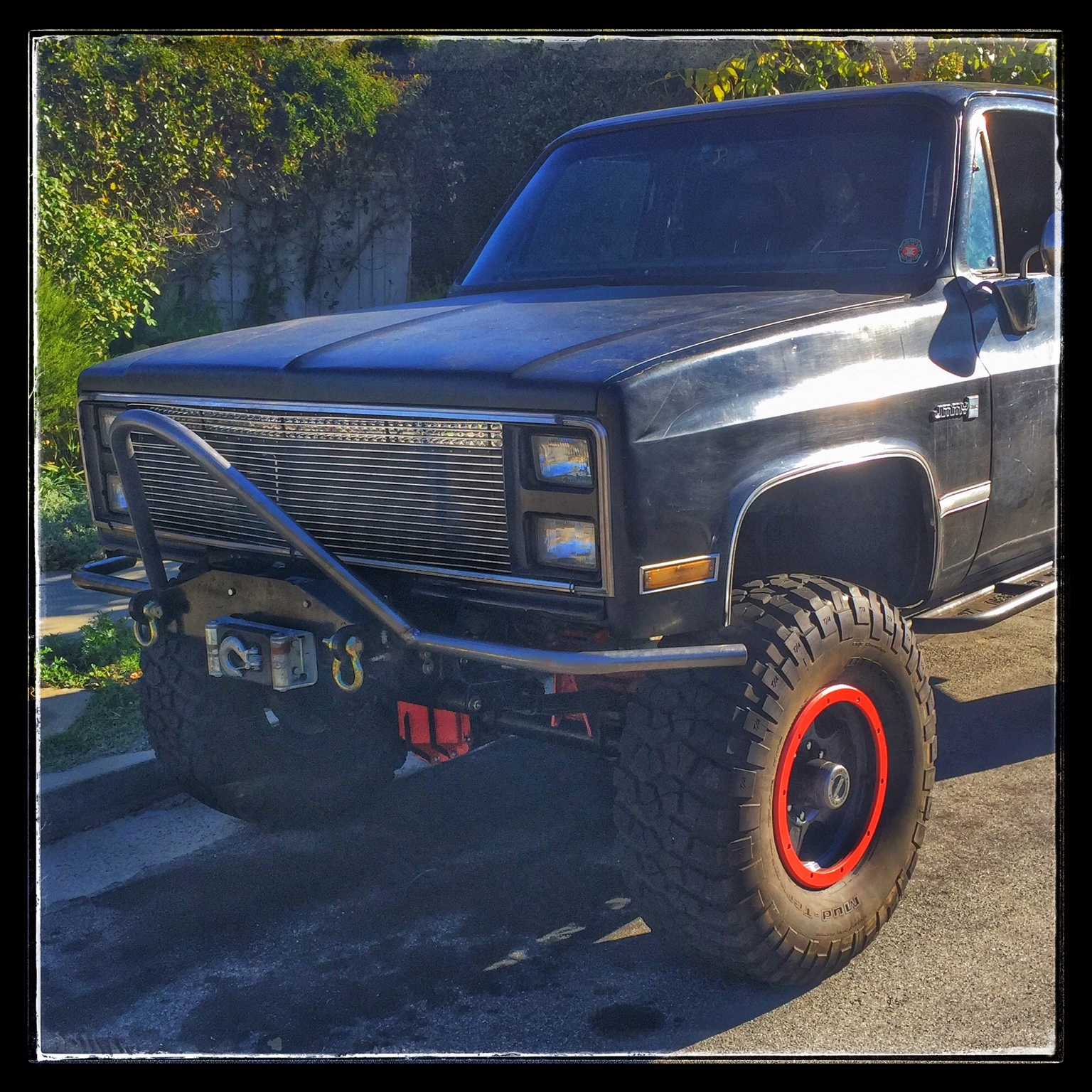

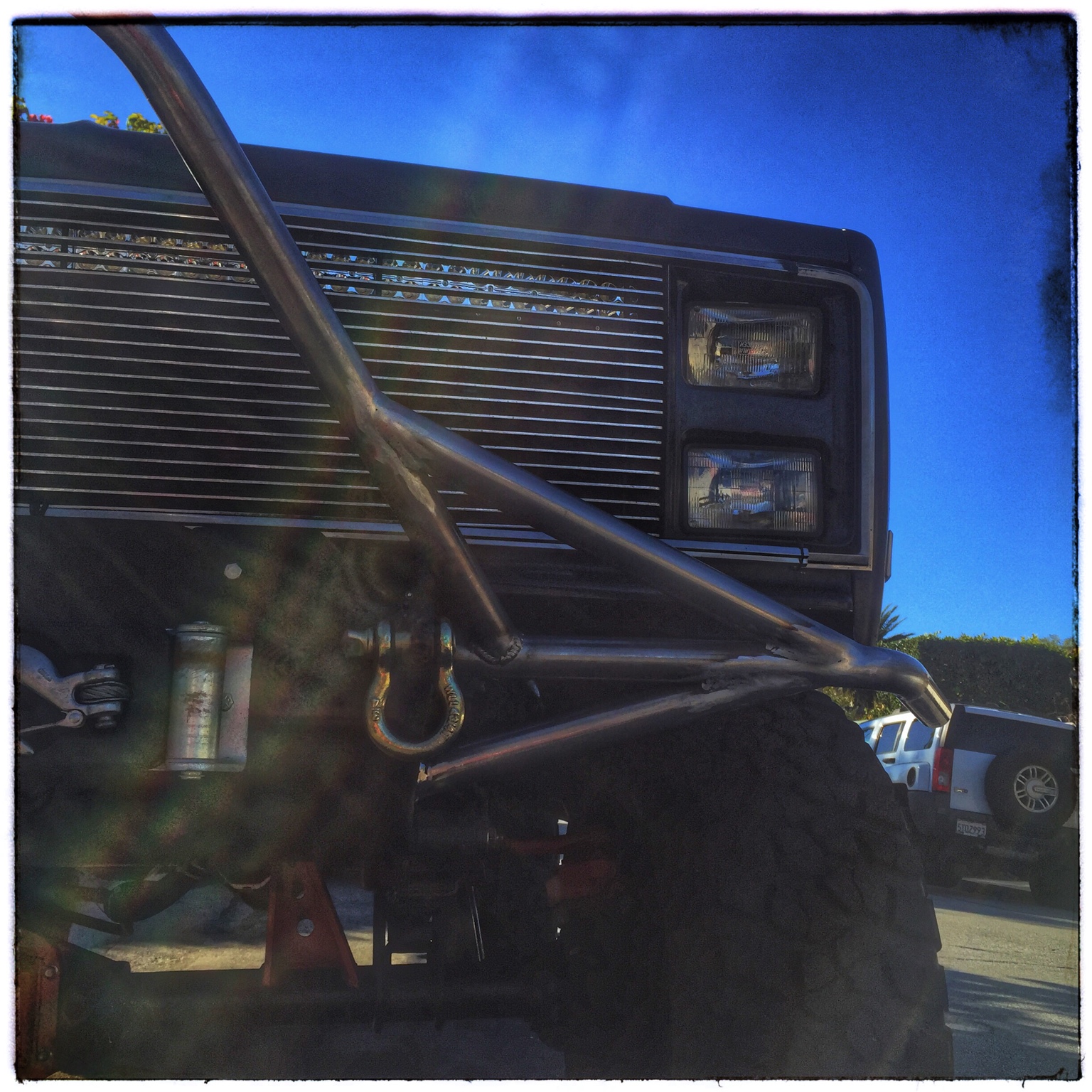

Last but not least, I have been working on a front bumper off the A-Bomb. Brain stormed with Kurt as to what would look best. He bent me up some tube, I welded it in place and cut and notched the support bars. One more to go. Spending a lot of time with the grinder. Ha Ha.
when my fuel pump died the other day, my buddy towed me home and used my stinger as the tow point. It didn't break off so I figure my booger welds are at least somewhat decent. Ha ha
I am planning on doing something along the lines of this on my A-bomb once I get all the sheet metal back on for a reference point.
Buy a factory fuel pump. Have had issues with non factory pumps.
Don't use stinger for towing. You have tow points.
Thanks dad. I wondered what those d rings were for. Wanted to test the stinger that is all.
