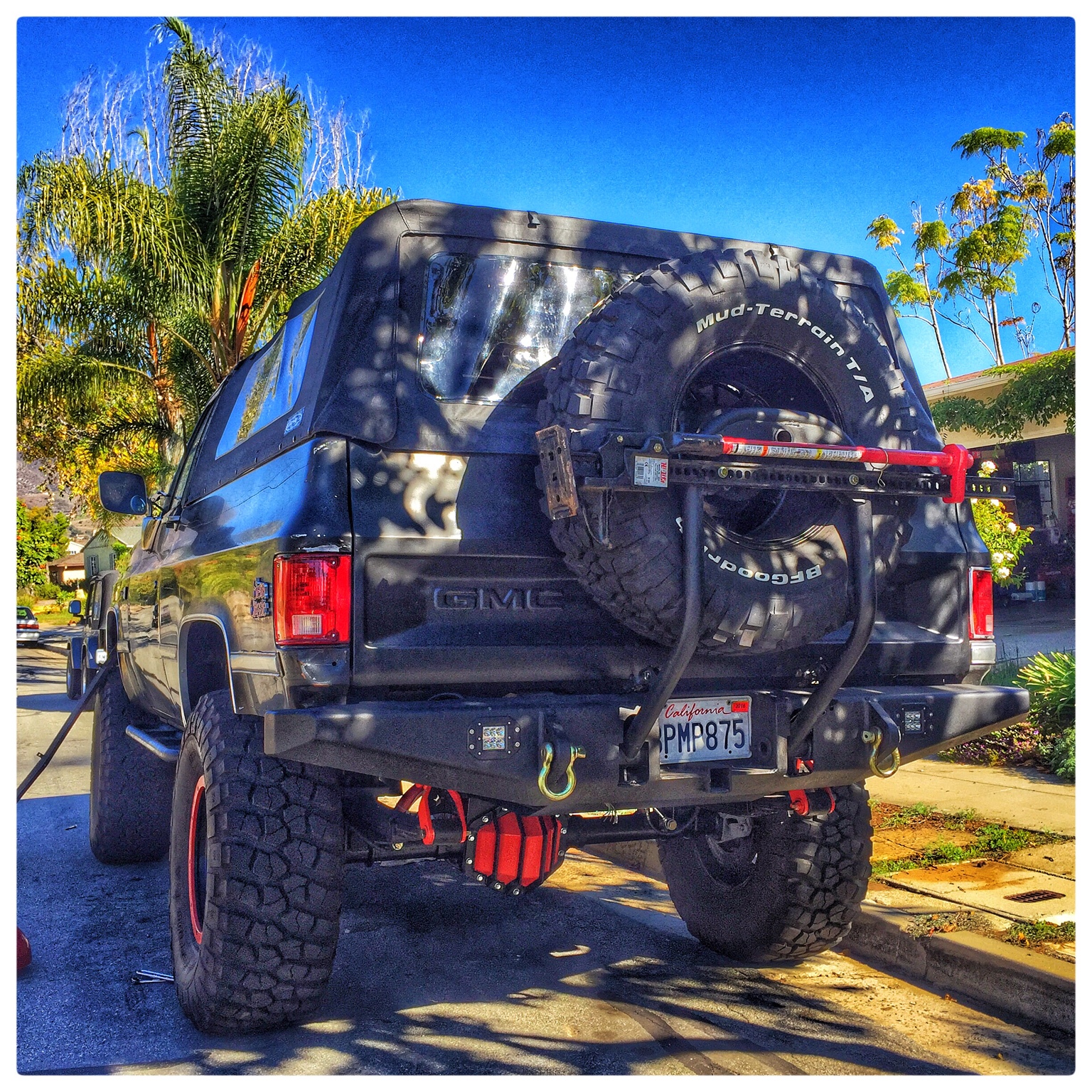

Was able to get all the little things buttoned up on the truck that had been driving me crazy recently. Finally got rid of the jenky trans cooler that was bagging around under the truck and moved my hi lift jack out back to the gauntlet bumper.

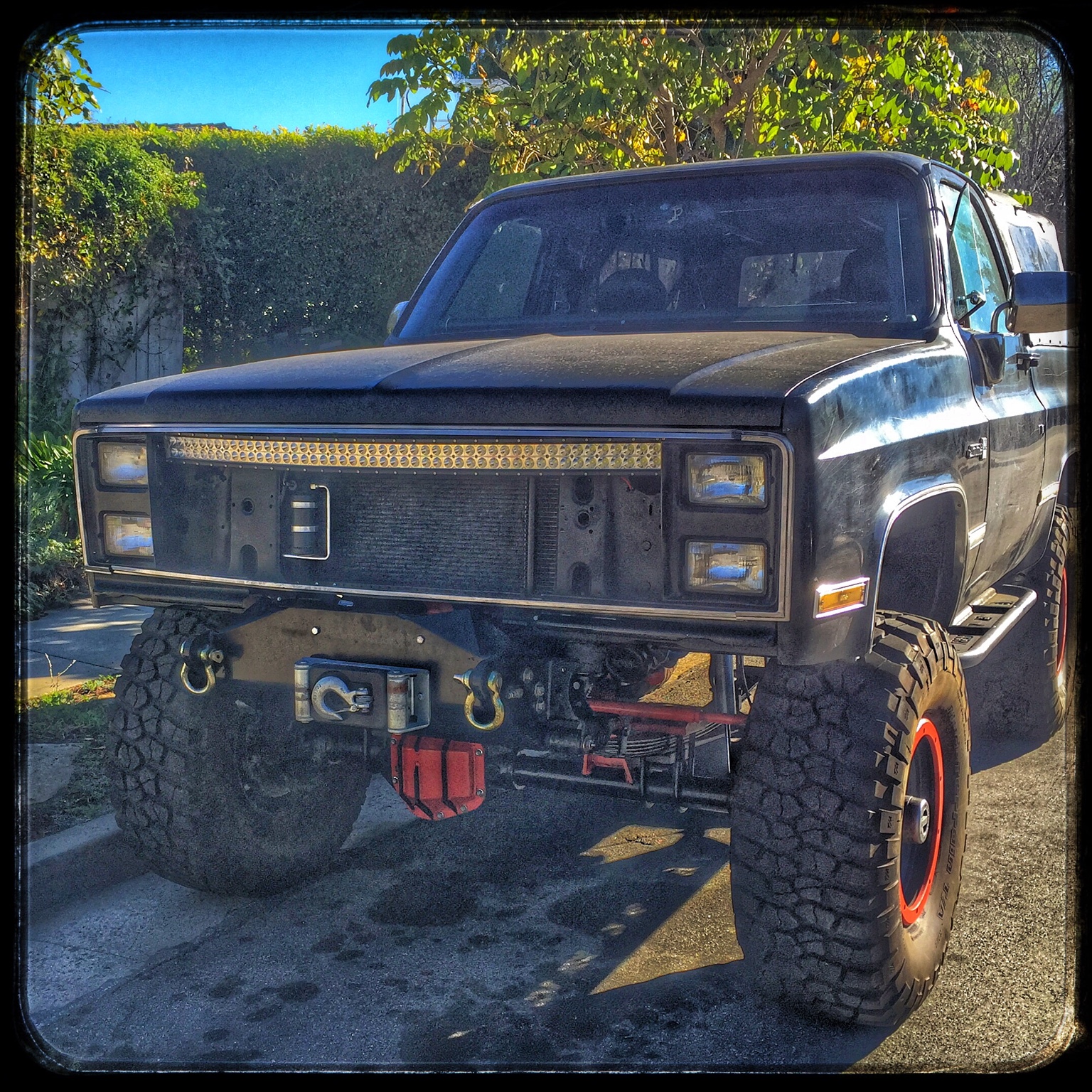

Also picked up a $100 light bar from Amazon. I can't understand how they make these things so cheap. Guess I will have to see how long it lasts. But for $100 can't really beat it.
I wanted to hide the bar as I am not a big fan of having them up high. They just seem a little too much for my taste.
I was stoked to get it to fit behind the grill. It was quite a bit of work but worth it imo.
Im digging the light bar placement. Let me know how it works at night and turned on.

The light bar is great. For $100 it can't be beat and it lights up the night like day. I will work on getting some night shots.

Yes! I'm glad someone did this.. Now I know one will fit behind my grill. Way to go man.. Looks awesome
It does fit. I got the 50 inch curved. The straight might be a better fit.

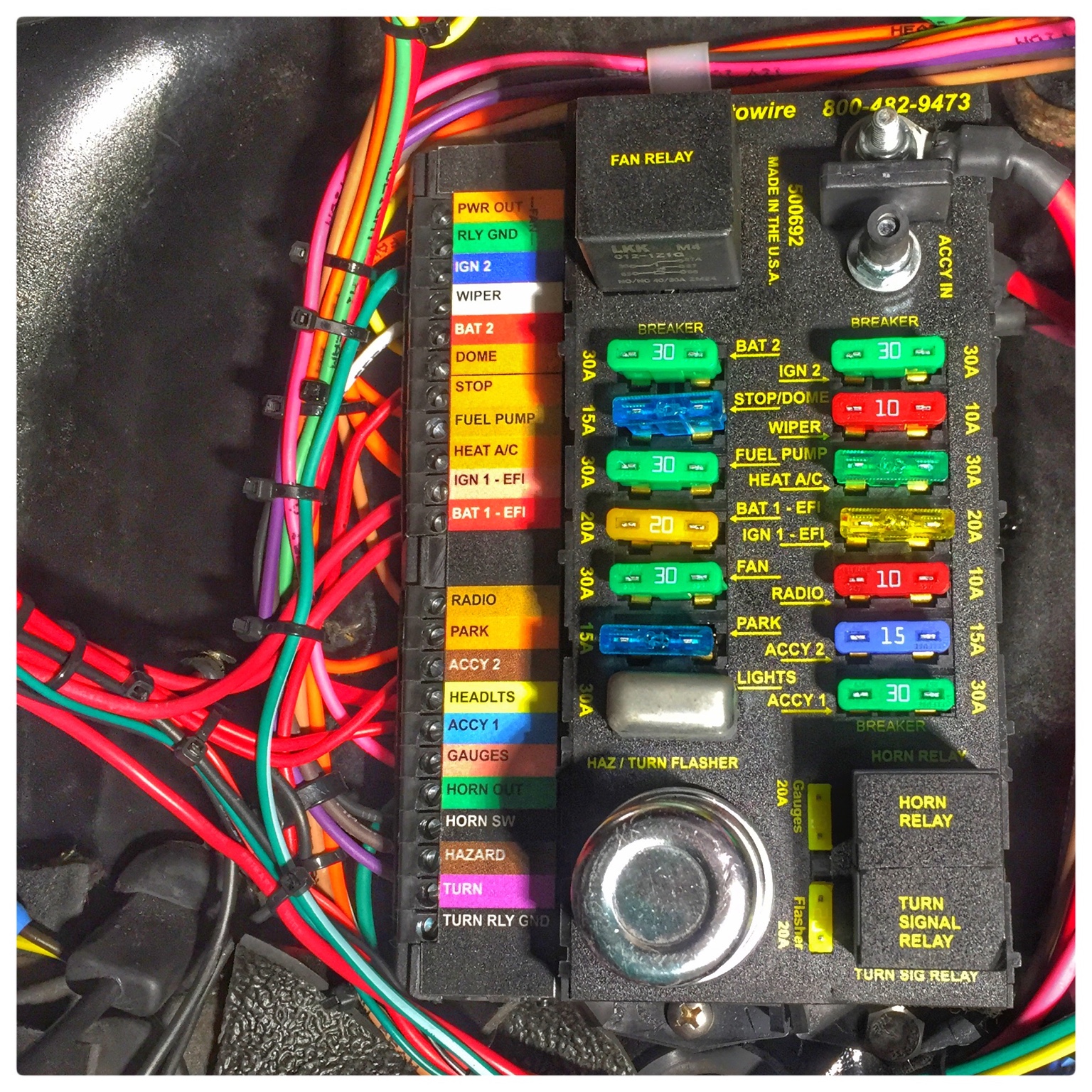

The wiring is starting to wrap up. Running out of channels on the fuse panel. This American autowire Kit was a great investment. I was pretty intimidated by the wiring of the truck but it has come together beautifully and I have a strong strong understanding of my trucks electrical now.
Here is the fuse panel
And my carling switches.
