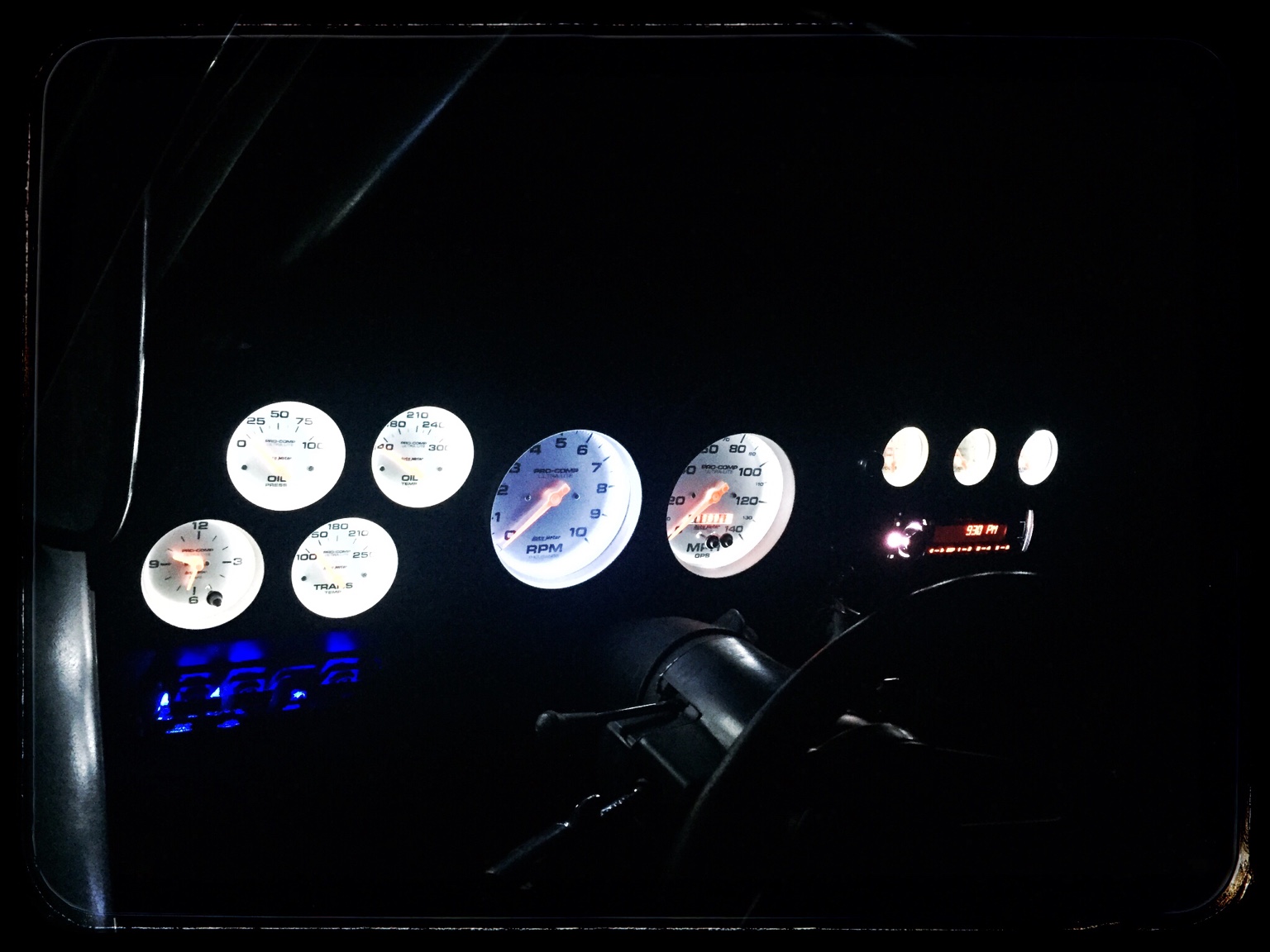

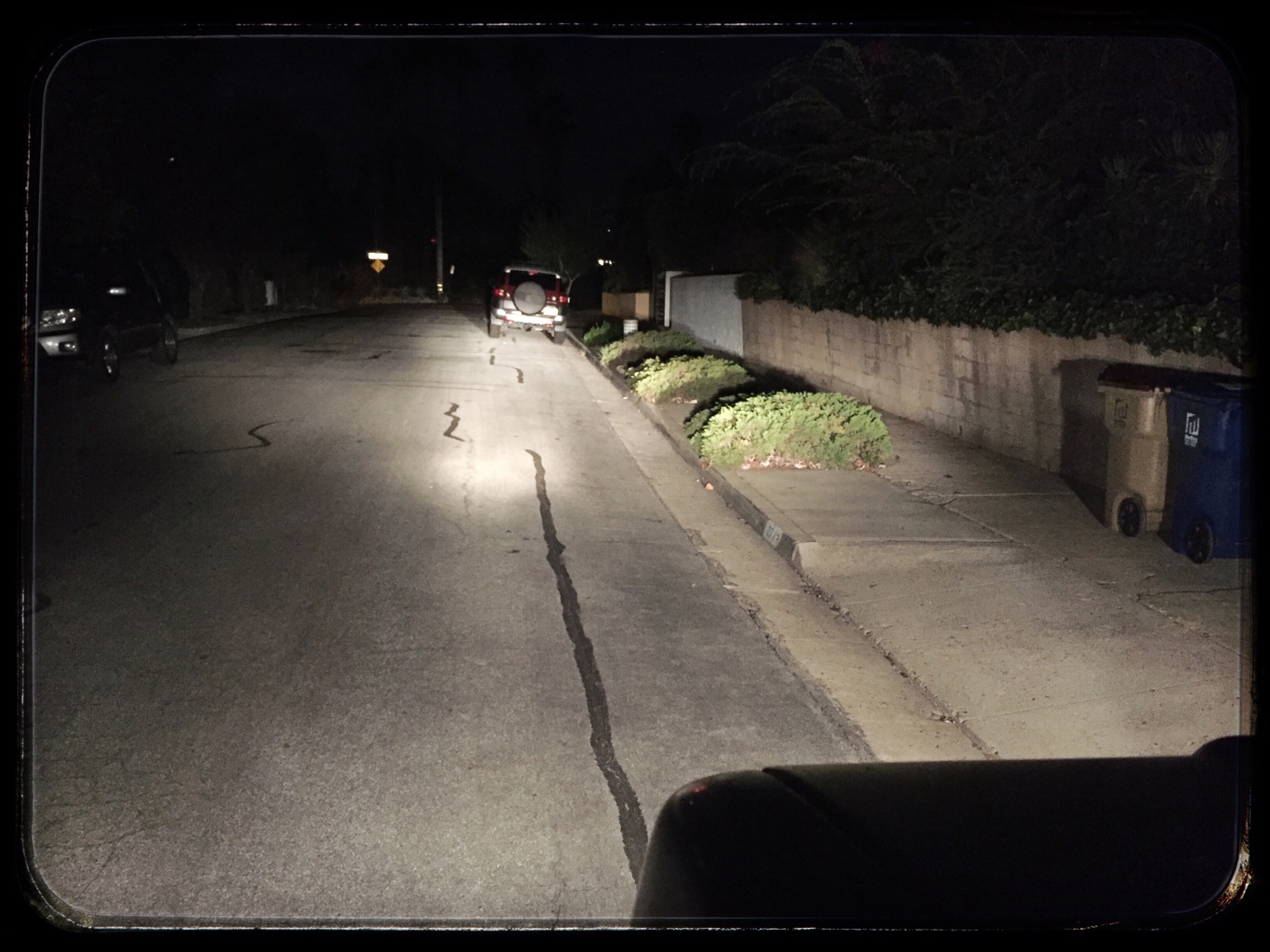

Got the headlights hooked up tonight with the lmc relay upgrade. Gotta say this is a pretty legit upgrade. I knew the factory system of lighting running power through the switch was ass backwards but the proof is illuminating. Ha ha
I am also enjoying doing minor things like setting my radio stations and choosing themes for the stereo colors. Ha ha. Beats removing transmissions and grinding rust.

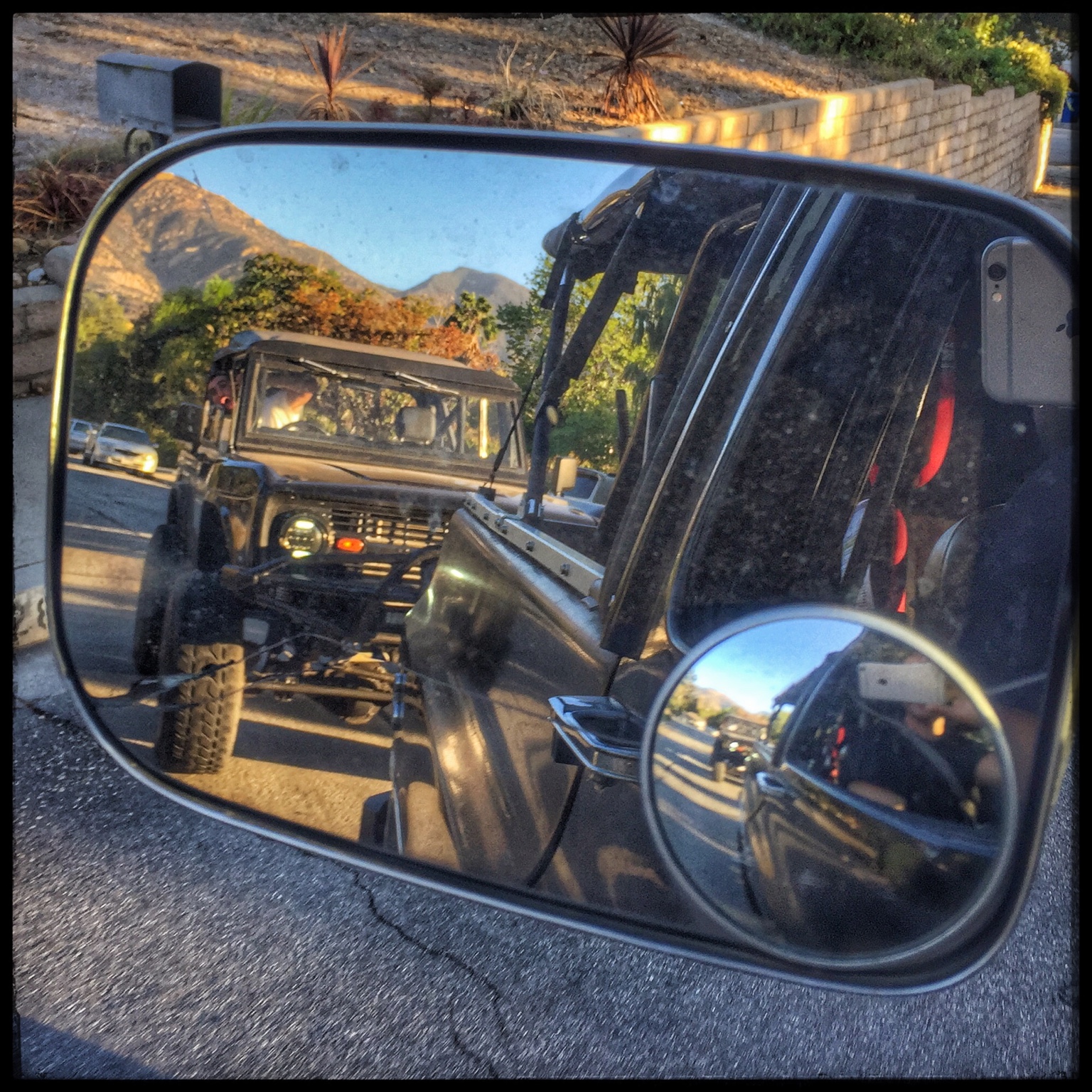

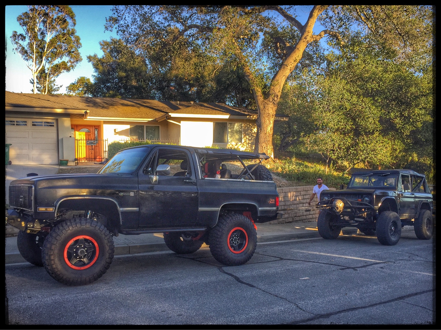

so, this is too good not to post. My buddy has a pretty sweet early Bronco. He also has two K5's that he is building, but the Bronco is his daily driver. Fully linked suspension, diesel motor, finished interior, full cage etc etc. Great truck.
That likes to eat transmissions. Clutches in particular. He called me when it left him stranded and I was more than happy to go help him out.
Can't believe I only finished this thing a week ago.
I kindly offered the services of my Chevy to tow his broken Ferd home.
I saw that Jeep on State St at the last car show. I had to look twice when I heard the diesel
