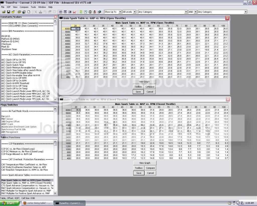

Here is what my current spark table looks like. It seems to have a few more degrees then Dave's table.
I guess it wont hurt to try Dave's.
